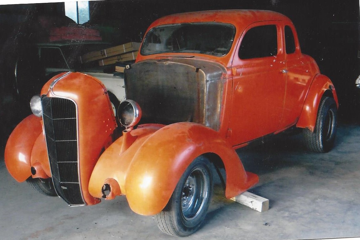

  4. stanlow69
    Joined: Feb 21, 2010
    Posts: 7,346
    stanlow69
    Need some motivation. Still has the original frame. Unchanged since the 70`s. Scan0565.jpg
