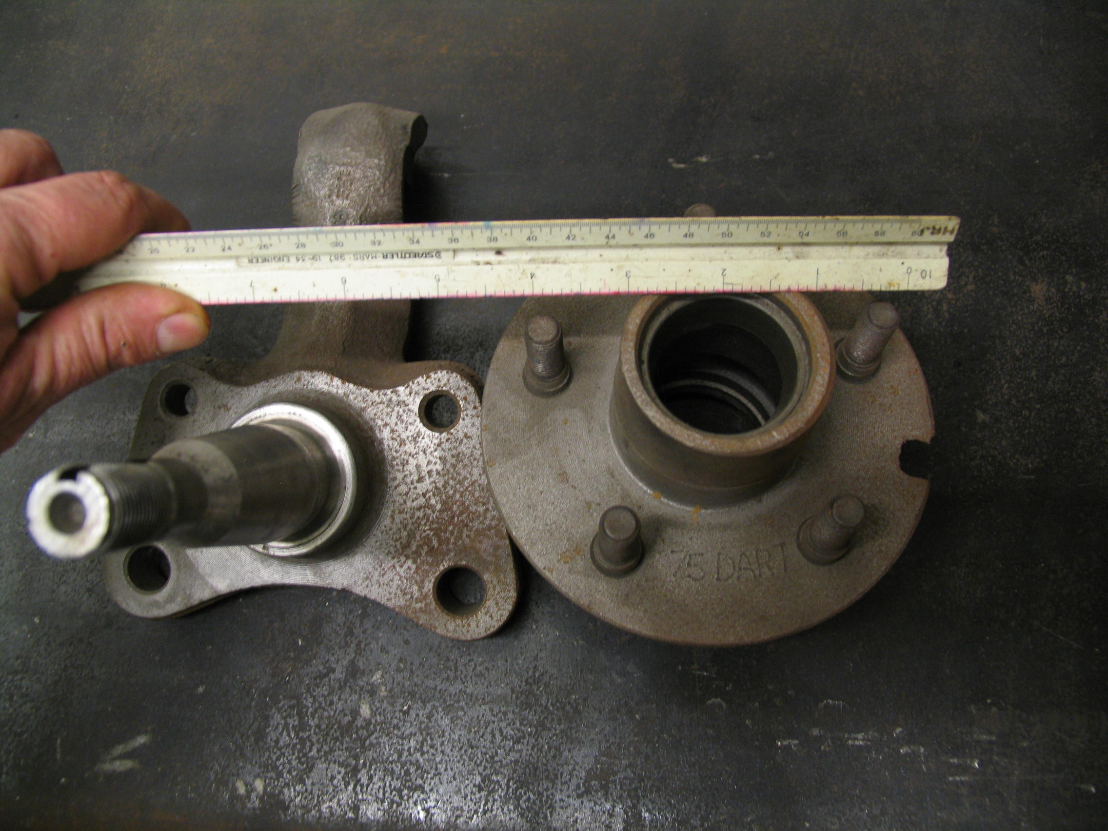

    Really? - how do you explain this? Note the info stamp on the hub (we put it there 3 years ago when we pulled it from a 75 Dart as a sample), along with the engineering scale showing a 5 on 4" bolt pattern (and the dinky pilot specific to Mopar SBP). Of course Hollander is wrong, as are my NAPA books showing 73-76 specific front wheel cylinders and front drums with separate part numbers from earlier years...

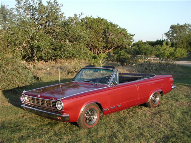

  14. From the factory my '65 Dodge Dart GT was 5 on 4 with 13" wheels. I installed a Master Power Brake disc brake kit on the front and had the rear axle flanges redrilled to 5 on 4.5. I then installed 14" Mopar rallye wheels from a '72 Satellite Sebring with Diamond Back redlines. Lowered the front slightly on Mopar Performance torsion bars which are a one-step upgrade from stock. Used 1" blocks to lower the rear. Result in attached photos.
  15. TexasDart
    Joined: Oct 11, 2007
    Posts: 853
    TexasDart
    Now that is a fine look car....:)
    Where in Texas are you located. We need to get our cars together...

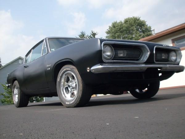

    here is a new update on mine i just put some new wheels on
    [​IMG][/IMG]
