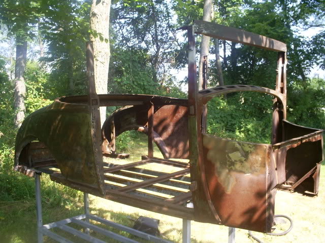

    So we made the trek out to South Bend, IN to meet up with Rpmrex and get the car body/rear end/parts along with checking out Notre Dame for the first time...and MAN...was it EVER cold!!!!
    I wanted to get some pics of us loading up the parts from his truck to mine, but I think we were both so friggin' cold that we just mentally said "f" it. We bounced when the cake was transferred and the parts were loaded. I wish there had been time and temperature available for us to chew the fat some more, but there's always the HAMB!
    Here's the truck all loaded up for the trip home:
    We made the trip home safely, and got the car parts unloaded into a friends garage space. Hopefully I'll be moving into a heated better part of his building in the coming weeks so I can really get down to business, inspecting every inch of it to work up a plan of attack. Rex said that the body originally came from TN...my homeland! I guess these things move in mysterious ways.
    Here's some pics of it set up in the temporary storage:
    After getting it home, I saw that the back p***enger quarter, along with some lower patch panels, have been welded on over the years, and you can see the light gray areas where some lead work had been done to clean it all up. I wish these parts could talk. It would be cool to see where they had been and what it had looked like when it was last a whole car.
    The rear end setup:
    Now that I can look at it more intensely, one thing that I'm focusing on is how the rear part of the body doesn't match up with the doors when closed and what to do about it. Actually, I noticed it before I purchased it via Rpmrex's pics....got no bones with it whatsoever....just turning the gears in my head to figure out the logistics of it all. I think part of it has to do with the doors not closing all the way, yet....there's a little knurled metal in that gap. Perhaps the rear of the body has also been warped a bit over time...not sure. Any ideas?
    Here's a few pics of what I'm talking about:
    I saw an ad in the cl***ifieds for a 30/31 with the what looks to be the same issue, must be common:
    http://www.jalopyjournal.com/forum/showthread.php?t=515200&highlight=body
    I REALLY want to thank Rpmrex for working with me on all this, for being so cool about it all, and for driving the parts over to the hotel! Too bad we didn't get to go over to 5 Guys Burgers and Fries afterwards! There's always next time :) Indiana was a blast.
    Onward and upward :)

    I was gald to meet you too. I was suprised to get all that stuff in such a small bed and tucked so low.
    I was always wondering why the doors didn't mach the curve of the rear section so well. I was figuring on tweaking/flexing the doors in as much as possible and cutting the forward crossmember and spreading the rear section a touch if needed but never started the project. I would try to find someone that has some doors that you could mount up to see how theirs fit the rear section.
    Something else that would work is attach a board or steel tube to the door top and a come-a-long or chain fall to the door bottoms and crank them in till they match the curve of the rear section.
    It's going to be great to see it come together on the HAMB. Often these projects get sold and ya never see them again. Keep us posted!

    The doors are not going to line up until the body is bolted down. If you have the original frame..bolt the body down and then try to line up the panels. One problem that I can see is your missing the front sub frame (quarter panel forward) and the piece that connects to the quarter panel right behind the door. (Pic below) Once you add the sub parts it should line up just like any other model a body/
