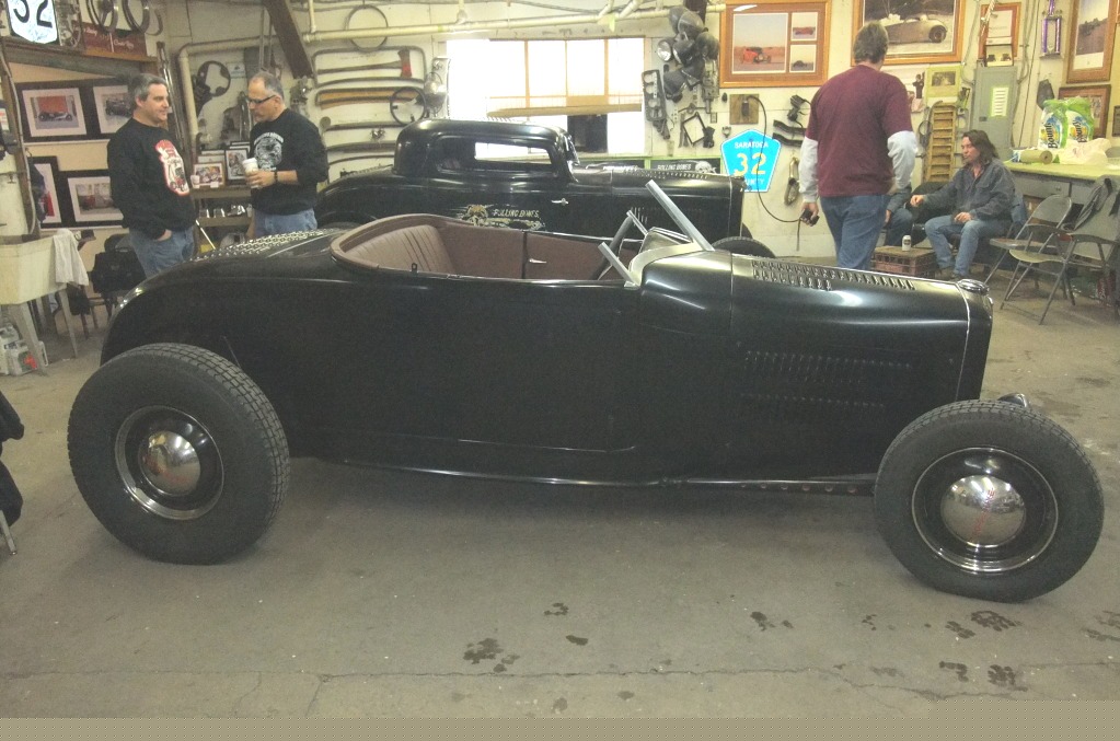

    OH, and I finally found pics of this finished A:
    It's pretty darn sweet IMO. However, I don't know if you could get that stance with the Brookville or JW style A frame w/32 rails.

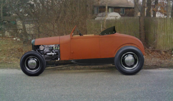

    I think I had a "come to Jesus" moment today while helping a fellow NJ HAMB'r, Lorodz, visualize his coupester that's REALLY coming together well. Here's the thread, and you can see the rapid fire visualizing between the two of us on or about page 3 or 4.
    http://www.jalopyjournal.com/forum/showthread.php?t=537213
    In the process, I was able to work in some ideas that had been bouncing around in my head for some time, and it also helped that we were kinda thinking variations of the same thing. I hadn't really considered the use of a top to help balance out the "coupester weirdness", but I think it works well. It's on an A frame, 4" drop in the front, unknown drop in the back (he never mentioned it); however, I'd probably put a 2" kickup in mine. Open sides, skirts designed to look similar to the reveal on a deuce frame. Anyway....after doing his, I modded it just a bit towards my inclinations.....and I think this addresses all of my design ideas. Thoughts?
    Without top...
    With top...
  19. poboyross
    Joined: Apr 29, 2009
    Posts: 2,142
    poboyross
    from West TN
    Addition....
    With the top folded:
    Similarities with the Lieb roadster:
    With the Lieb front end.....A grill surround (The flatter hood is more appealing to me than the taper you get with the 32...although I'm sure you could use an unchopped 32 grill and get the same effect:
    I think it's settled...I've had enough time to stew about all issues...economics, style, etc. This is what I'm going to roll with...
  20. Pat Pryor
    Joined: May 28, 2007
    Posts: 1,935
    Pat Pryor
    damn! i can picture it! and i was looking at his build today n thinking about your build. looks like the gears are turning. nice!

  23. Outback
    Joined: Mar 4, 2005
    Posts: 3,447
    Outback
    from NE Vic, Oz
    I'm glad that you've had that 'come to Jesus' moment I'm liking what I see,

  24. lorodz
    Joined: Jul 26, 2009
    Posts: 3,727
    lorodz
    im glad ( jesus ) i can help...lol.....nah it will come to you first get ya frame all mocked up after that put ya body on and than just look at tons of books and pictures. i took a little of each car i seen and added it to mine ..and of course mine is far from done ...its my 4th build so im sure ill add somemore stuff

    lorodz
    if you use a 32 grille like i did and dont chop it it will look like it nose is in the air i checked mine before i chopped it and it looked stupid in my oppinon.
    Posts: 2,142
    poboyross
    from West TN
    I agree on all points. I think that I might go for a painted A grill surround just like the Lieb roadster. I *really* like the look of the 32s, but for some reason, the A surround is calling to me. Once I saw that roadster and the build over on whatever hot rod site it was on, I thought "this IS the ticket". However, it'll be on MUCH more of a budget. I think the Lieb roadster was pretty much unlimited! I think Shine did it, didn't he?
