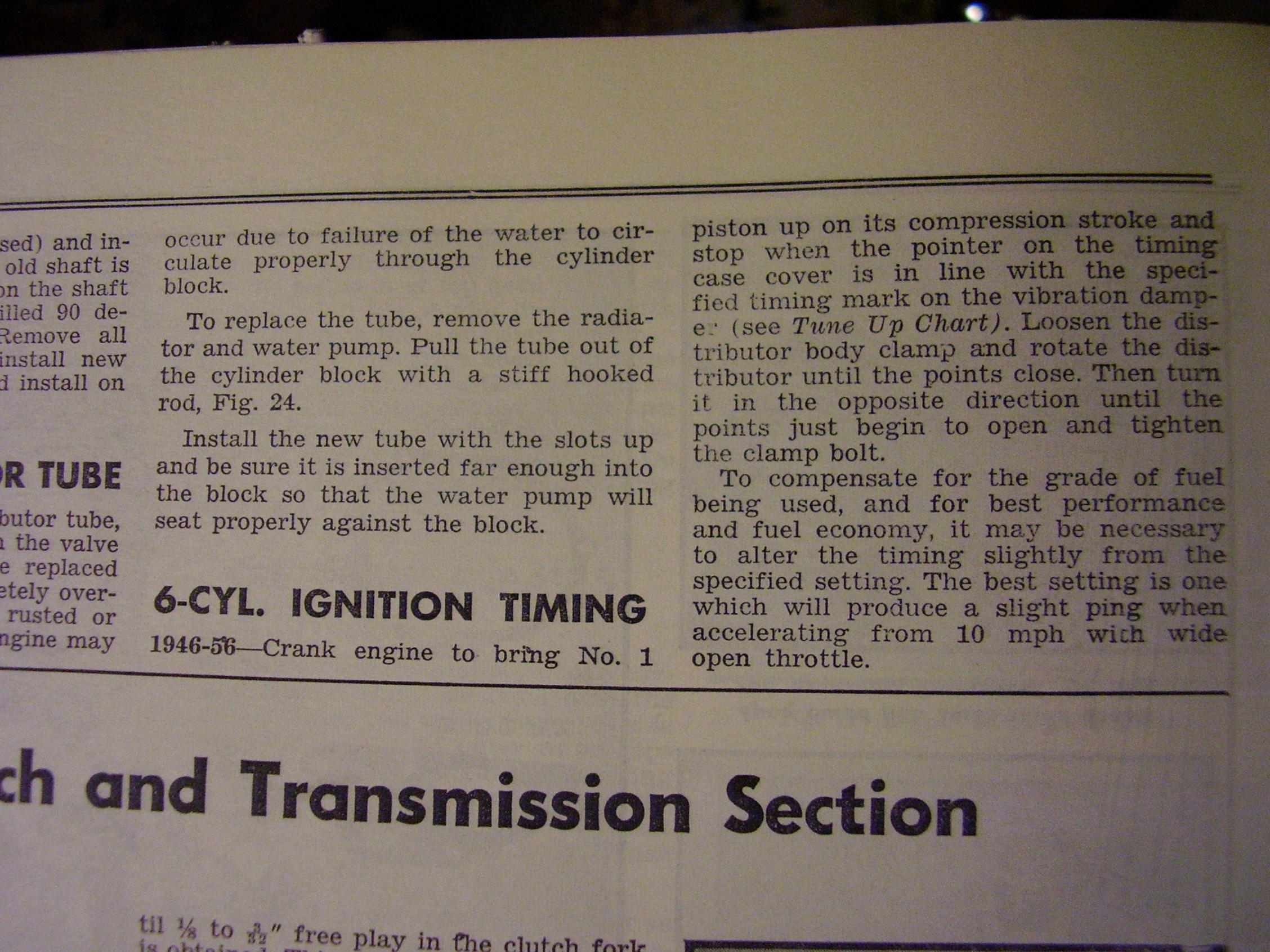

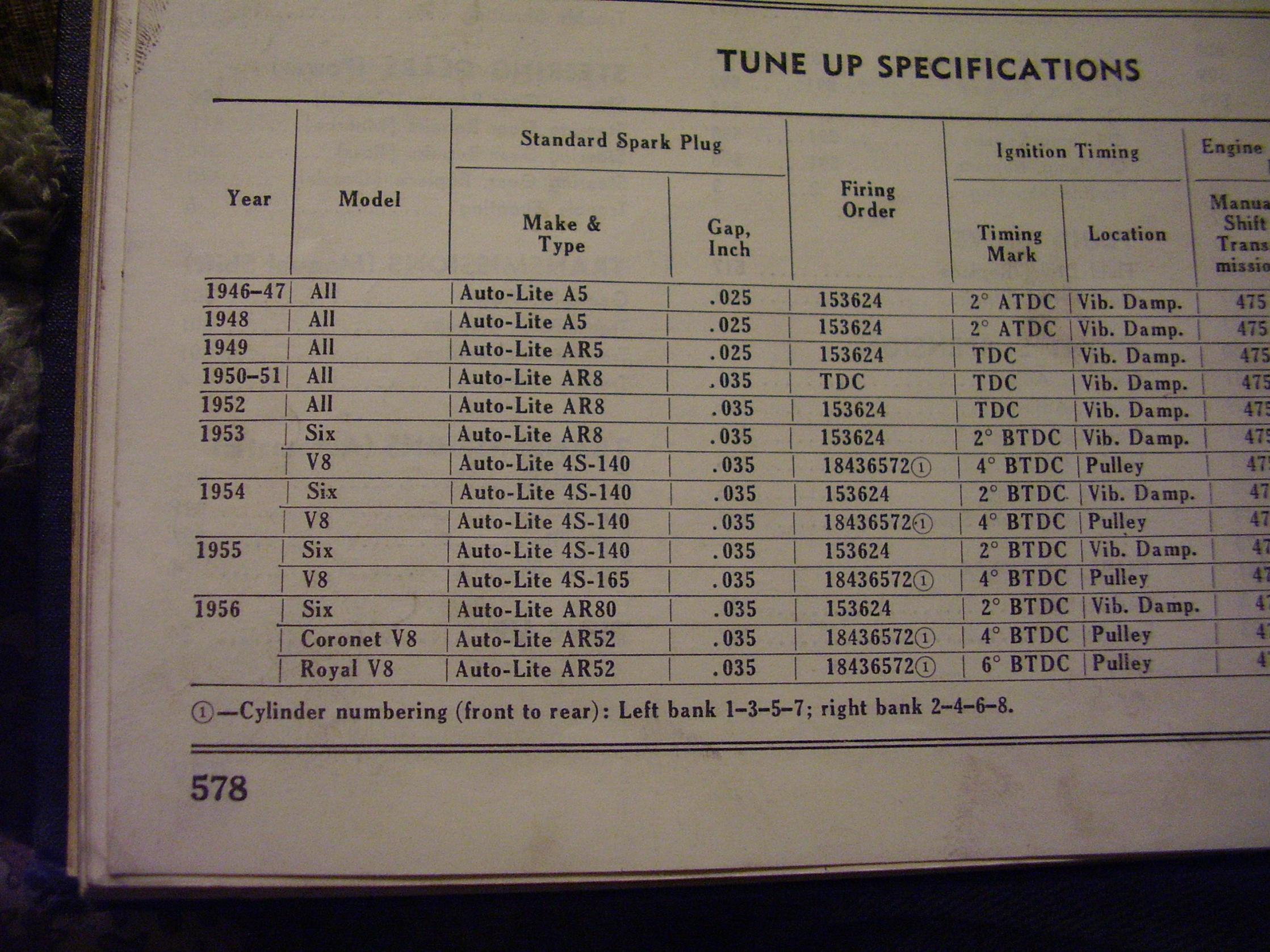

    Taken from Motor's Auto Repair Manual
    Never tuned up a 53 Dodge 6, but this is a strange way to set your timing.................
    The book only shows Dwell Method for a V8 and I did not know they had duel points............

    A way to set timing - basic:
    Turn engine over by hand until timing marks line up where you want them. Hook a test light up between the negative terminal of your battery and the wire from the distributer to coil. ( unhook at coil ) Turn distributer clockwise until light comes on, then back off counter-clockwise until light just goes out. Re-tighten your distributer hold down bolt and you've got pretty decent timing.
    This is for positive ground system, after your points are gapped and the dwell is set.
  12. This is the way to set basic timing on any engine. the test light method above is similar to the buzzer used to set magneto timing. It makes sense...we have to start somewhere to get it running. Even breakerless ignitons can be set this way using a voltemeter.
