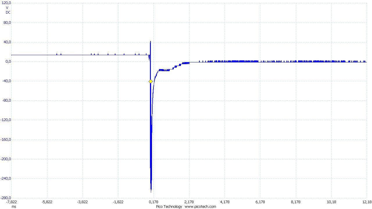

    When the current through the coil primary is interrupted (by points opening, for example) the collapsing magnetic field in the coil will attempt to keep the current flowing. If current can't flow, the voltage instead goes up - ignition coils can easily reach several hundred volts on the primary side.
    As the points opened a fraction of a second ago the opening is very small, and it only takes a relatively low voltage to jump a small gap. So, a spark jumps the points opening, some current flows through the spark, and the energy in the coil bleeds of pushing current through the spark on the points. We don't want that, as we won't get a good high voltage spark from the secondary winding.
    If we add a small capacitor parallell to the points the situation changes. The points open, and for a fraction of a second a small current from the coil charges the capacitor. This delays the voltage rise, not much but just enough to let the points open further, so when the voltage has risen enough to make a spark at the points the points have opened too far - the voltage isn't high enough now. This means we don't waste the energy in the coil pushing current past the slightly open points, all the energy goes into creating a higher voltage pulse in the primary winding, which in turn makes a nice high voltage pulse in the secondary winding.
    The size of the capacitor does matter, if it's too small the voltage may rise too fast, if it's too large energy will be wasted charging the capacitor instead of producing sparks where we want them, basically the size needs to be tuned in combination with the coils properties. And that's where I stop trying to explain how it works in a way anyone can understand, because I don't have a good grip on that kind of black magic.
    I'll throw in an oscilloscope waveform of the voltage pulse when the current to the coil in a simple 12V relay was turned off. It peaks at around -270V, and that's probably limited by sparks in the switch used to switch it off - a small capacitor could probably have bumped that up even higher. Anything with a coil can be quite mean to whatever interrupts the current through it...
    MoePower, pitman, 38Chevy454 and 9 others like this.

    I think the required capacitance has more to do with damping the LC oscillations in a way that the arc at the points is minimized...it doesn't have much to do with the RPM you are running. Keep in mind that coils have both resistance and inductance, and the inductance is what applies to AC situations like this. Inductance is measured in Henrys...not Ohms....

    Would it not be possible to measure current past the points with a storage oscilloscope, to determine what size capacitor gives the cleanest interruption, i.e. the least amount of spark on the points? I'm thinking that would get you pretty far along the way of getting the least points wear.
    loudbang, kadillackid and squirrel like this.

    Agreed. The capacitor is there to "manage" what happens every time the points open, and that's basically the same every time, no matter if it's at idle or howling at 7000rpm. Well, the coil may not have had enough time to reach saturation current at high rpm so there's a little less current and energy to deal with, but the capacitor/coil has the same resonance frequency no matter the current or voltage.
