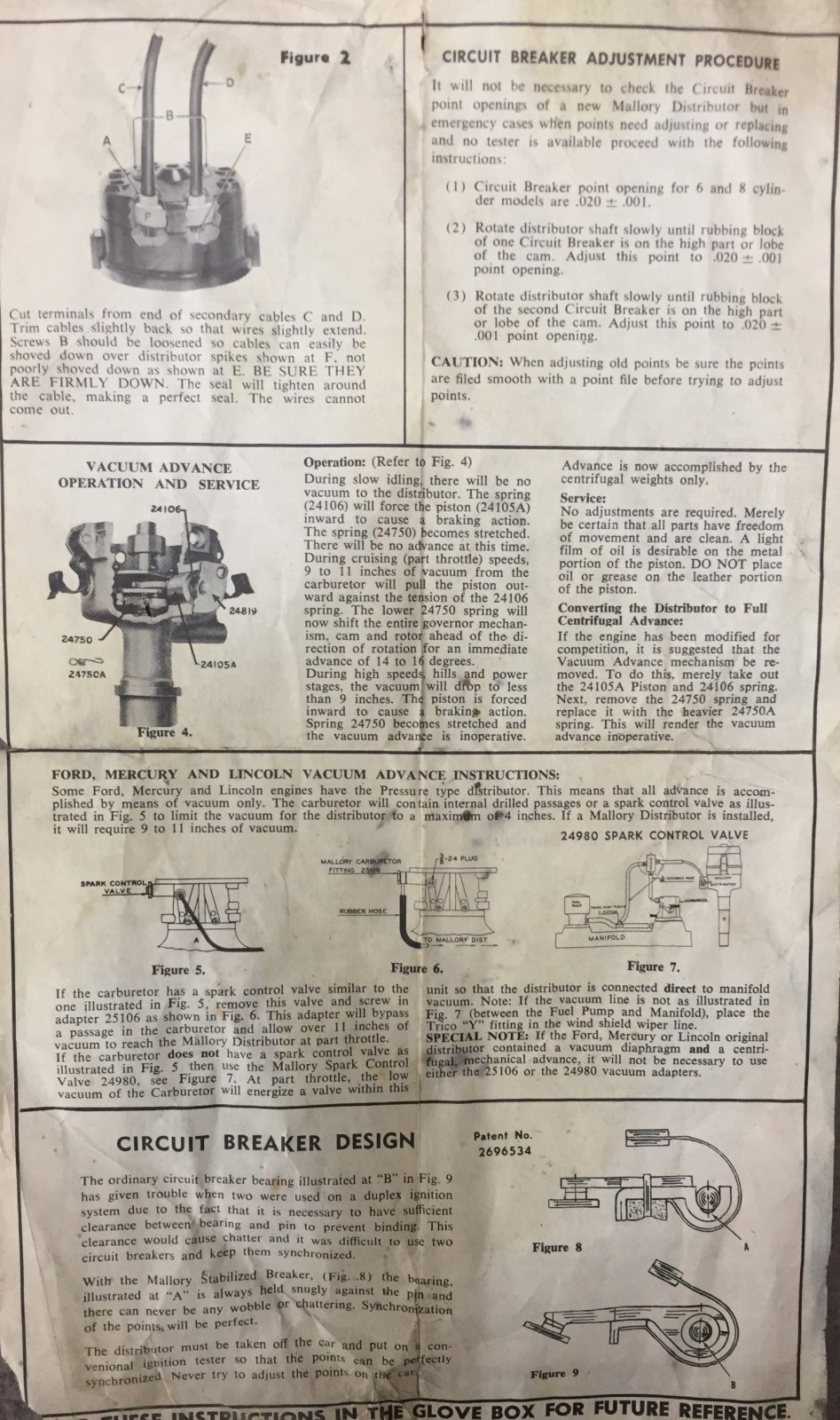

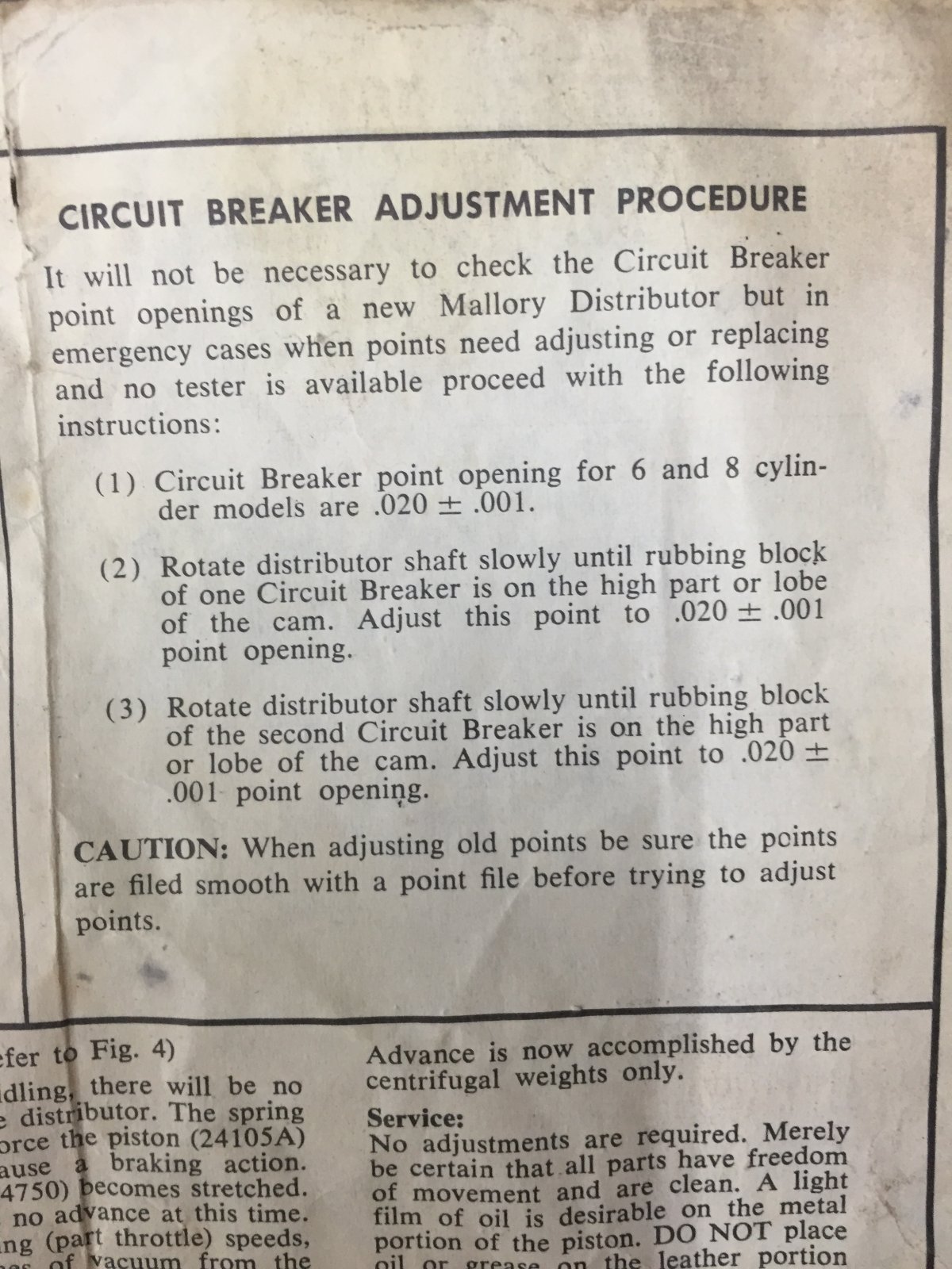

    Here’s an instruction sheet. Shows .020 point gap. There is also instructions for setting dwell , sorry about the blue overspray
    61962FF2-3747-4826-9F54-FEDC3C06AFBA.jpeg 07B7977A-236D-416D-8B0B-5891BE430B17.jpeg F45EEADD-2F84-42A7-A6C9-1F37C1930A2F.jpeg 48299F86-4930-4989-AFC8-410BFF4A8B11.jpeg
