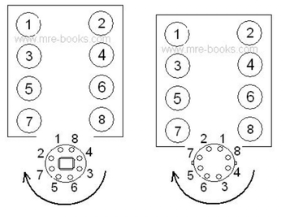

    HEI #1 plug wire left image.
    Points #1 plug wire right image.

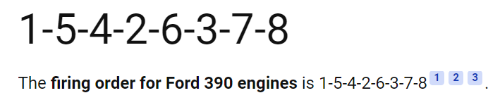

    That firing order is correct is you're talking about those gaudy orange engines. However, if you're talking about Fords, the correct firing order is:

    I was ***uming GM V8 , HEI ,
    & is there more firing orders for the
    FoMoCo V8s then 2 ?

    Maybe for the 390, but some 302 Fords have one firing order while other ones have a different firing order, to relieve some stress on the front main bearing (#1 and #5 in the Ford schema).
    The firing order for the early 221-302 engines and the early 5.0 engines is 1-5-4-2-6-3-7-8. This is the firing order for all prefix “31” cams and is the standard replacement cam for all early engines. The later 5.0 engine and all 351 engines are designed to use the 1-3-7-2-6-5-4-8 firing order.

    Actually it’s so 2 1 wire and 3 6 wire will clear one another. 90* HEI boots are limited to the position they can be turned.

    I think you got the picture description's mixed up in your first post Johnny.

    I cought that I got it backwards on this mornings posting. I fixed it, again!

    Elgupo37, Johnny Gee gave you the correct answer. The firing order is actually the same but it is normal to move the number one wire to the location it shows on the cap in the diagram he posted. It's still 1-8-4-3 6-5 7-2 with the rotor turning in a clockwise rotation.
