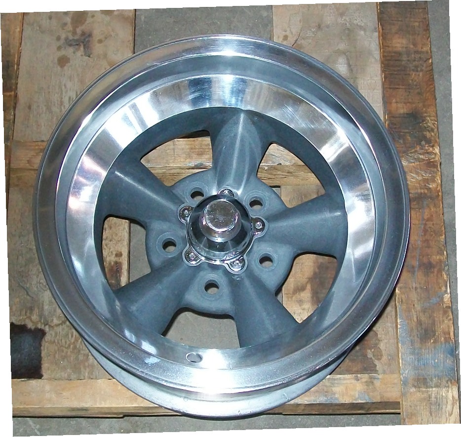

    A fixture with a motor to slowly turn the wheel is going to happen. I'm thinking a potter's wheel arrangement driven by a gear reduction. The wheel turns, all you do is work the compound in.
    At least that's what I'm thinking about while I'm rubbing. Let's see your wheels.
    Shown here needing elbow grease.
