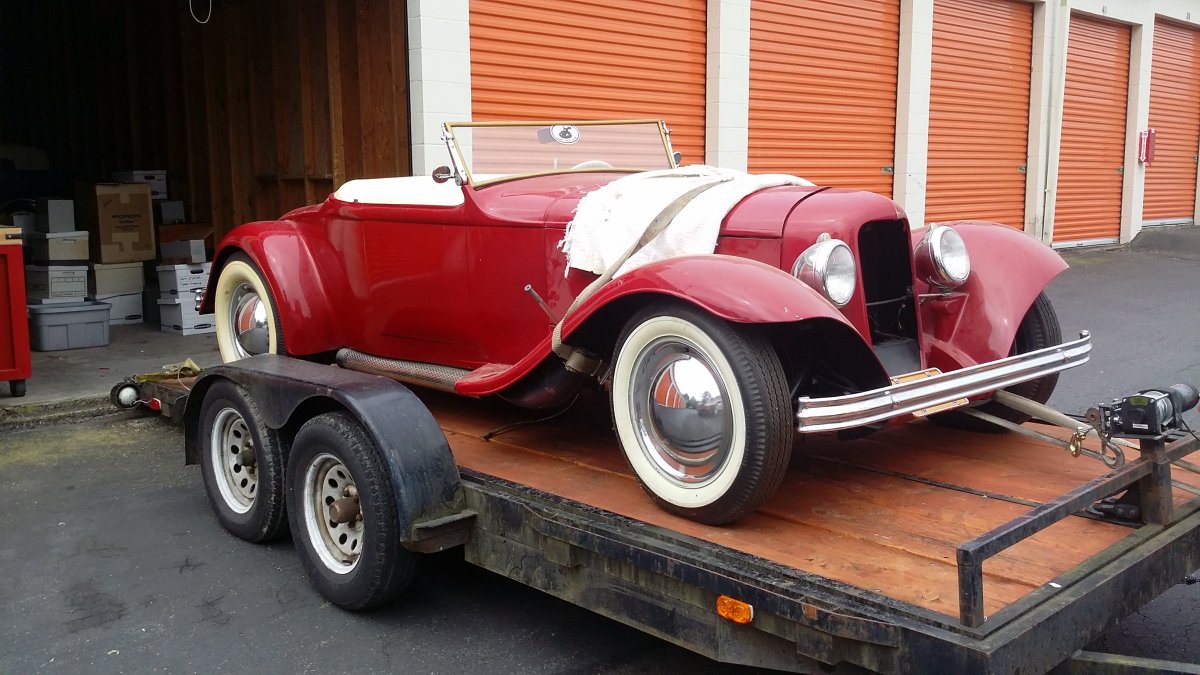

    I was the lucky one to purchase this roadster built in 1956. I got most of the parts and have started the restoration as close as possible to the 1956 configuration. 20170610_200233.jpg 20170603_113101.jpg

    Thanks for sharing that @pars55...What a time capsule. It looks well cared for...Such a great start to a very special Hotrod. Really like what your up to and congratulations on your acquisition...have fun and look forward to your sharing the adventure.

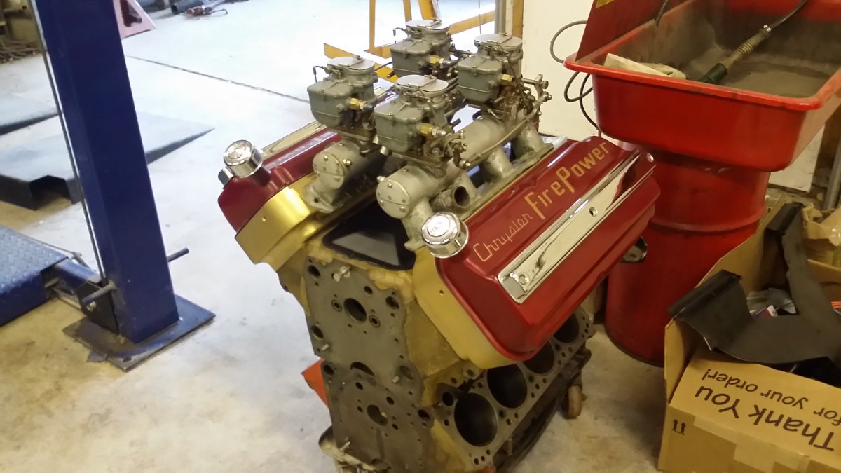

    Irving Poling was an engineer and helped with the original moon landing! The car was built in California while he was in college. Last shown in 79 in California....Trying to learn The Hamb! 1498452653504.jpg 20170625_160547.jpg

    In the pic above of the Carb setup that is some serious linkage. What do the flat plates on top of the carbs do? Looks like they move, some sort of choke plates?
    Looking forward to your progress getting it back up and running

    In studying the carbs today , what a lot of effort! The 97s were fabed and split down the middle, yes the butterflies separated, 4 idle mixture screws etc....see pics. He bought a 1956 Herbert roller racing cam and tried to make it run good on the street.also all progressive even the top air blocks! Split both u fab manifolds....I am going back to 97s with mild cam..
