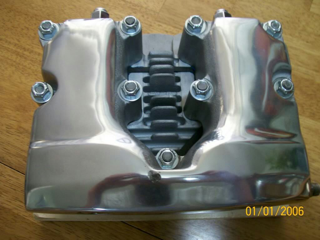

  6. I have used WENOL on these wheels and valve covers for 17 years......apply once a year and they stay great. Neither have a coating of any sort.....just WENOL polish. DSCN0590.JPG

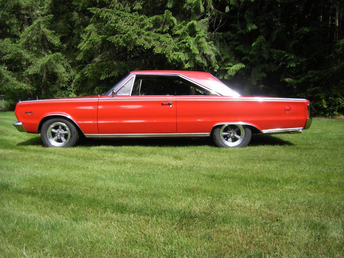

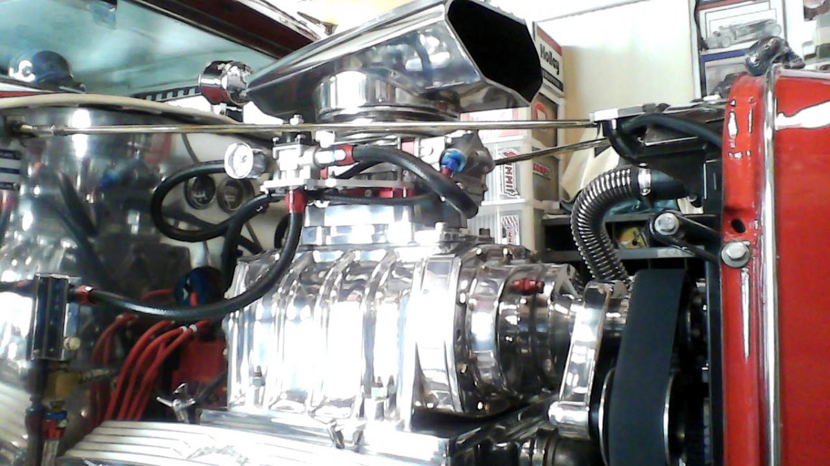

    I use a product called Shark Hide sold by Eastwood. I used it on all the aluminum, polished, on my off topic car over 7 years ago and everything still still looks as good as the day I polished it. I even used it on my wheels and have never waxed or had to polish anything on the car. Google it and read the whole web site about it uses. STH72713.JPG
