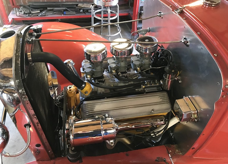

    My arm is about to fall off. Still the swirls keep moving around and so do the fingerprints. I have used microfiber towels only and a lot of Mothers also 3M rubbing compound and polish. I cannot seem to get it right. Would really love it if my firewall was like a mirror finish. Does anyone know the answer to this puzzle???

    I guess I didnt have the guts to use sand paper 1500 then 2000...it seems like that would cause real problems.

    To get a true mirror finish you are going to need to use power tools, to do it by hand will be a challenge. However the finer you sand it the easier it’ll be to make shiny. Flat surfaces are the hardest to get to look even. If you are committed to doing it by hand keep sanding up to 3-5000 grit. It’ll basically be most of the way there already.

    I had a panel like that on my PU, the air deflector over the grille. The polished SS was hard to maintain. Solution? I engine turned it. Pull that firewall out and lay it on the floor or a big work table, get a drill base, use a 1" medium cratex. The engine turning doesn't show fingerprints, swirls, easy clean up, looks cool. Lot of work but it is one and done. Cry once.

    Get a proper buff that you can use in something like a drill or angle grinder and some aluminum rouge compound. Will speed things up tremendouly.

    I suggest pulling the panel, it looks like it would be an easy task. Block sand it to 2000 in a horizontal position and buff it using your metal polish of choice. I think it would be easier to polish and definitely give you the best results.
