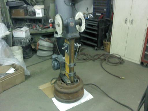

    I'd say both types have their place depending on the job at hand.
    I have several air buffs I switch between on my 8" grinder at home where I usually do smaller aluminum stuff & stainless hardware.
    I put both an air and spiral sewn wheel on the big s**** pile built buffer. More aggressive wheel and compound to start and the other to finish.
    I used another friend's buffer with only spiral sewn wheels on the caps & rings for my '35 and it worked well. Of course this was just a "tune-up" as they were originally polished when Henry made them.
    Long time back we tried gluing abrasive to sisal wheels for roughing stuff; but decided flap wheels or cartridge rolls on die grinder worked better for us. A DA is pretty handy too depending on the shape.
