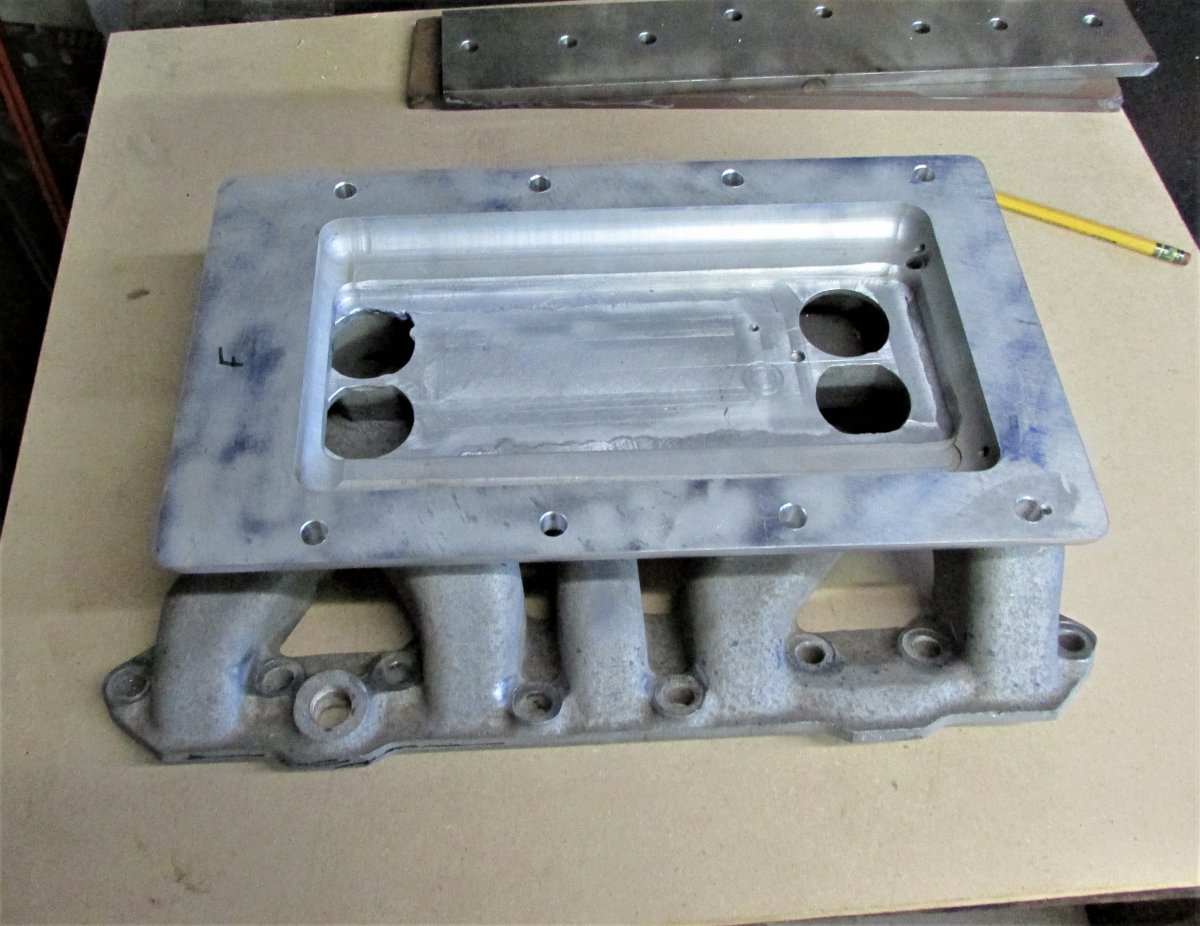

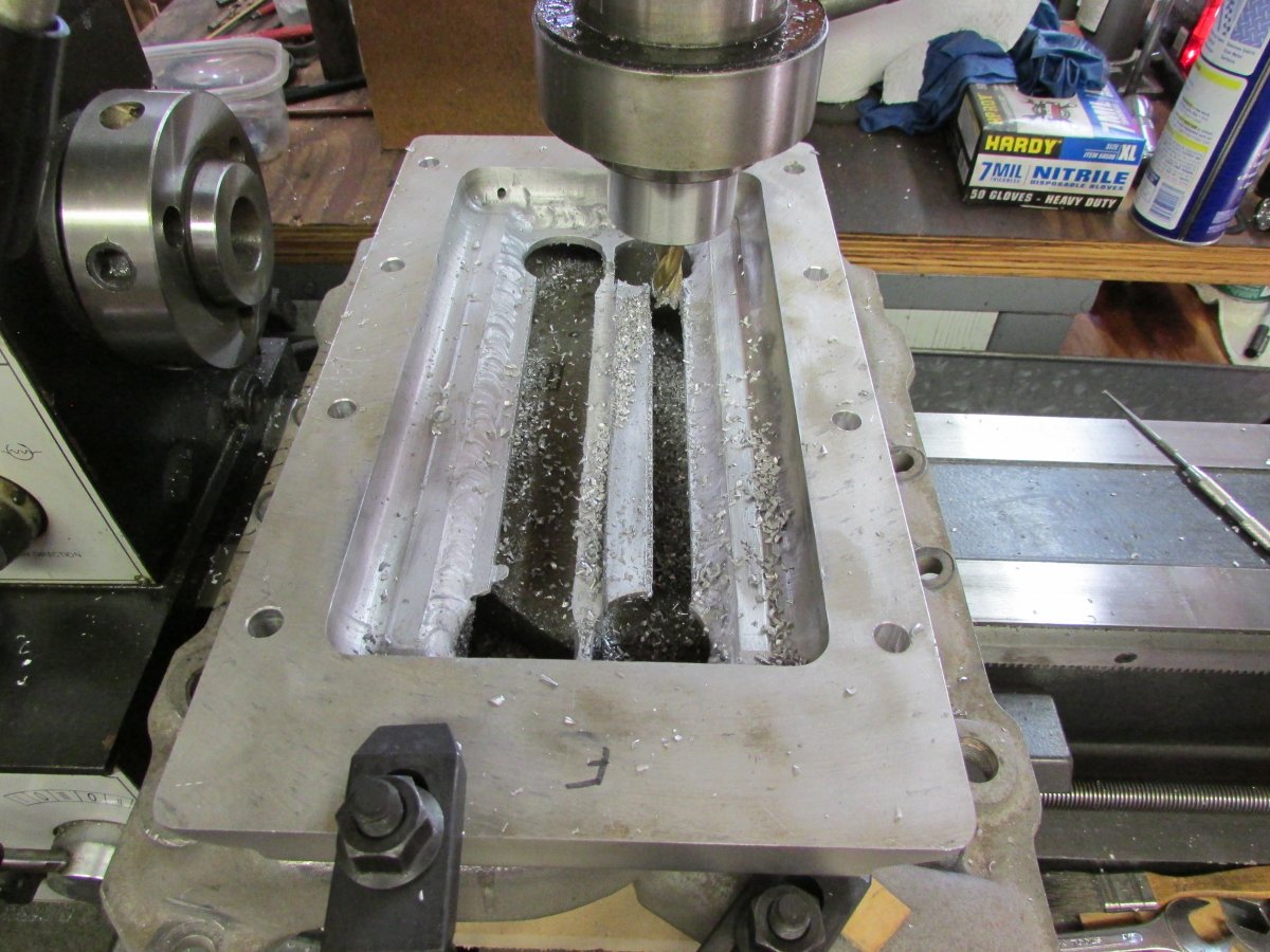

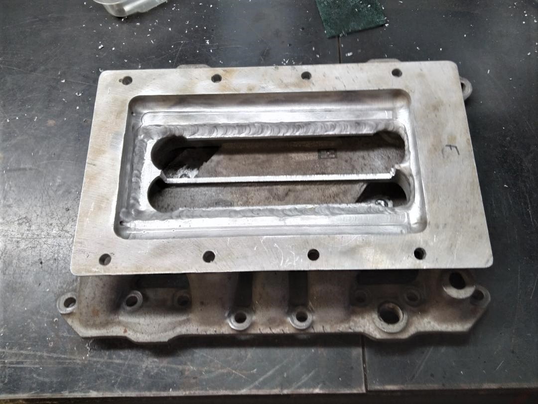

    Update Boys,.... I am still alive,..... just slow!
    After a lot of ****in around and procrastinatin, the manifold and adapter are now one piece, machined and off to the powder coater. Color to match the basic engine color. Next pics in about a week.

    Did you remember to fly-cut the supercharger mounting surface after welding? Interestingly, even with that being done, it's often a surprise to run an indicator on the mounting surface AFTER the manifold is bolted down.
