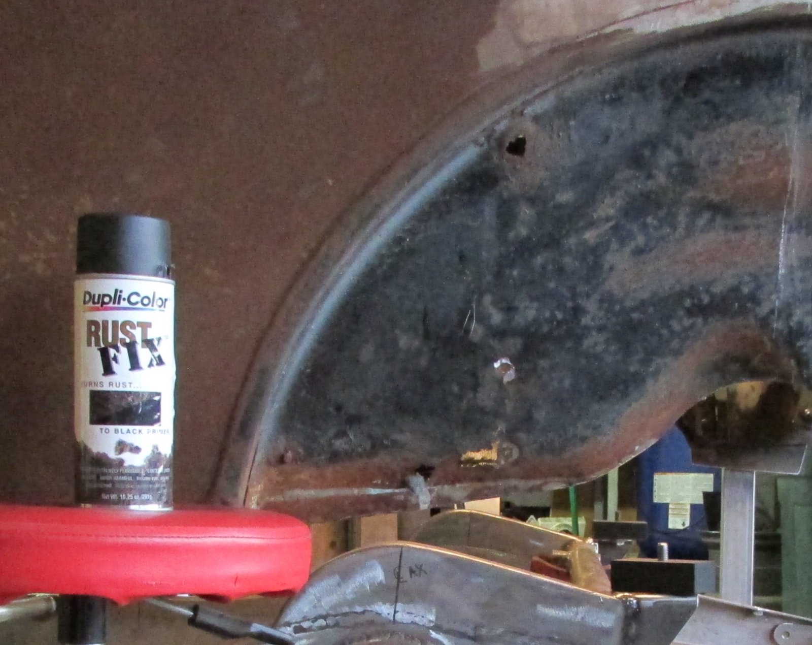

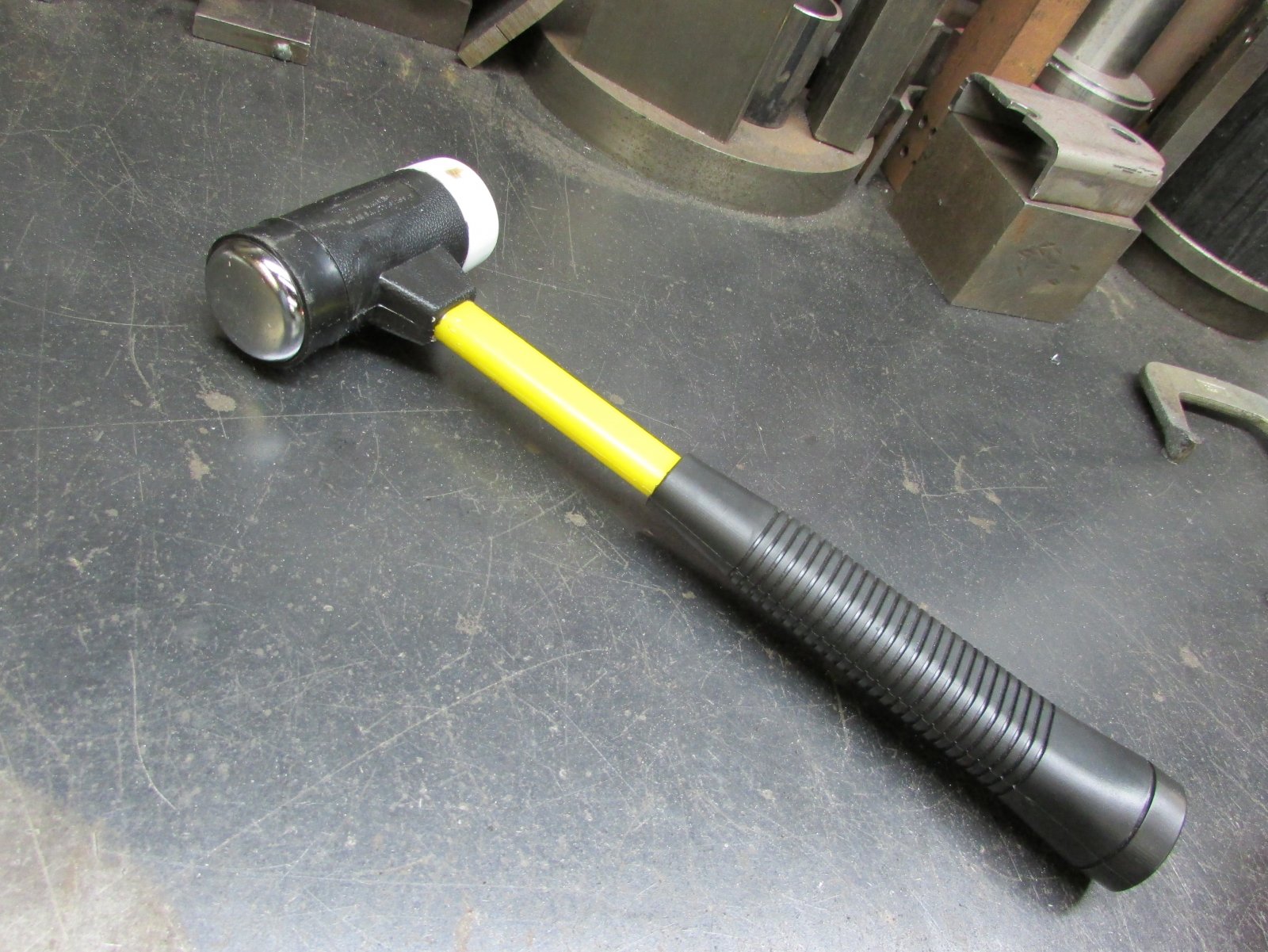

    Discovered a couple items, new to me, I thought to share as I'm particularly pleased with the value that my hard earned dollars yielded.
    The Rust-Fix is a clear spray. Very controllable, no runs or drips to chase. Immediate contact with rust turns black. Couple light coatings, per directions, gets a nice hard black surface ready for paint. I just had to be aware of over-spray on my perfectly rusted body.
    The little mallet I'm a bit embarr***ed to say is from Harbor Freight :eek: Comes with four heads and the rounded one shown was perfect for most of the hammer work on the rear panel. I finished the "turn" at the base with real body hammers but this one was too good to p*** up! $4.99 :p IMG_3823.JPG - IMG_3828.JPG -

    Very cool. You're experience with the hammer reminds me of the body shop course I once took. I was expecting to learn about all the specialty tools used to repair fenders and make patches but was surprised to watch my instructor bend a piece of sheet metal using a post in the shop. When I asked, "didn't he have a tool for doing that?" He replied, " I just use whatever works." If that hammer works then it's perfect.

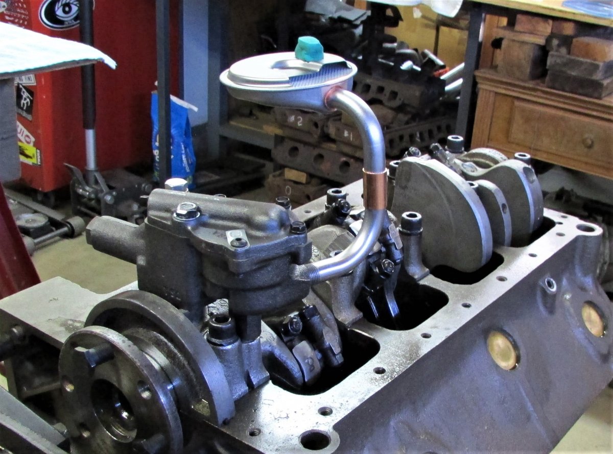

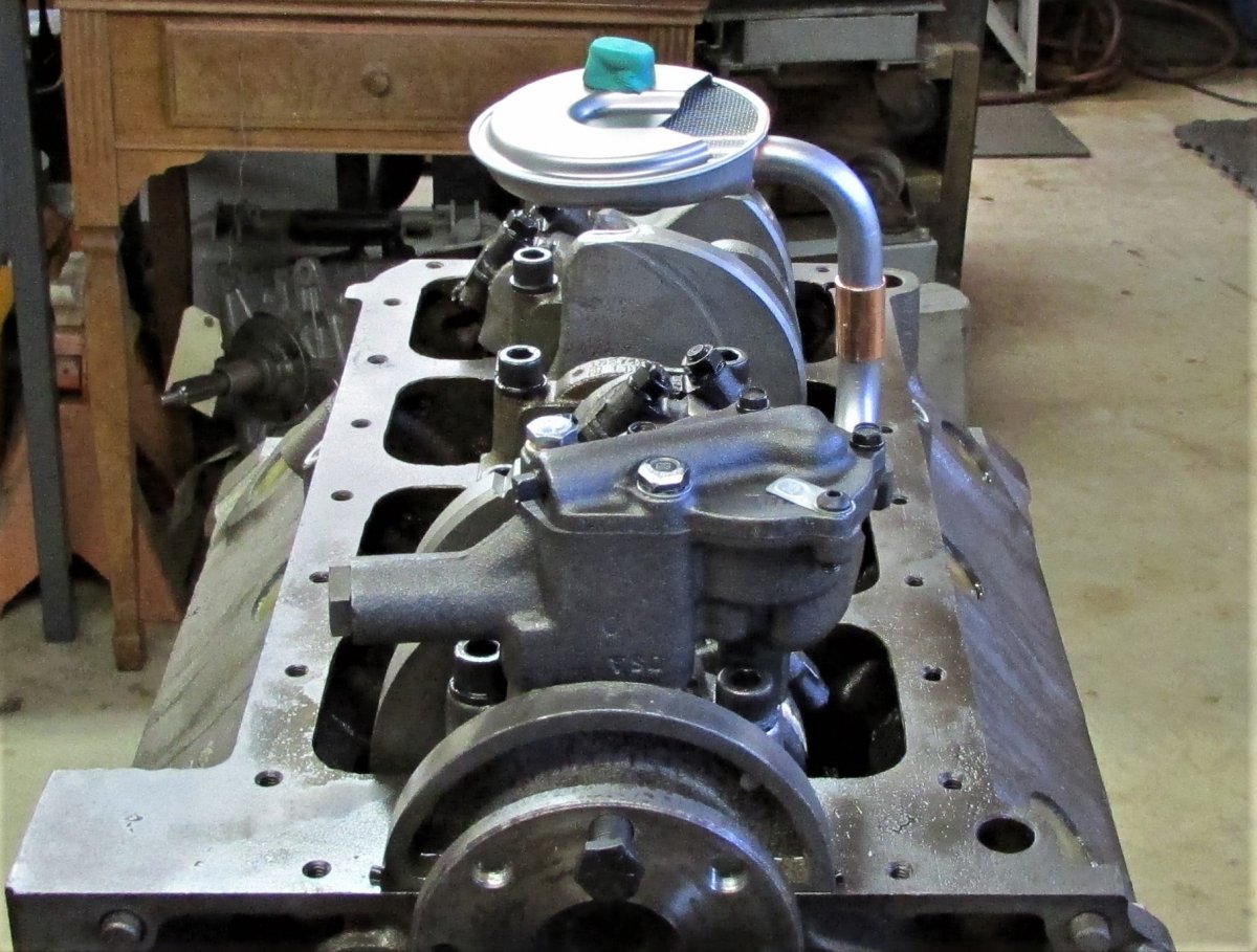

    classiccarjack
    I am glad to know that I am not the only one that does the "silly putty" trick to measure out the oil pan to pick up strainer clearance... LOL

    I love the various rust "conversion" products available now for many uses especially like this for stabilizing things both short and long term. Buy the way Mr. Bill, How are you these days. Those main caps you wanted back are still here in a box w/your name. Still following your escapades with envy.
