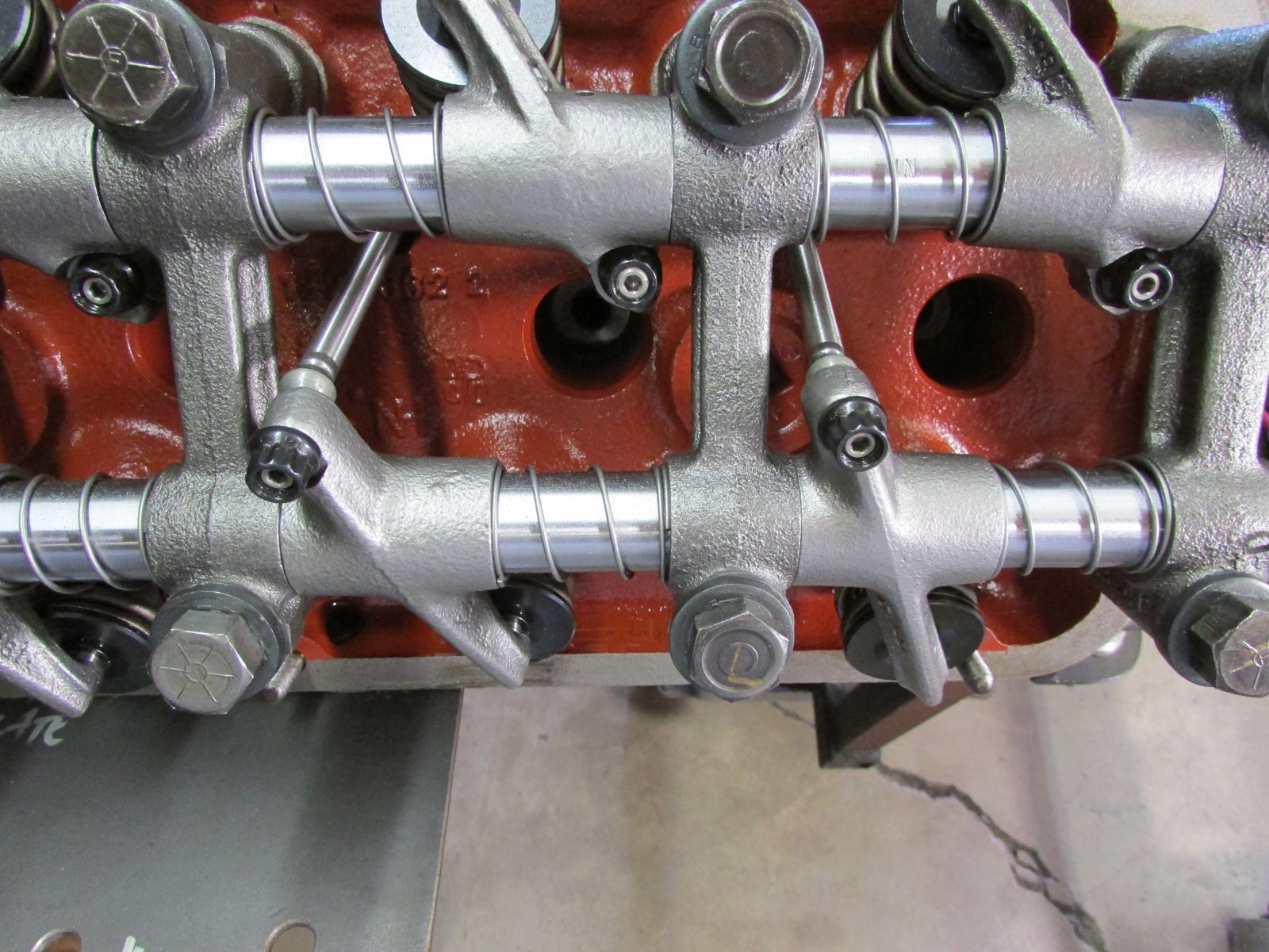

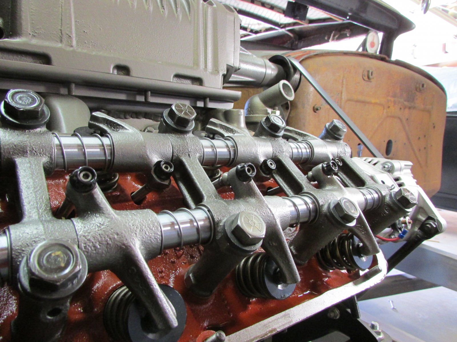

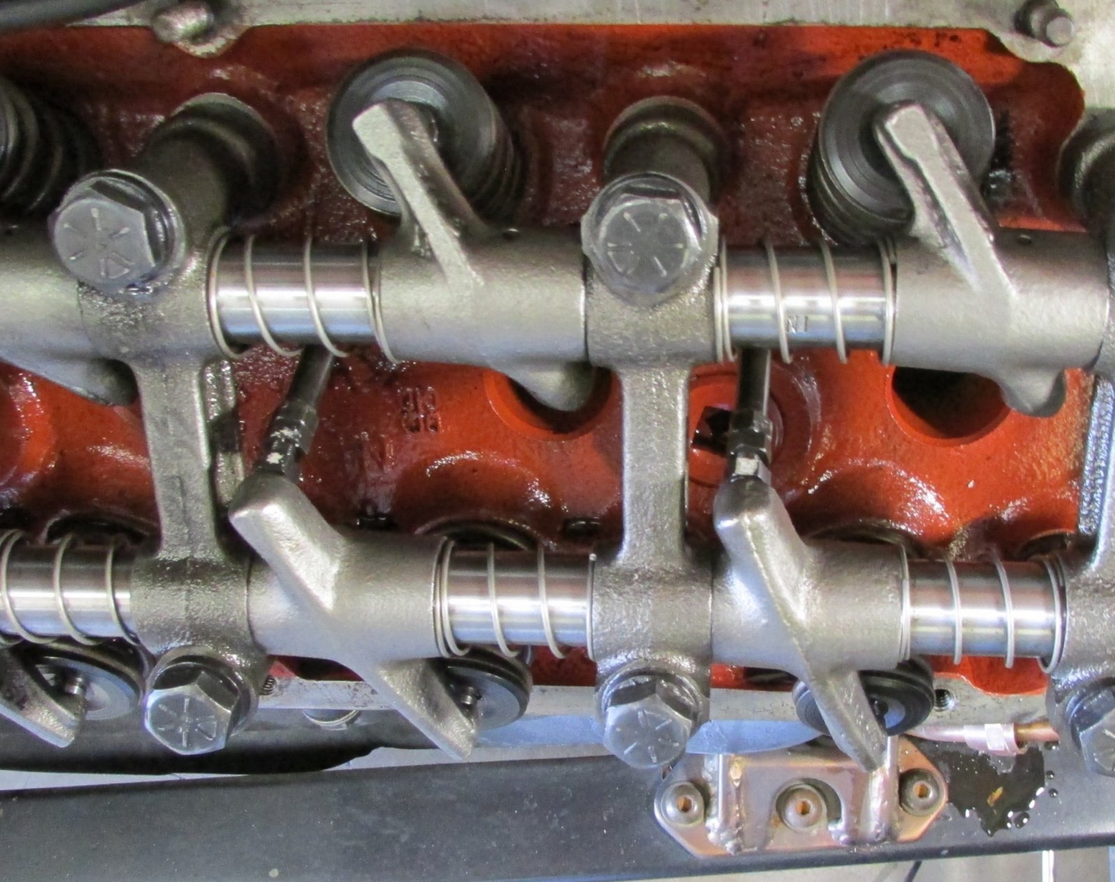

    Here's a bit of a "sidebar" for those who may be of an Early Hemi persuasion. It's also an excuse for not making progress on the A Project. And, now I have experience I'll probably never use again.
    That said, my Roadster runs strong and no valve cover leaks after 70K miles. I really didn't want another project however, I consented to addressing the faintest of lifter noise after endless pestering by a good friend. I completely forgot what a PITA adjusting the lifers was. In fact, dunno how I pulled it off in the first place even with the engine originally of a stand, not in a car.
    - Note, in the first pic, that you can barely see, much less access the adjuster nuts on the push rods. The intake push rods are beyond impossible. This is where I butchered several really good old tappet wrenches and I gained "experience!" I was not looking for :rolleyes:. IMG_4190.JPG
    - Below is the valve train of the engine featured in this thread. Although Chrysler supplied adjustable rockers on limited Dodge and Chrysler engines, they are heavy, extremely rare and very expensive, if you can find them at all.
    This is the solution provided by one of our own. Not cheap but a bargain considering the alternative. Gary Stauffer www.qualityengineeredcomponents.com modifies and rebuilds your rocker ***emblies. They look like jewelry when he has done his magic. I just like lookin at them!

    I'd say those are worth WHATEVER they cost! Nice work Gary!

    Wow! Beauty work! I'm always interested in the thought process that goes into designing equipment, a lot of the time serviceability isn't considered. Farm equipment is definitely a victim of this. What an improvement that must be going forward, you'll be adjusting those things just so you can look at them again.;)

    Adjusting push rods on early Hemis can be a *****. One wrench bent 90 ° helps, but but not like adjustable rockers.

    I didn’t know Gary did rocker arm conversions. I went through Rockers Unlimited out of Redding, CA on my 241 rockers. They turned out to be a very clean conversion. I may send Gary the rocker set off my 330.
