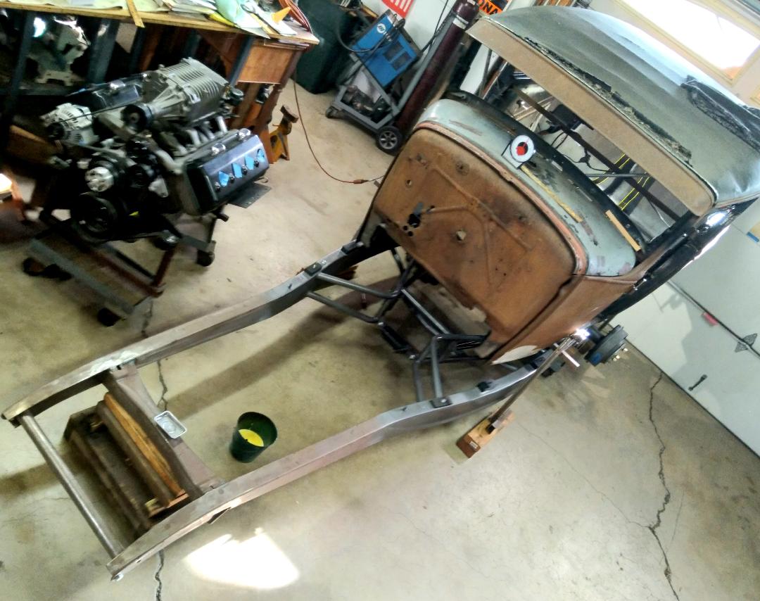

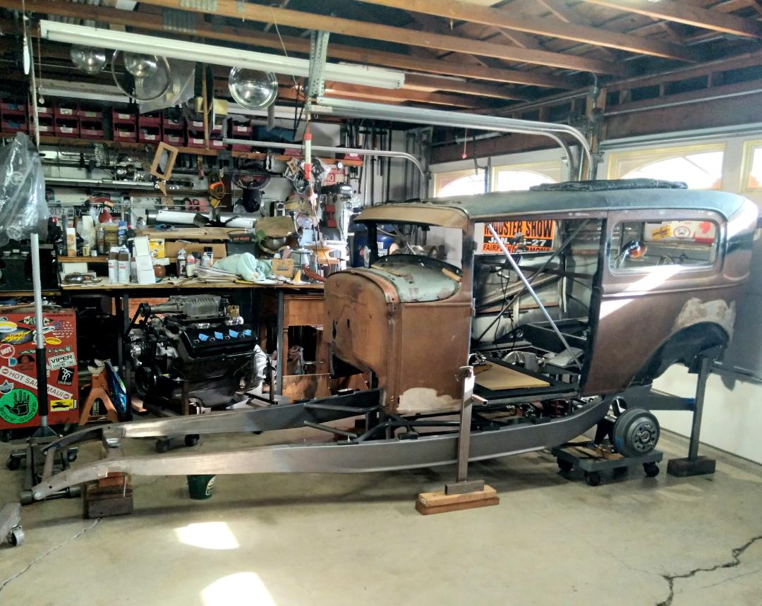

    Seems like reigniting the flame for this project is taking forever!!!!!!
    Slid the frame forward as planned but soon discovered it was way too low to work on. This old back was talking to me right off the bat,.... put me on the couch right away to conger how to get the frame up to a more comfortable working height.

  15. wstory
    Joined: Jul 4, 2008
    Posts: 1,988
    wstory
    Got the body "elevated" another 12 inches and the frame another 18 inches. All secure and stable. Now I'm ready to do some serious fabricating.

  16. 40ply
    Joined: Dec 11, 2007
    Posts: 377
    40ply
    Looking good Bill. Nice way to get stuff to working height. I'm finding it harder to work off the floor as well but thinking that the roof of the shop is too low for a hoist. :rolleyes:
