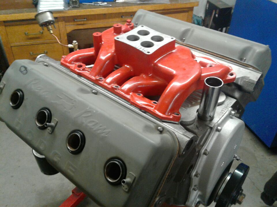

    wstory

    I love following this build. I don’t see any baby hemis being run these days. I think it’s the perfect engine. A blower on one is even better.
    is that manifold an OFFY 4 barrel?
    Here’s my 241 ready for pickup
