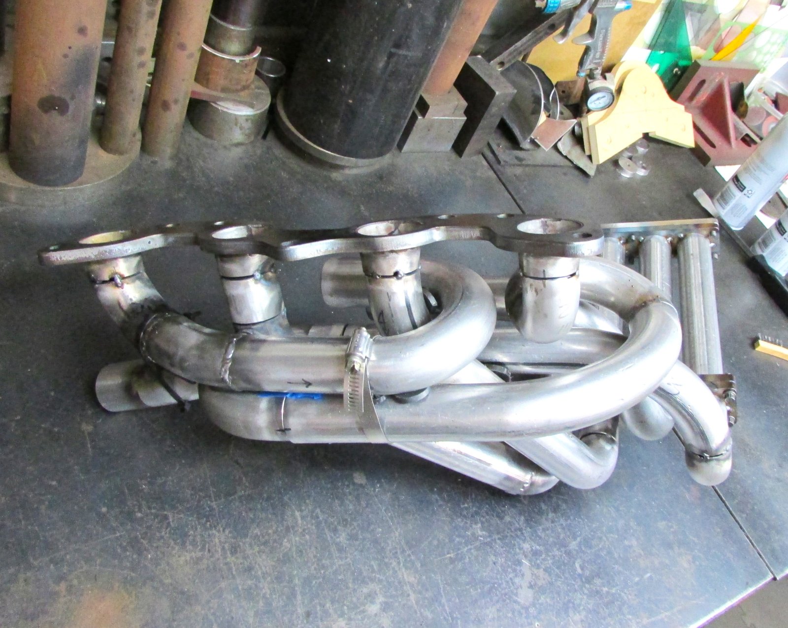

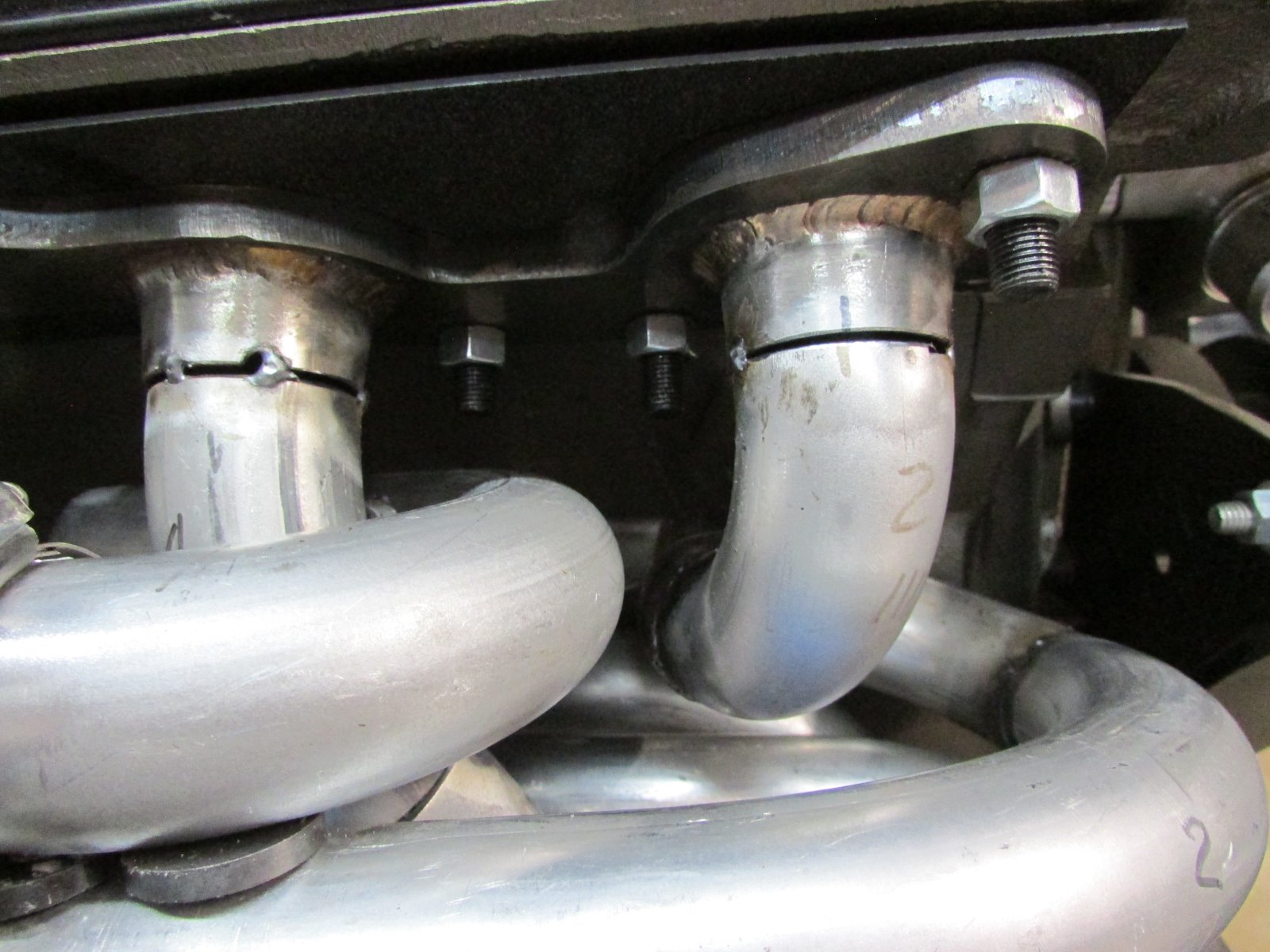

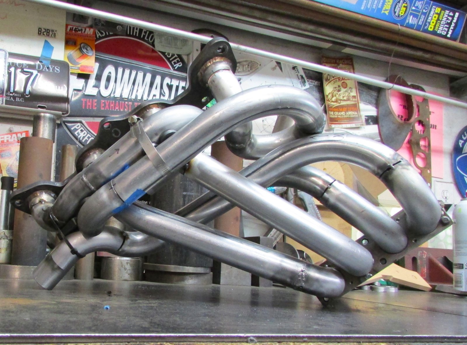

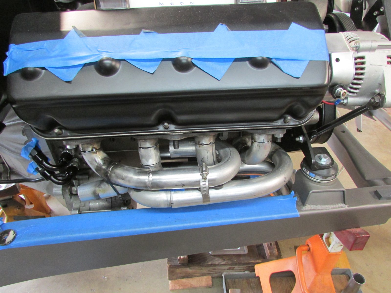

    Was stressing about clearance for the oil filter lines,...until coming across these trick "swiveling"
    90 degree AN to NPT fittings from Summit. (lower pic)
    And then back to the production of making little pieces. Took halfa dozen attempts to make the connection to the #7 primary,...that 3" section tacked into the loop wrapping around #3. That while ***uring that the header can be dropped down between the block and the frame. Not outta the woods yet but feeling pretty good about now.

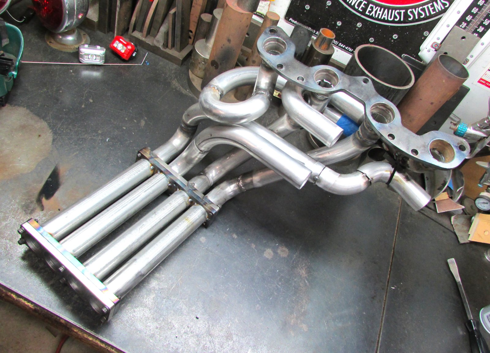

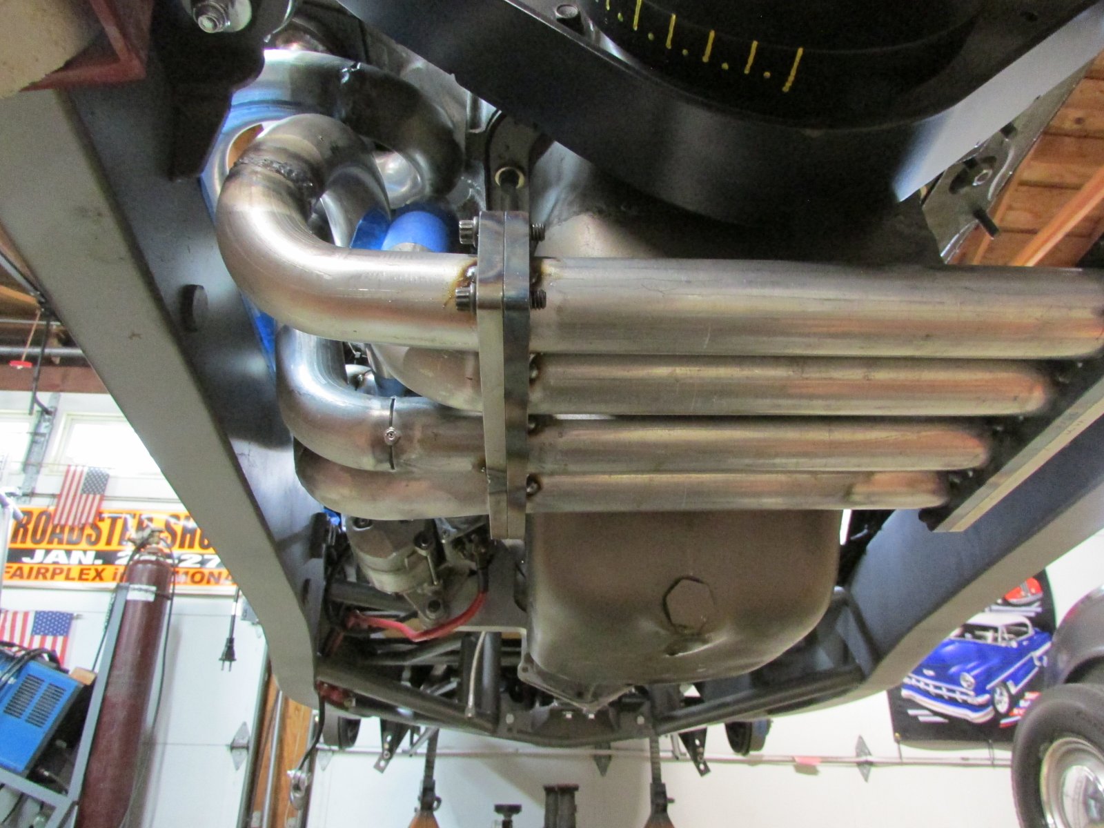

    Well boys and girls,...I've had to re-boot :eek::oops::mad:
    I tell folks, who seem to be interested, "it's not rocket science". Starting off on a project like this is like crossing the creek on stepping stones. You can't see them all when you start but believe you'll eventually find a way to the other side. The journey was successful for the p***enger side header, but man, I ran outta stepping stones on the driver's side.
    After floundering around for several days, I came back to look for another route, just couldn't find the space for all the primary plumbing. I ripped out much of what I'd done and got on the phone to Summit Racing for another "shipment" of stepping stones,...aka exhaust bends.
    I'm back to making more little pieces outta big pieces o_O That I'm good at!

    That **** is frustrating. You draw and measure a million times but you really never can tell until your doing it whether that’s how it’s really going to be.
    looking forward to the next round of your pipe bending masterpiece

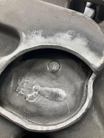

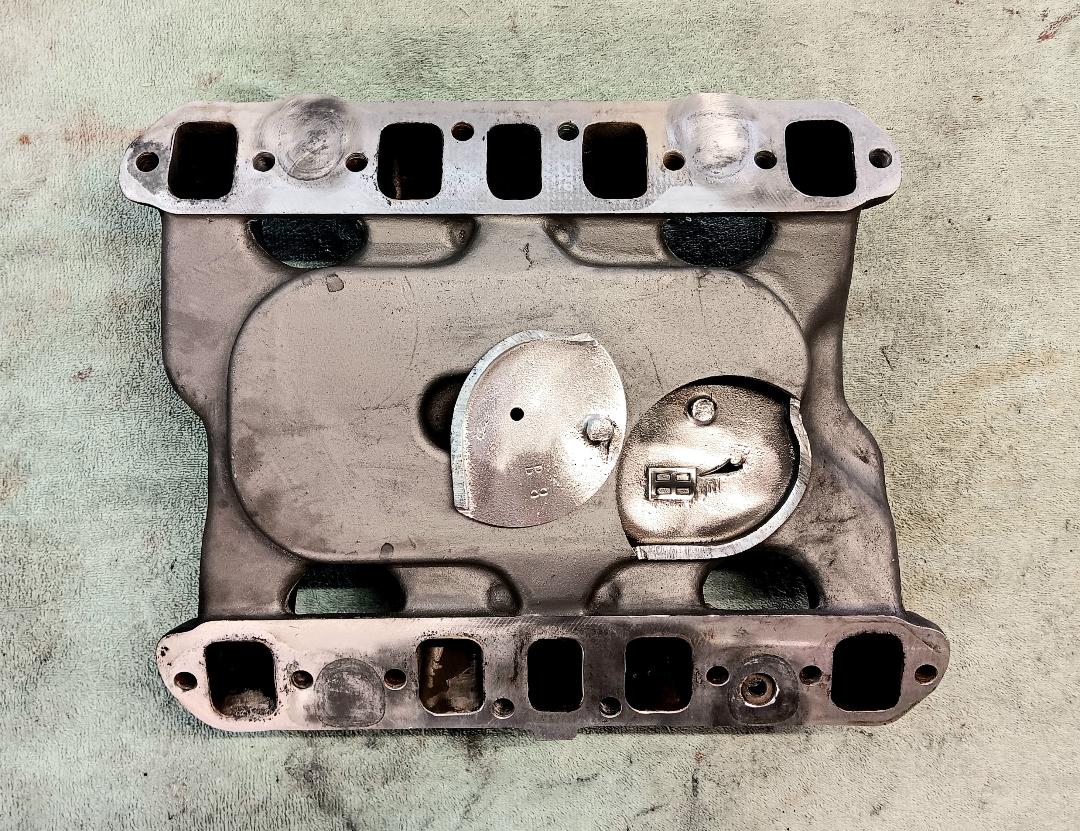

    How the hole in the manifold? Sorry for all the rocks falling on u

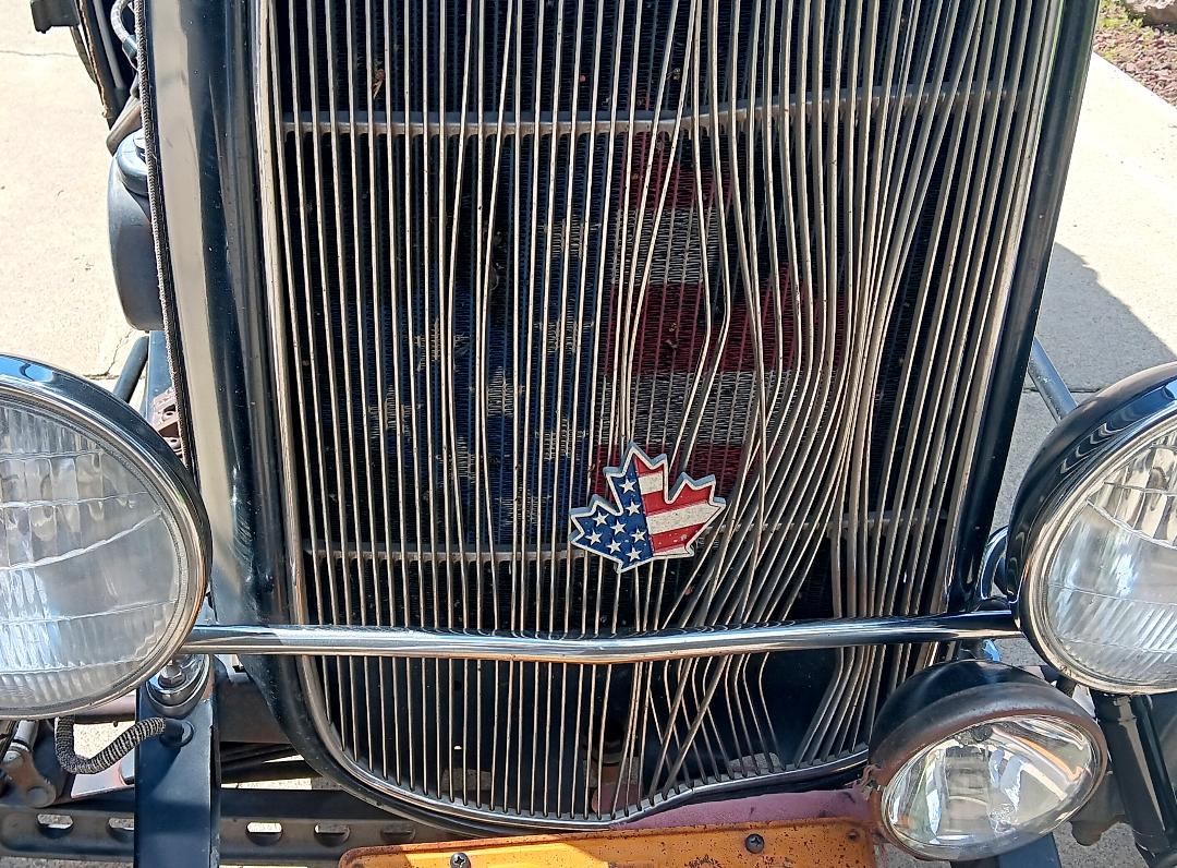

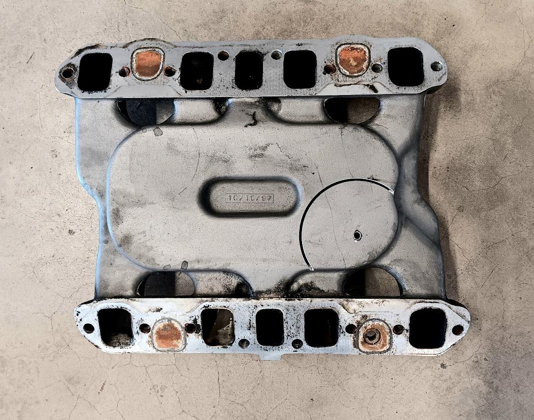

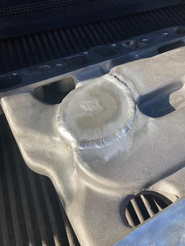

    AmishNike,...hole was because the mold for the casting did not completely fill. :oops:
    Soooo,....to quote my note of a coupla days ago.....
    Grill repair is about done and I hope to fire up the Hemi this weekend. Then,....test miles cause y'all know that **** can happen even after a careful refresh. Major trip with my buds begins June 11.
    **** HAPPENED :eek: :oops: :mad:.... on the test drive. After about 200 miles 5th gear went away. I limped 60 miles home in 4th. Trans is out as we speak. Upside is,...**** happened before a major trip!
    In the meantime, the grill shell repair came out primo thanks to a very talented panel beater friend! The insert is new.
    And Ron, I took your advice before I screwed up my refreshed grill.
