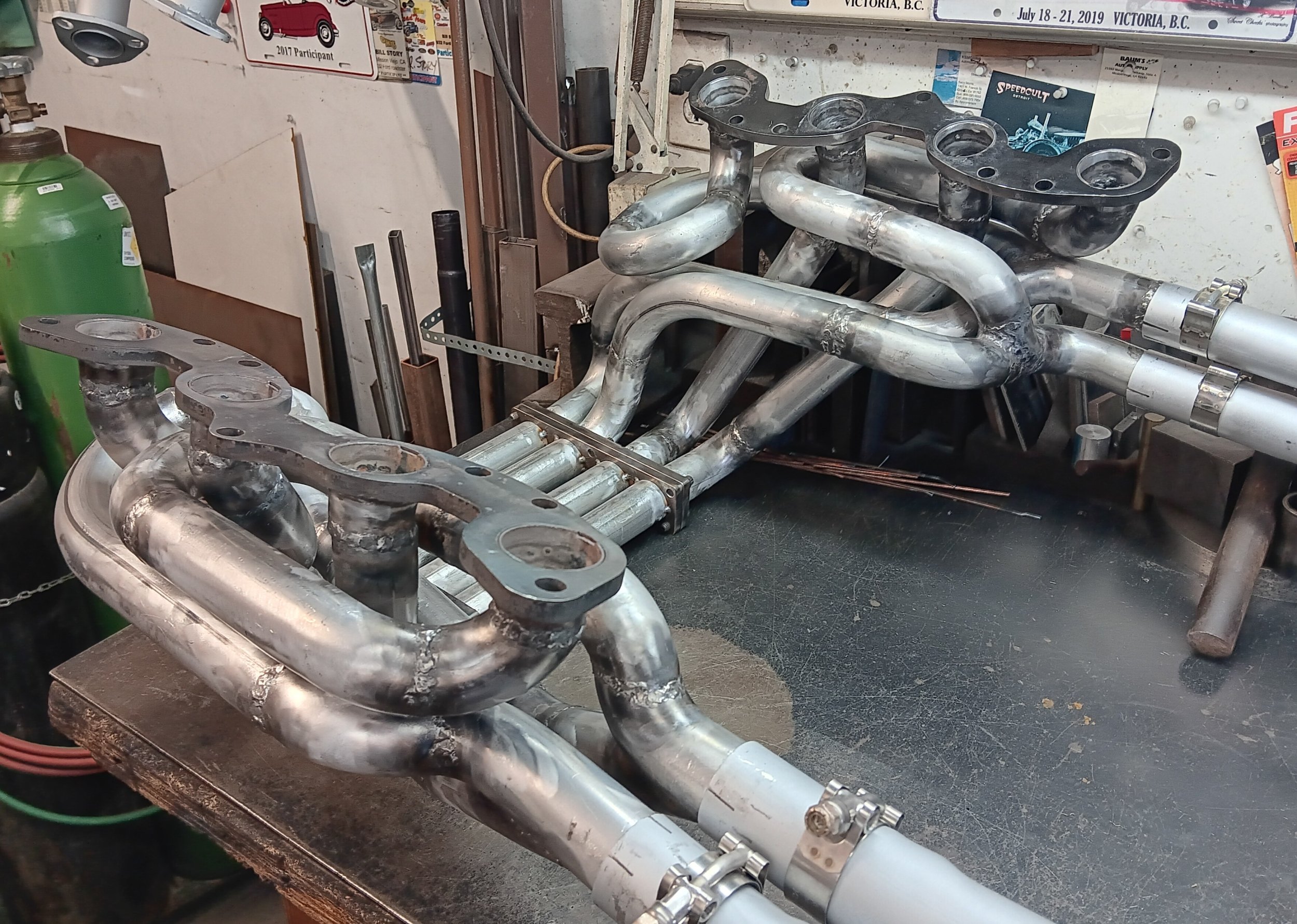

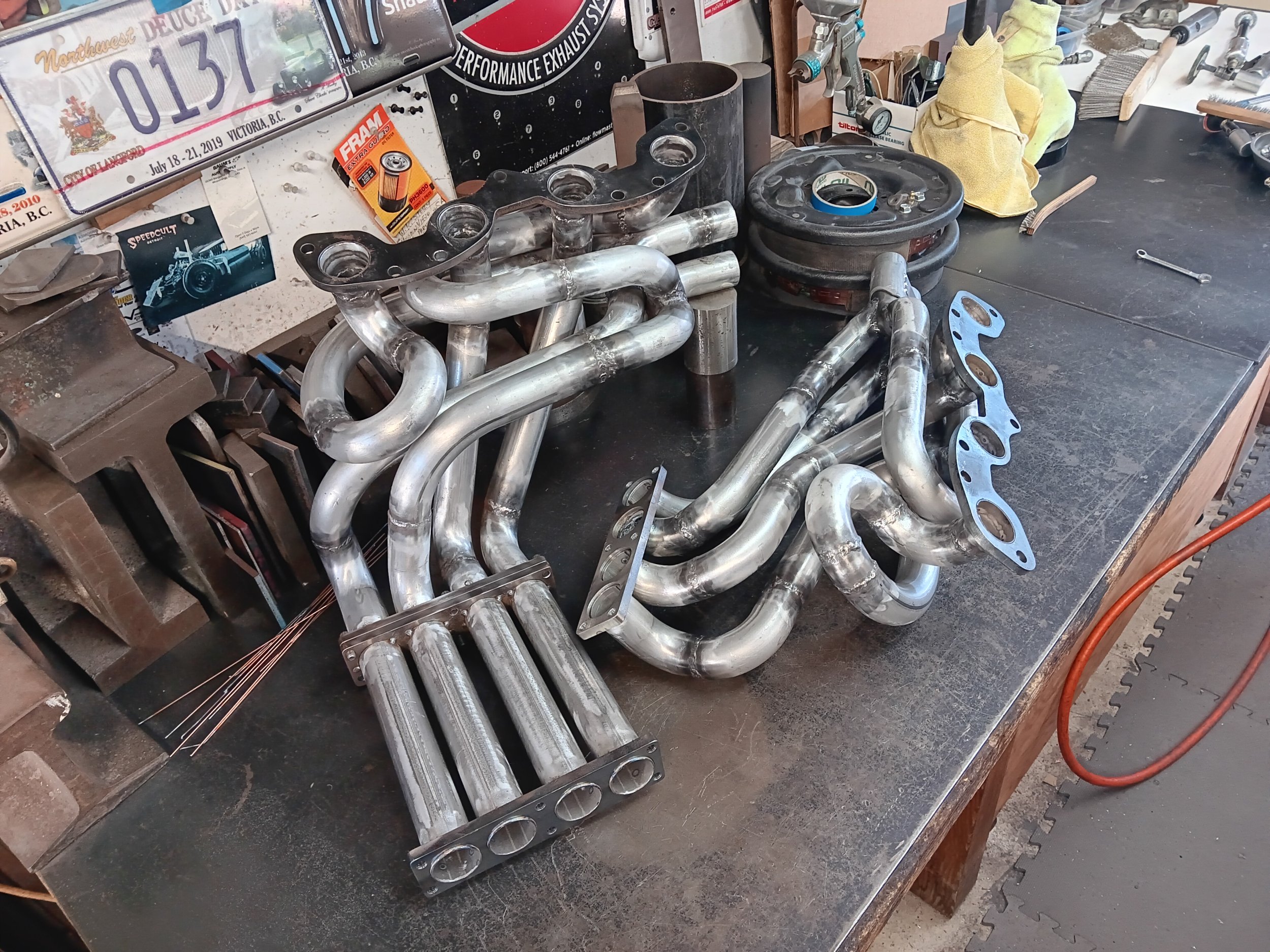

  13. wstory
    Joined: Jul 4, 2008
    Posts: 1,984
    wstory

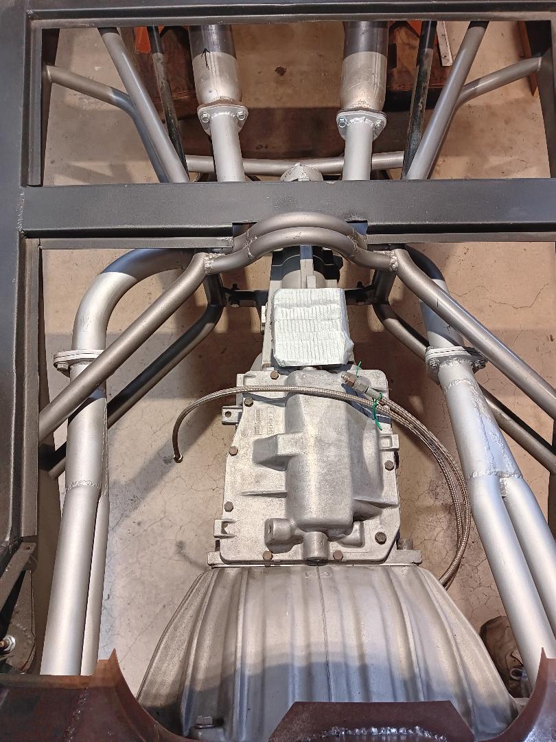

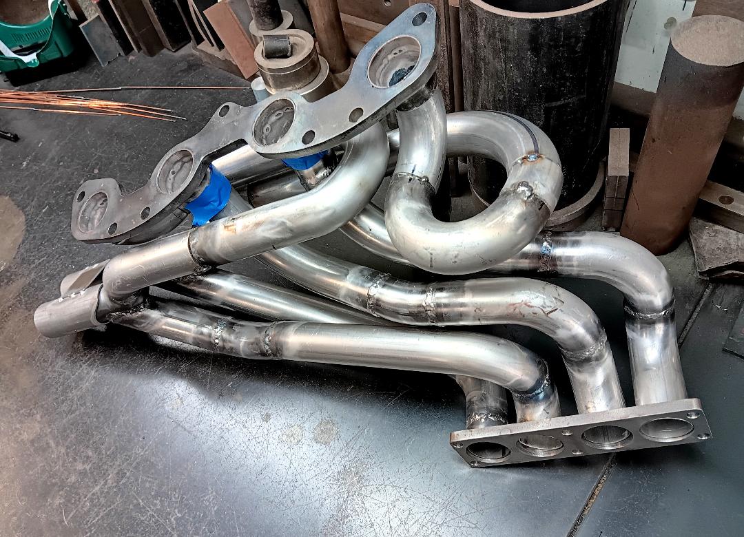

    FINALLY ! ! ! ....., another milestone.
    Although I anticipated having enough clearance to remove the headers (it's really tight), I was a bit concerned after tacking everything together that I might get a nasty surprise. Concern gone ! After unbolting both the flange to the engine and the manifold routing primaries under the pan, the driver side header dropped out slicker'n snake ****.
    Now on the bench, finish welding can proceed. The blue tape seen in the second pic is temporarily holding those two primaries in place. Those tubes will be removed in order to provide access for welding otherwise inaccessible joints in the adjacent tubes.

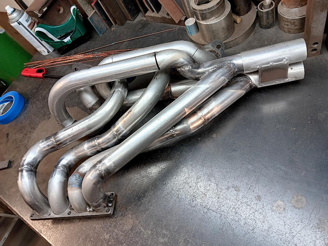

  16. wstory
    Joined: Jul 4, 2008
    Posts: 1,984
    wstory
    Whew!!!!!!!!! Now when people ask "Why",... I can respond, "because I can!" T'was touch and go there for awhile but I finally got over the hup. thumbnail 16.jpg
    I, like i image most folks, are inclined toward symmetry and I was frustrated by not being able to approach that. The failure to do that I blame on, 1) the heads are staggered by 3/4 of an inch. 2) the firing order is not consistent between right and left banks. 3) clearance requirements for oil lines on one side and the starter on the other were very different,....a considerable effort to yield symmetrical muffler and tailpipe locations.

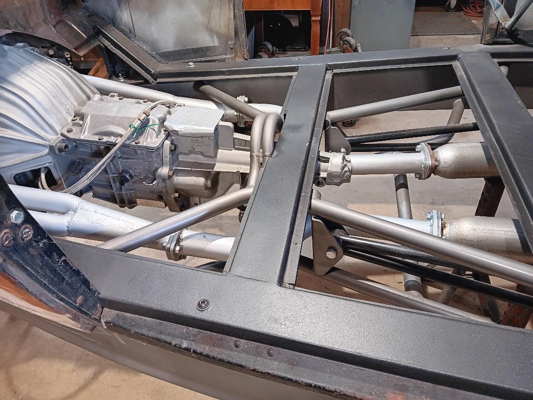

  25. wstory
    Joined: Jul 4, 2008
    Posts: 1,984
    wstory
    Is there a reason you necked it down so far at the end of the header?
    seems like the tailpipe is really small for the large primaries in front of it.
    A lot of this project was/is an exercise to see if I could actually pull it off. I attempted the same on my 32 several years ago but gave up. That experience drove several decisions. This engine is all of 270 inches, the previous being 325 inches,...with 1-5/8 primaries and 2-1/8 exhaust. The Model A has less real estate than the 32. So,....smaller tubing like 1-1/2 inch primaries and 2 inch exhaust means tighter bends for tighter spaces. And then, getting all the "plumbing" collected and stuffed under the firewall while preserving foot space, with gentle transitions, lead to the extended collectors.
    Also because of that "box of snakes", I am driven to suspended pedals and cowl steering,....cool but, no surprise, more challenges!
    Current status is completing the system from the mufflers to the end of the tailpipes. Until now I've guestimated clearances between panhard bar, axle, coil-overs and gas tank, which are all very tight. I'm hoping to receive and install the coil-overs in the next few days, and not receive any surprises.
    Deutscher, Tim, brEad and 4 others like this.

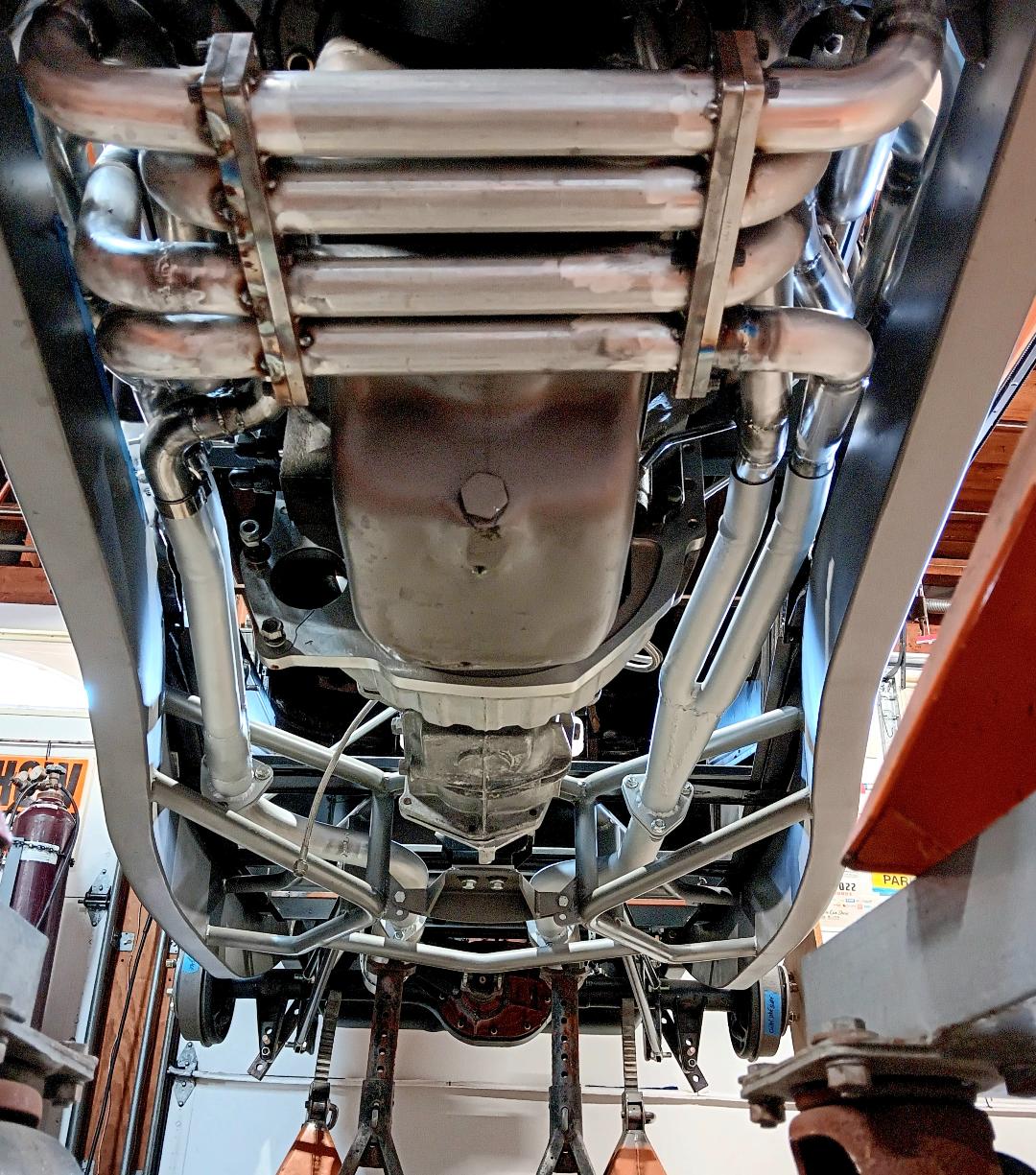

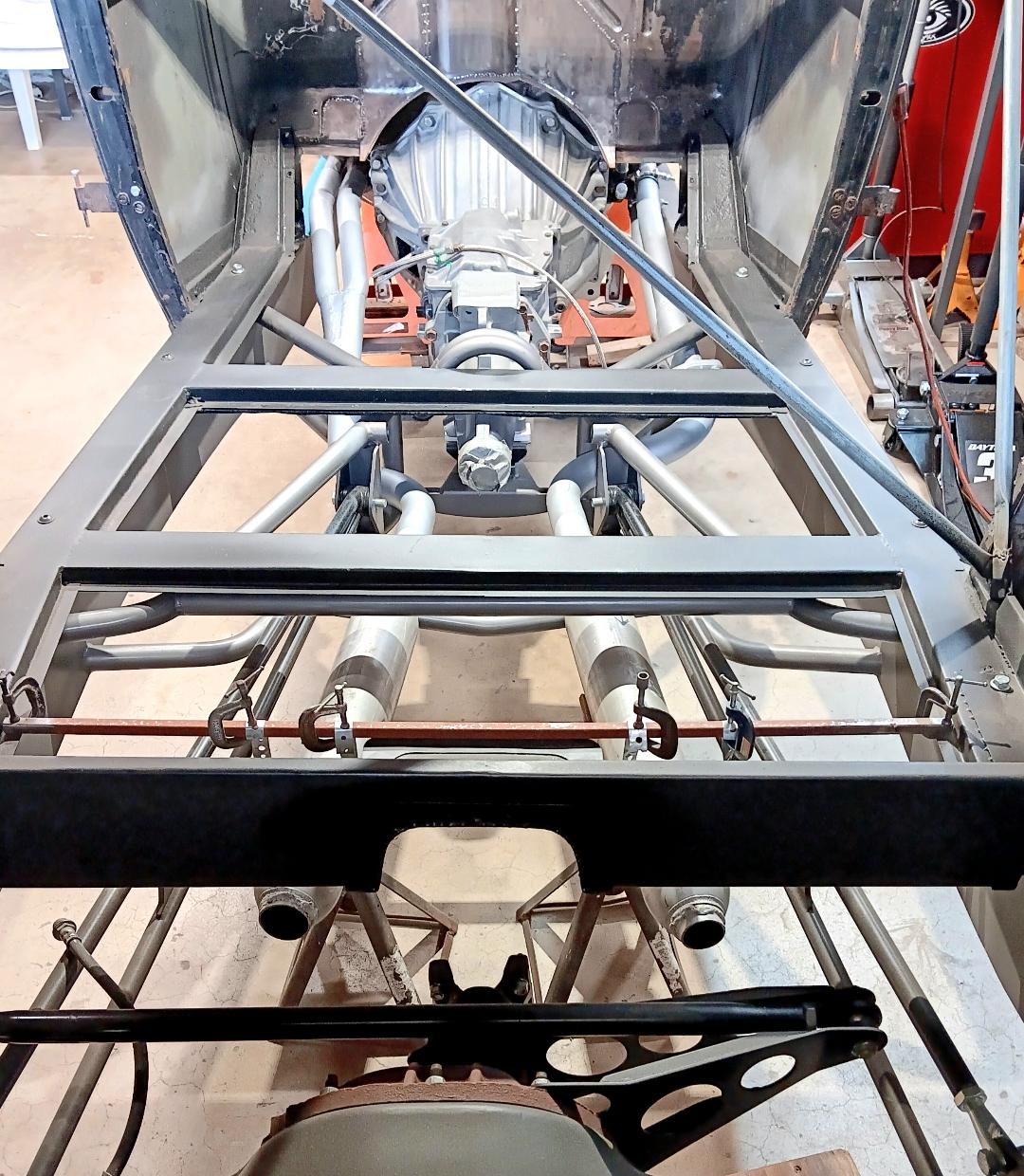

  26. wstory
    Joined: Jul 4, 2008
    Posts: 1,984
    wstory
    EXHAUSTED ! ! ! :rolleyes:
    Can't claim to be done but close enough. You'll note that many of the joints are still "tacked". That so's sections could be broken apart to adjust clearances which are really tight. Like 40ply sez " nice thing about steel" Also got the coil-overs mounted and hangers figgered. Finish welding will be "cake".
    And,.... I love looking at and recording the curves and spatial relationships.
    Deutscher, Tim, brEad and 9 others like this.
  27. Looks great Bill! Nice progress.
  28. wstory
    Joined: Jul 4, 2008
    Posts: 1,984
    wstory
    Few more that I couldn't figger how to edit into the sequence :mad:
    Deutscher, brEad, Tat2Neil and 9 others like this.

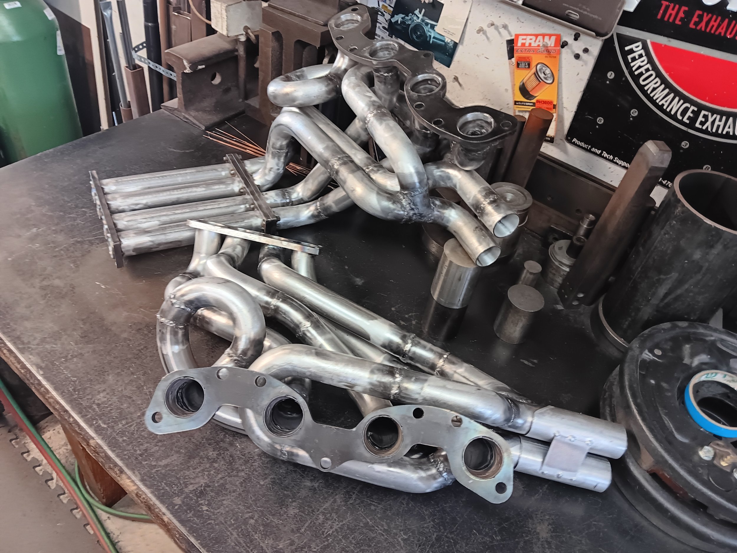

  30. wstory
    Joined: Jul 4, 2008
    Posts: 1,984
    wstory
    Welllll,....finish welding was NOT cake. There were four surfaces that had to line up,..the exhaust manifold surface on each head and the flanges that connect the four primaries that cross over beneath the oil pan. Many of the connections were "tacked" but when I took the whole pile of snakes apart, several of the tacks failed. I was particularly concerned about warpage when doing the final welding so there was a lot of trial and error and fitting and refitting to ***ure everything would, in the end, bolt up.
    20250429_164018.jpg Finally got all the welding done and all sub ***emblies bolt to the engine and to each other.
    I'm planning to get this stuff media blasted and then coated with High Temp exhaust paint. I know the High Temp is not the best but it will be quite some time before this guy is fired up and the paint will protect from corrosion in the meantime.
    Enjoy the pics. I sure like looking at the final result that will "embrace" the engine!
    20250429_165421.jpg 20250429_165427.jpg 20250429_165656.jpg 20250429_171345.jpg
