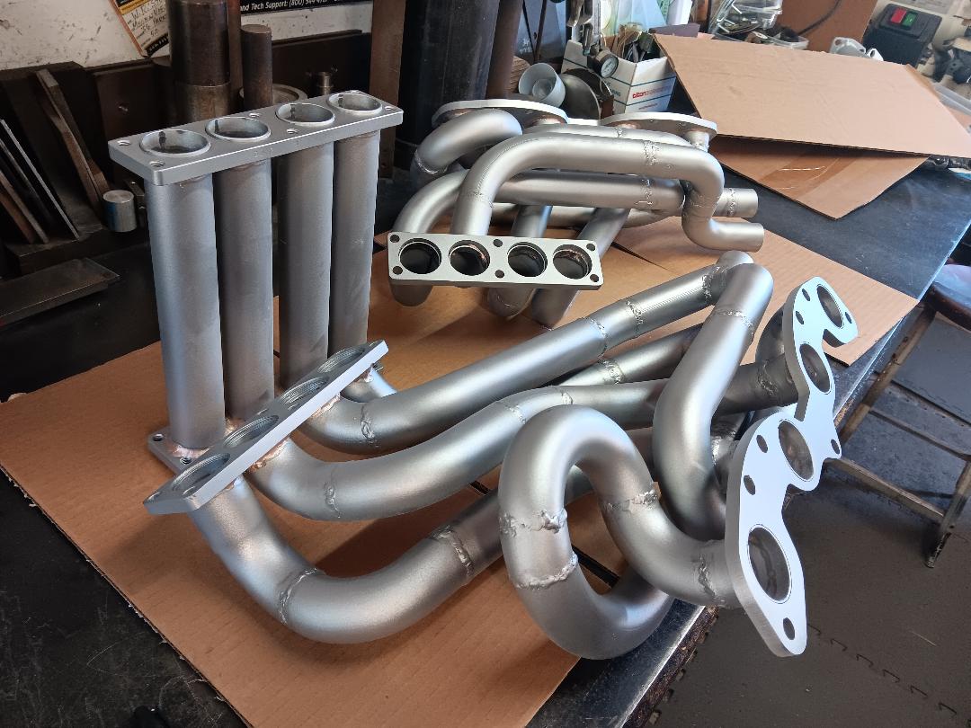

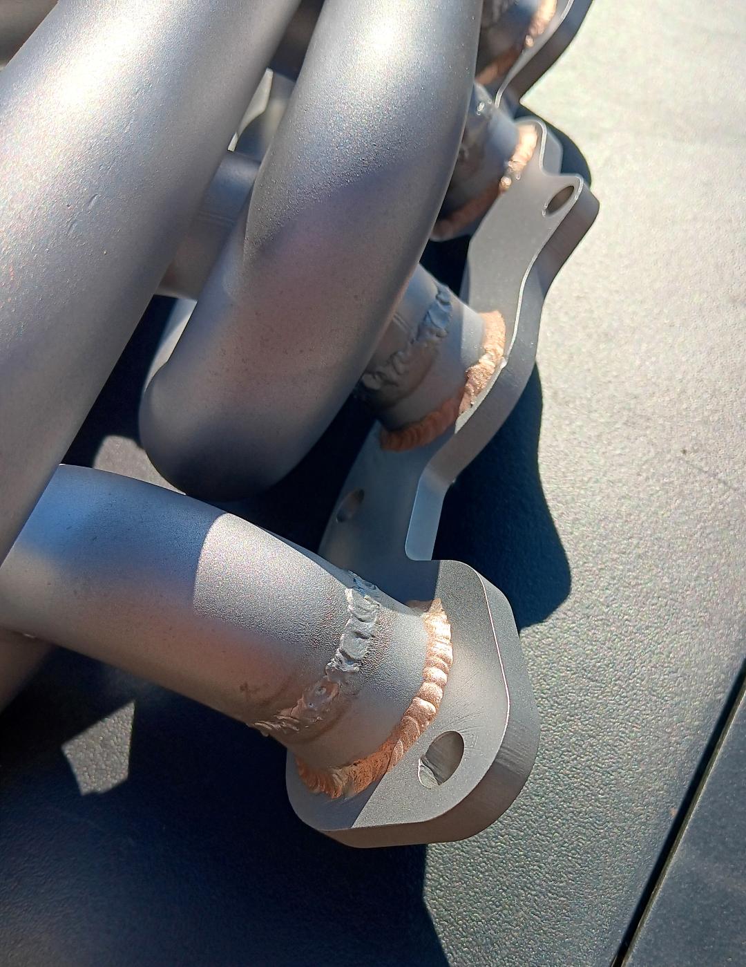

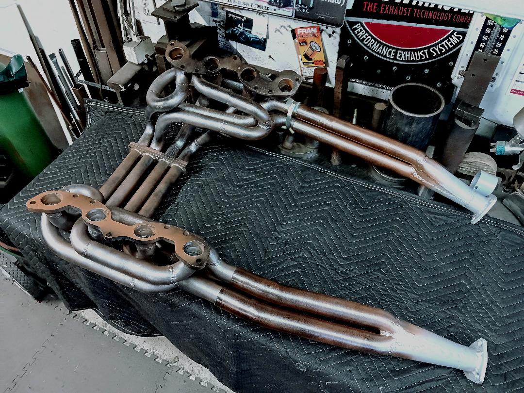

    Got the "snakes" back from the media blaster. Obviously the surfaces look more homogenous now. Unfortunately the tasty bronze TIG weld beads, done by my friend Mike Hight, can't be appreciated after stuff is painted. :(

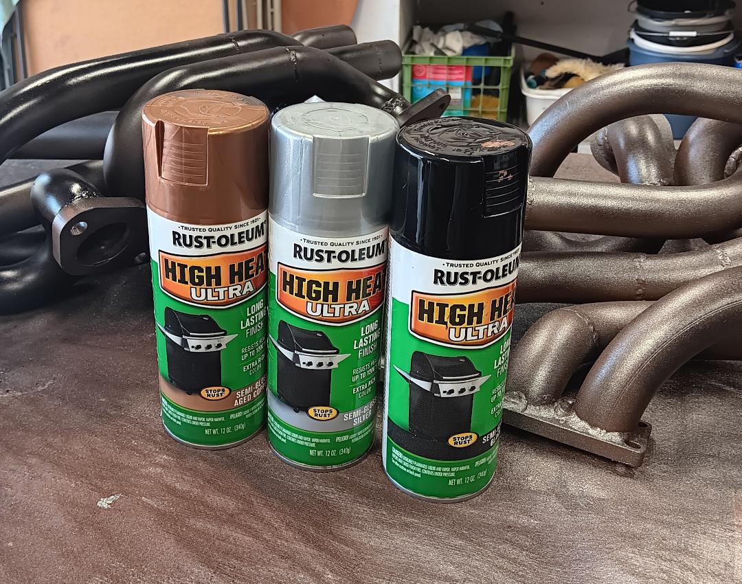

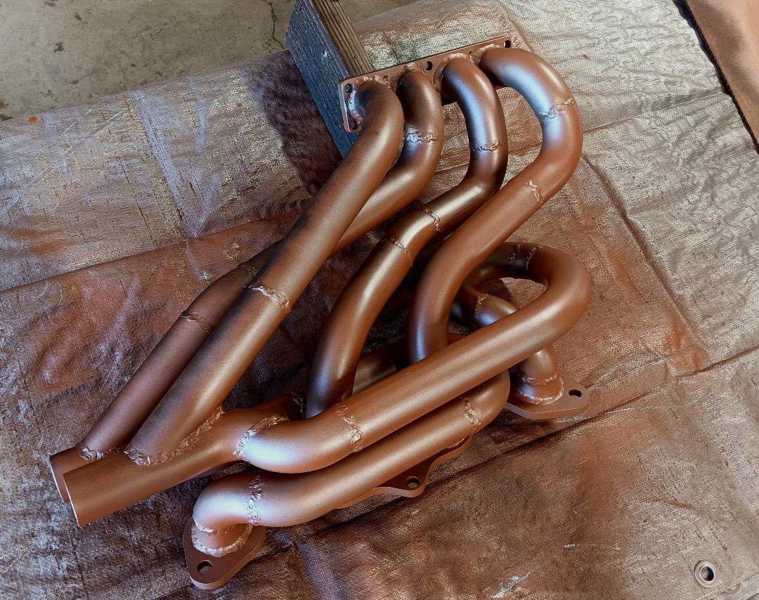

    As previously mentioned, paint was to be the short term coating solution. I decided to experiment with layering available colors because I didn't care for any of the HI Temp options.
    The "Copper" turned out to look more like chocolate :eek: However, the following "dustings" of Black and Silver got me closer to an acceptable color for the near term.

    That spray bomb blend looks great Bill!

    The color on the exhaust looks great!

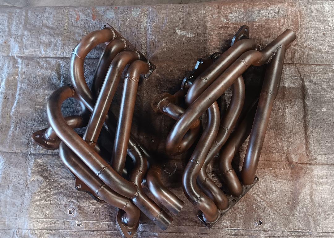

    Here's a little more on color. Interestingly the hue changes from a smokey grey to copper depending on the lighting and angle. Kinda fun tho most of that goes away when installed.
    I'm about to bolt this stuff on for the last time and get on with the next phase.

    FYI - I ran that "Bronze BBQ paint on my pipes"
    1. Looked more like Dog Poop than Bronze.
    2. Burned of after a while...(Note still tuning)
    Again Awesome job!

    Duster,....I understand the challenge of start up and tuning re exhaust temps. Were you able to "cure" the paint before running the engine in normal service? I have seen even expensive High-Temp coating ruined on startup as the initial curing routine could not be followed.

    Cure Routine...?
    I sprayed it the day B4 the Garage Shoot...LNSPBLVD
    Maybe i should read the instructions?

    I've just let them sit in the hot New Mexico sun seems to have worked just fine for curing the paint

    Thanks windup. I'm trying just that. 90+ here in socal today.

    Also thinking "heat lamp".

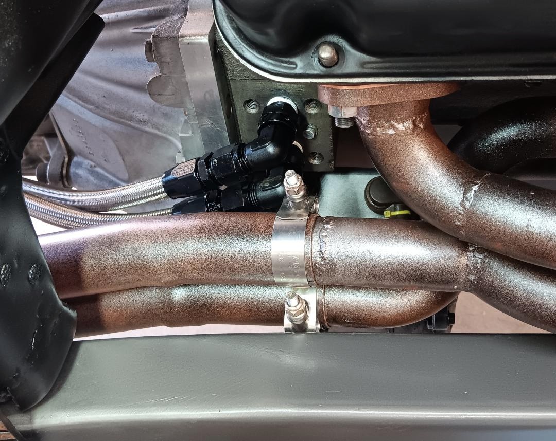

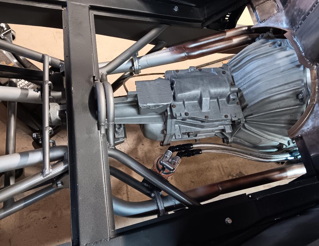

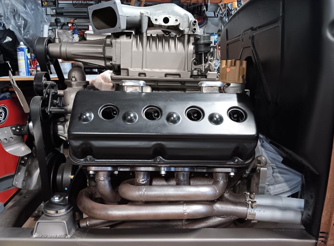

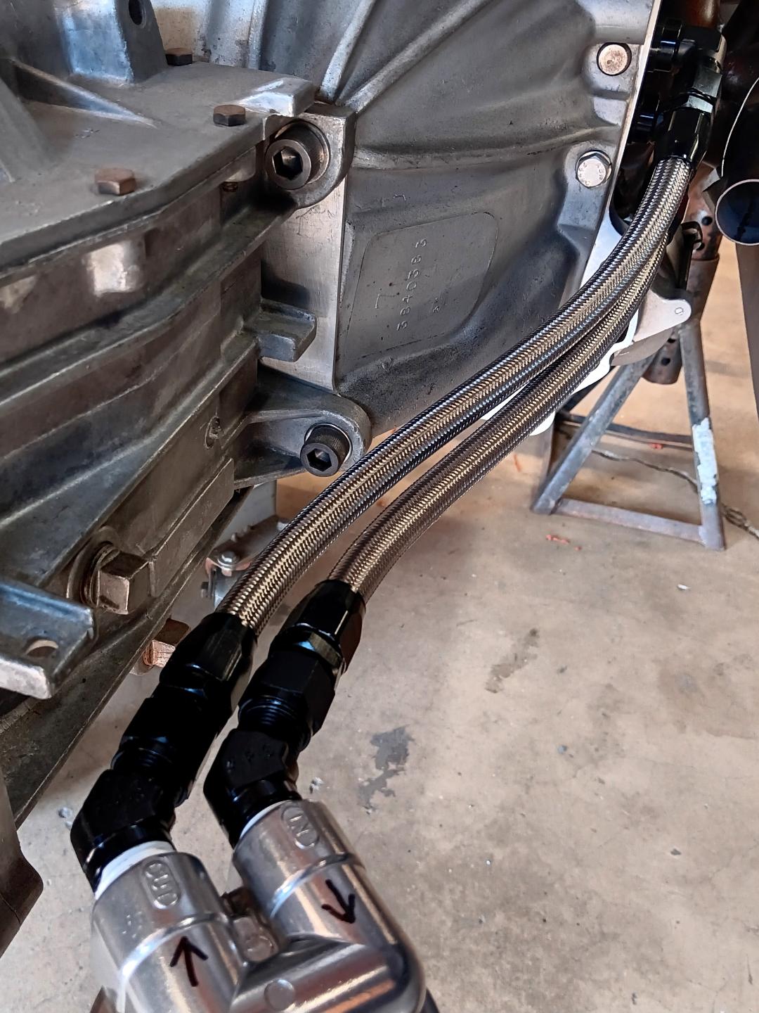

    Finally, finally,....as previously mentioned, ad nauseum, :eek: I've spent an inordinate amount of time stressing/fussing with details,...like the color of the headers and the configuration and details of fittings. Finally got what I was after 'tho with a few redos. Did several rounds with Summit in order to get oil lines compatible with the fittings I'd selected. Struggled with cutting those S.S. shielded hoses. I had to unbolt the oil filter bracket in order to provide wrench clearance to cinch down the oil lines. Finally DONE! I just wonder what the next guy who owns this car will think when he has to work on some of these ridiculously tight placement of components. thumbnail 76.jpg thumbnail 68.jpg thumbnail 70.jpg thumbnail 73.jpg

    He's going to think that this build was damn well done! Nice work Bill! Plus the big auto manufacturers never worry about the mechanics when their placing components anyway.

    The Sharpie arrows on the oil filter in and out will not be visible, as a reference, once the body is installed.

    They are for the oil to know which way to go when they get to the round-a-bout

    May be naive of me but I figger once they're hooked up, I'll never need to know which is which :eek: ;)

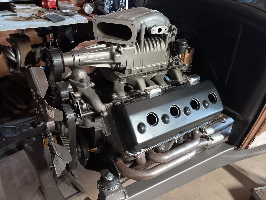

    I'm back with a certain amount of guilt! Finally the spark is starting to ignite my enthusiasm for getting back to the Eh. All full of piss and vinegar, I got this far before changing my mind on brakes. I'm hoping to get some credit for the brand new Wilwoods against Bolling Bros. 39 Lincoln drums.
