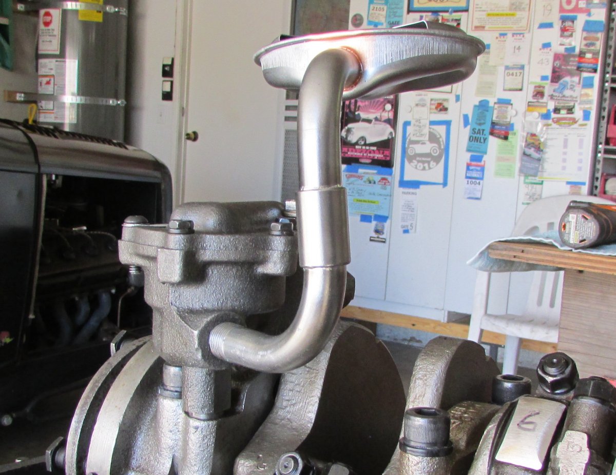

    Well ****!!!! Guess I gotta re-do that pickup tube. Thanks guys for your "heads up". Better have egg on my face now than being stranded on the road.;)
  3. MrBill, In my estimation, having to change that one small item isn't a mistake, it is just an improvement. I also shivered when I saw the copper, and feel better that you are changing to steel.

    Better??? Tx for the observation. Never thunk of that. Now I know everything :rolleyes:
    Seriously,....don't ever hesitate to share an observation or an opinion.

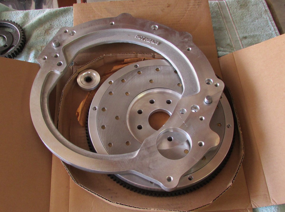

    Finally got the valve covers done (I'll show them later) and got TDC located and recorded. Small Block Mopar harmonic balancer is now marked with my custom Hemi timing marks. Still need to do the paint fill. IMG_2378.JPG IMG_2384.JPG IMG_2409.JPG

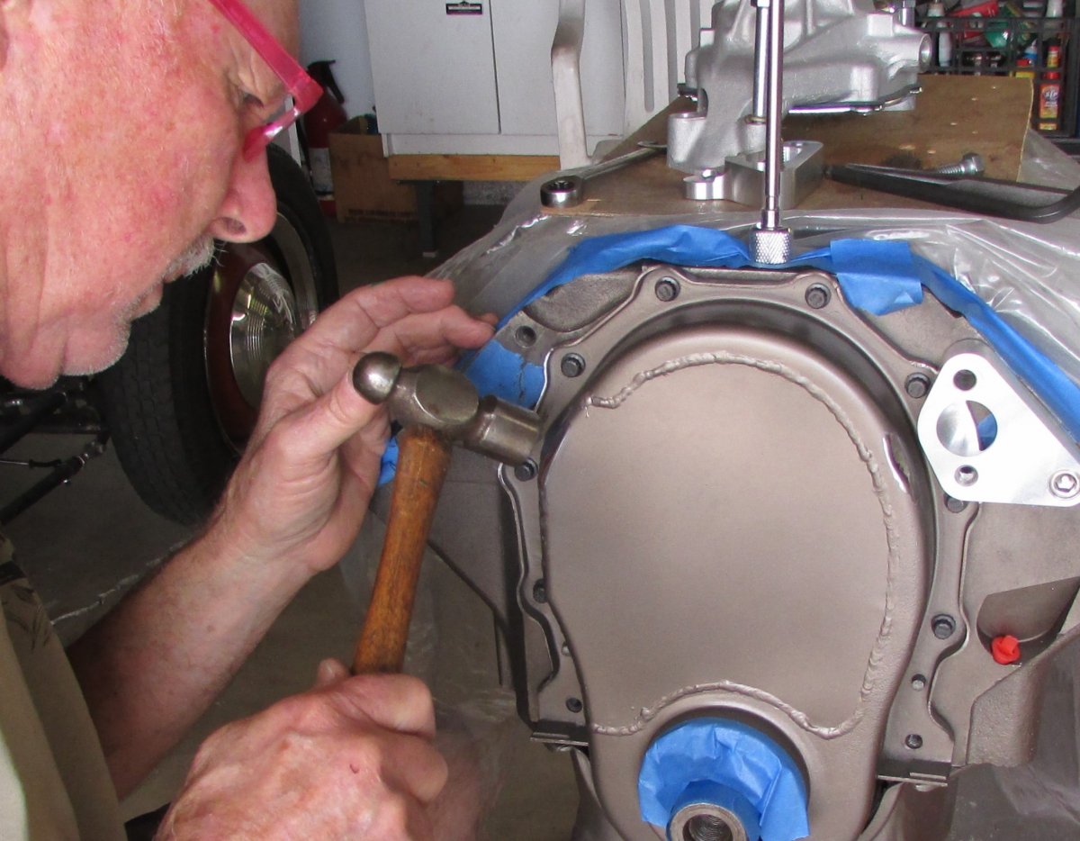

    This past weekend was like Christmas. Got my camshaft, SBC reverse rotating water pump, a flywheel and adapter to the 5 spd that's been languishing under the work bench. Trial fit of the water pump yielded some interference that was addressed by bashing on my customized timing cover and nibbling on the water pump to block adapters.

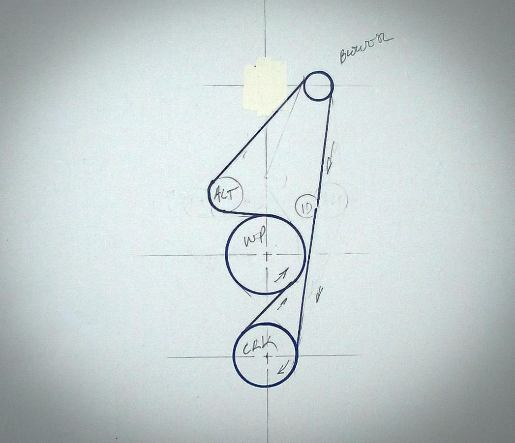

    During the "recess", accessory drive options were explored. I settled on this,....in concept, thus the reverse rotating water pump. Soon's I get the cam installed and timing cover ****oned up (and get the heads which I'm still waiting for) the accessory locations will be mocked up to see if it works like the sketch suggests.

    It may not be feasible, but getting the idler pushing on the opposite side of the belt may be advantageous. That way the blower pulley will get additional wrap as the belt stretches and engine speeds and boost increase. You may never see enough RPM and blower drag for it to slip or toss belts, but I know on high-HP blower cars, getting that belt to stay put can be a real fight. :)
    Great work!

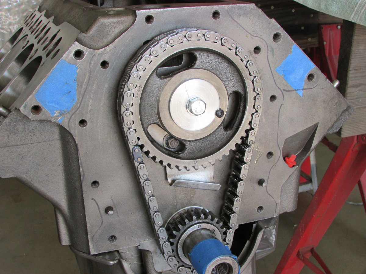

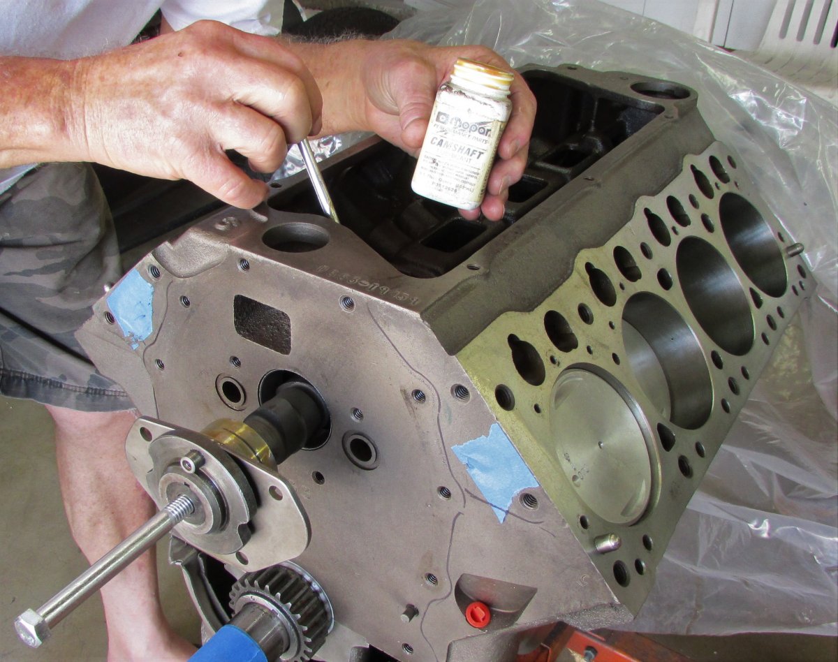

    Today's fun was getting the modified cam ***embly ***embled and installed. The long nose cam has been modified to accommodate the modified timing cover to accommodate the SBC water pump.

    Don't think so. Checked with a straight-edge. But I'll double check in the morning.
    Thanks for keeping me honest.

  25. Dick Stevens
    Joined: Aug 7, 2012
    Posts: 4,248
    Dick Stevens
    Probably just the angle that the picture was taken from
    warhorseracing, fauj and loudbang like this.

    Please, please, please gents, don't ever hesitate to share an observation. Checked it and this time I had it "covered". Whew!!!!! I'm just an average Joe with average skills and lucky to stay ahead of the curve. If I'da had a problem down stream, I'da thunk,....."shoulda double checked it".:rolleyes:
