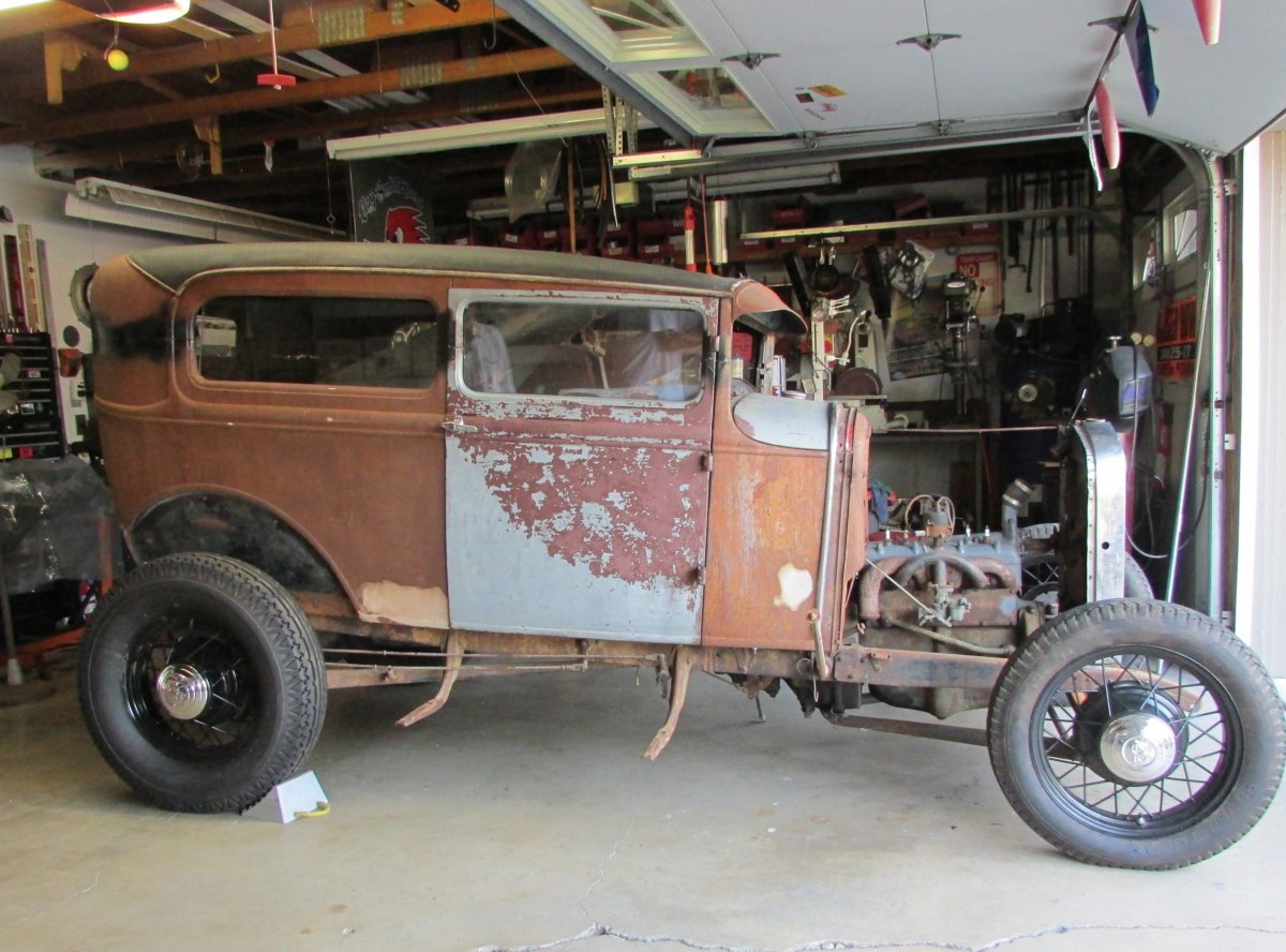

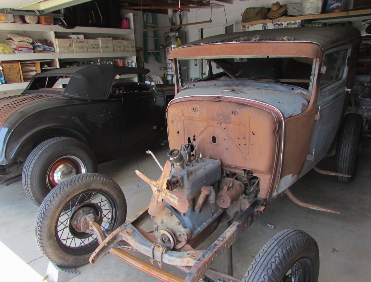

    And for the distraction,....I scored this A Tudor over the weekend. This was the answer to "whadda ya gonna put the Hemi in?" It came to me much earlier than expected, or needed, but all the stars aligned and it is now in my garage. The trick is, staying focused on the engine build and not fussing with the new toy. ;)

    Nice touch on the adapters Bill......and I love that Tudor. They'll make a great pair.

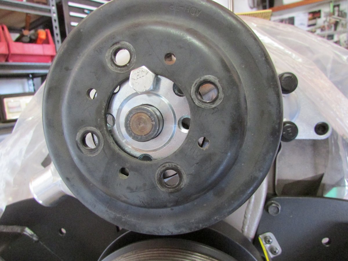

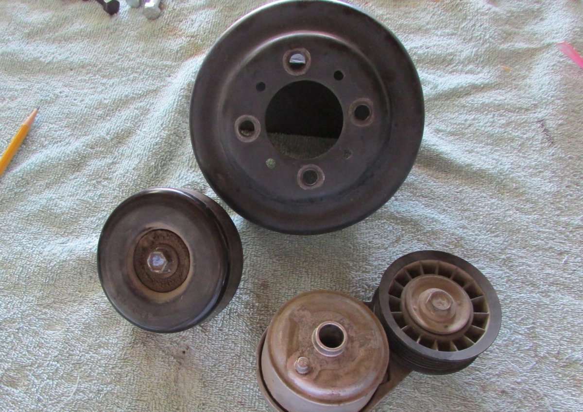

    So I'm sittin here in the garage pattin myself on the back, regaling at my cleverness for scoring all this good **** from the wrecking yard. Chevy smooth (reverse rotating) water pump pulley lines up great 'tho I'll need to patch for a new pilot hole and bolt holes.
    And then I see,...the tensioner pulley is a different rib count then the Mopar crank pulley and and I'm already looking at the blower pulley being another diff. rib count. No surprise I guess when you mix Mopar and GM and Ford stuff,... right? That's Hot Roddin right?

    Man, that ****s! It's like all the different wheel bolt patterns, why?!? This may be a stupid idea but could you machine the ribs off one of the pulleys?

    Mopar usually runs 7 rib belts, GM runs 6 rib belts. If everything else is 6 rib, just run the crank pulley one rib short. It's really no big deal. Personally I'd run as much 6 rib GM stuff as possible as it is way more common.

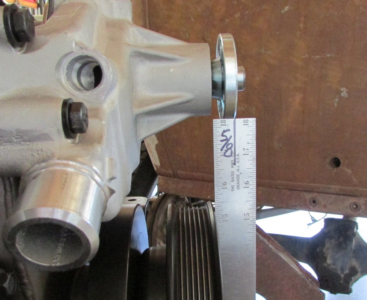

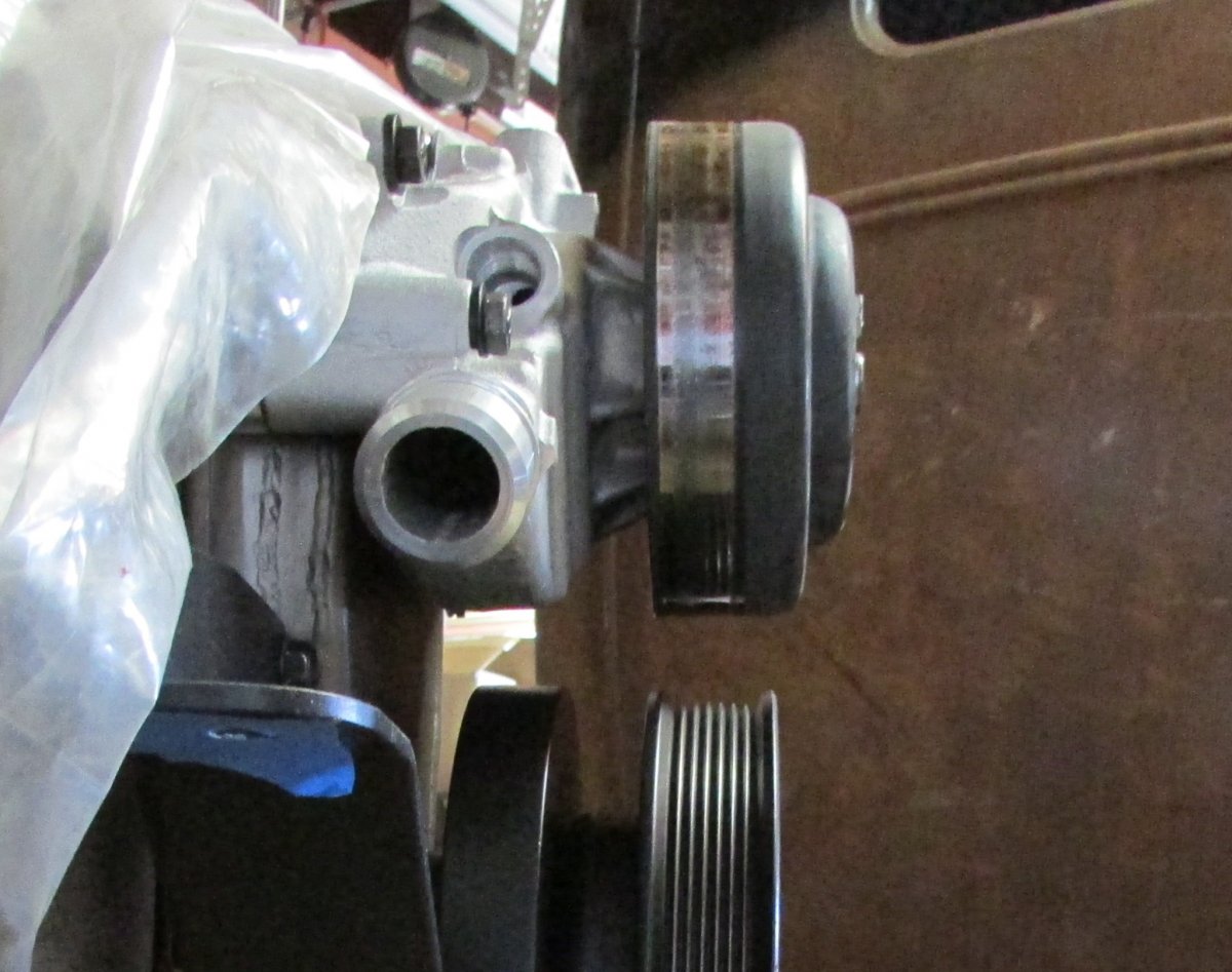

    Spent the day resurfacing and making the smooth reverse rotation pulley mate to the SBC water pump and an adapter to space the fan blades to clear the belt,.....and a question....
    why's the smooth reverse rotation water pump pulley so heavy????? The material thickness for the part is approx. .180". Anyone have an opinion on the intelligence of shaving that .180" down to .120" on the OD.

    And, I have finally got the GM smooth pulley and fan spacer ***embly done. Now just need HEADS :mad: so's I can get alternator, idlers, intake and blower components mocked up.

    A 6PK belt won't know or care if it's running on a 7/8/10PK pulley. The water pump pulley is heavy as belt tension on a serpentine belt is much greater than a V belt.
