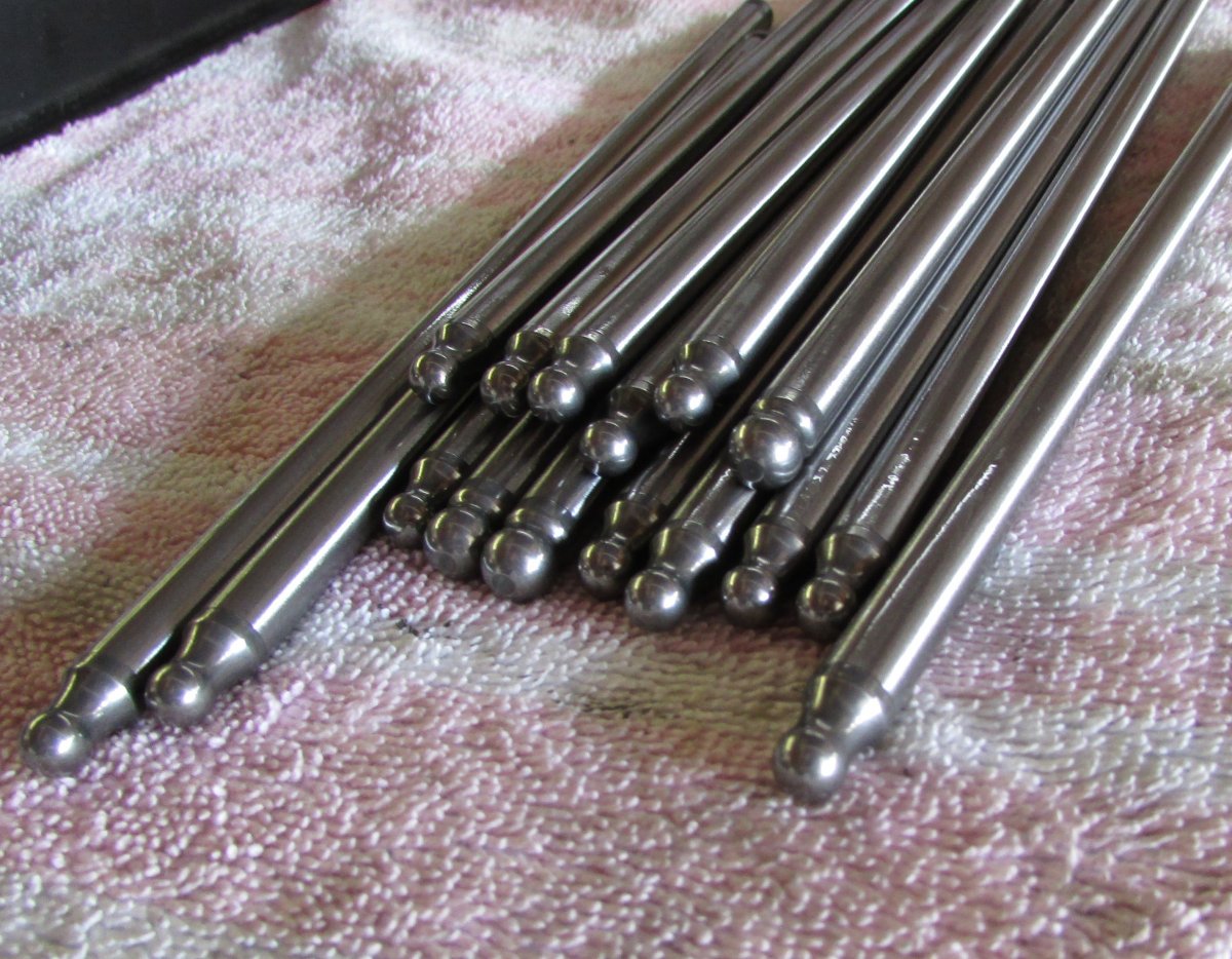

    IMG_2764.JPG IMG_2767.JPG IMG_2769.JPG So I got these super-go-to-Hell adjustable rocker arms. And since they mess with the original geometry, custom pushrods are required. Tedious and a bit stressful to ***ure my measurements are accurate. Pretty satisfying in the end 'tho,...***uming I haven't goofed.

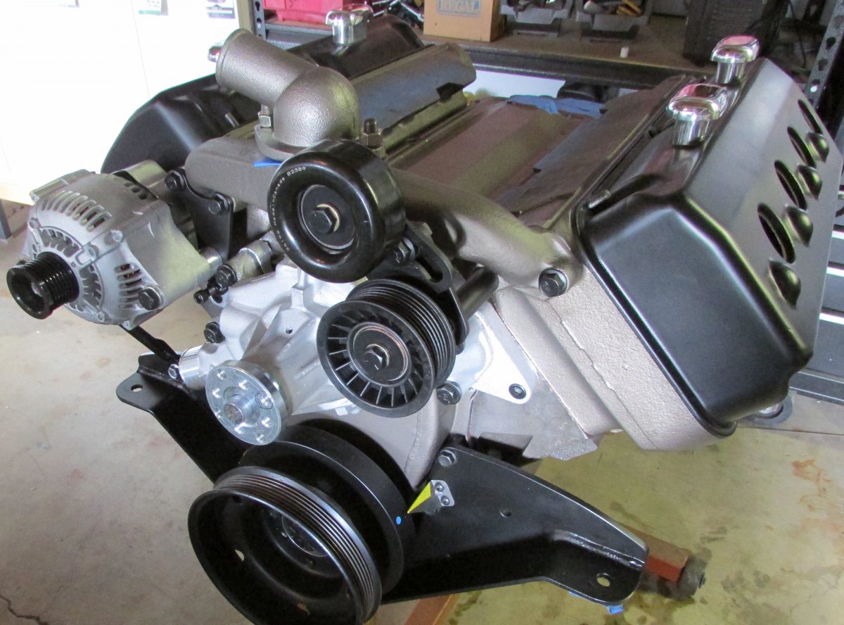

    In the meantime, heads got torqued,.....discovering 85 ft lbs is just about all this old fart can muster! IMG_2807.JPG
    and the serpentine hardware finalized, detailed and installed. Liken the way it's looking!

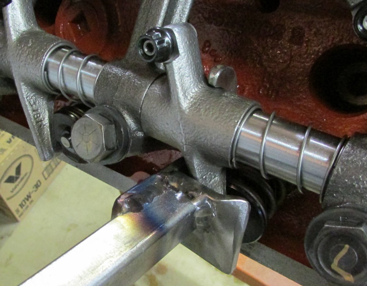

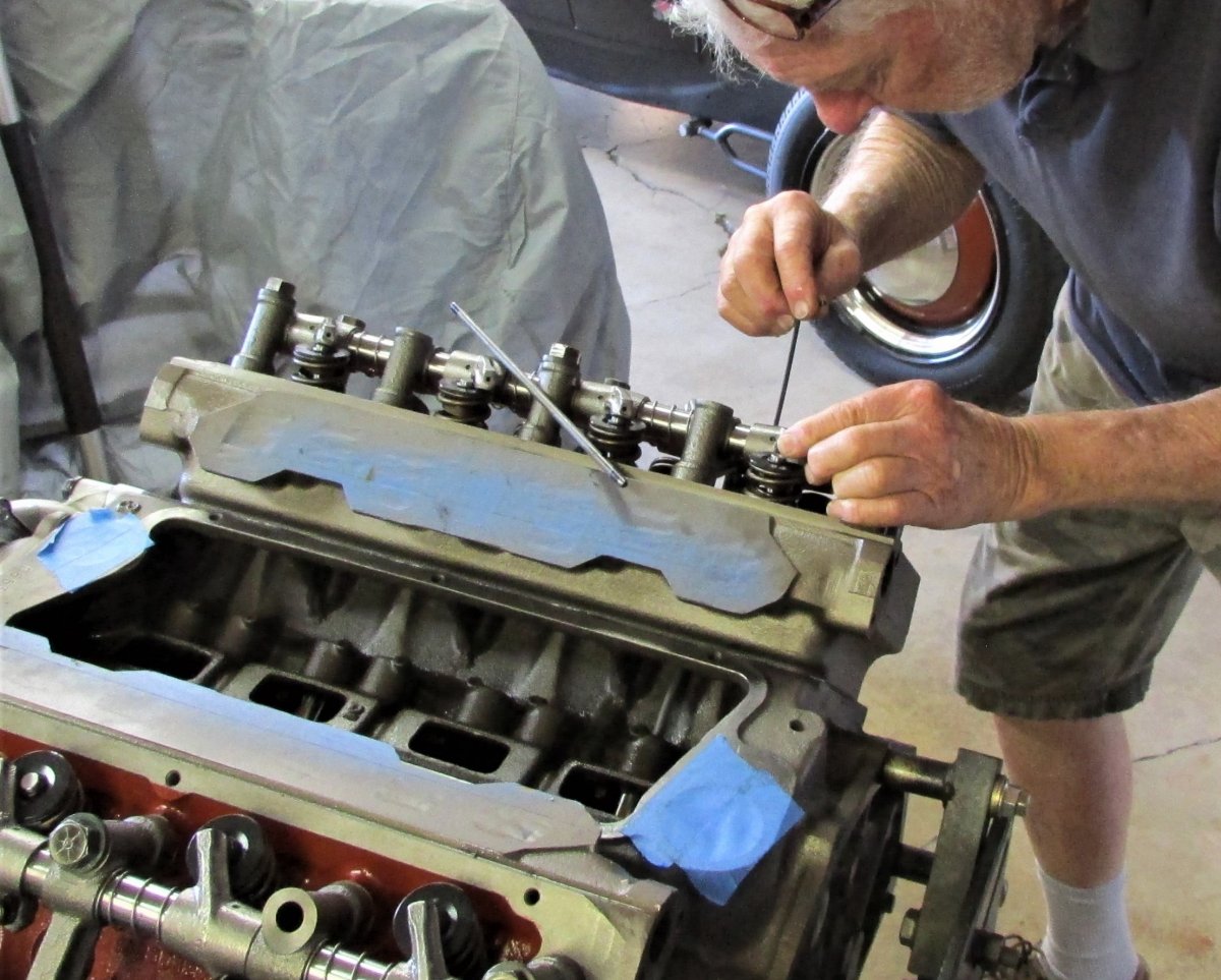

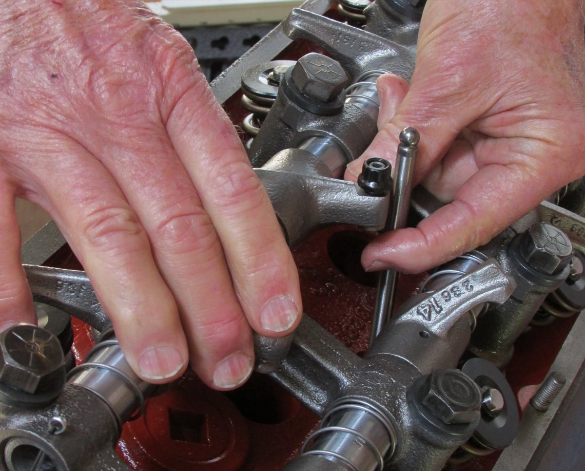

    Today was a very satisfying day. The rocker-arm rocker tool turned out just fine. Works on both intakes and exhausts.

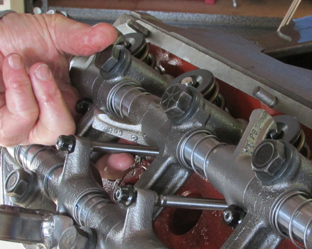

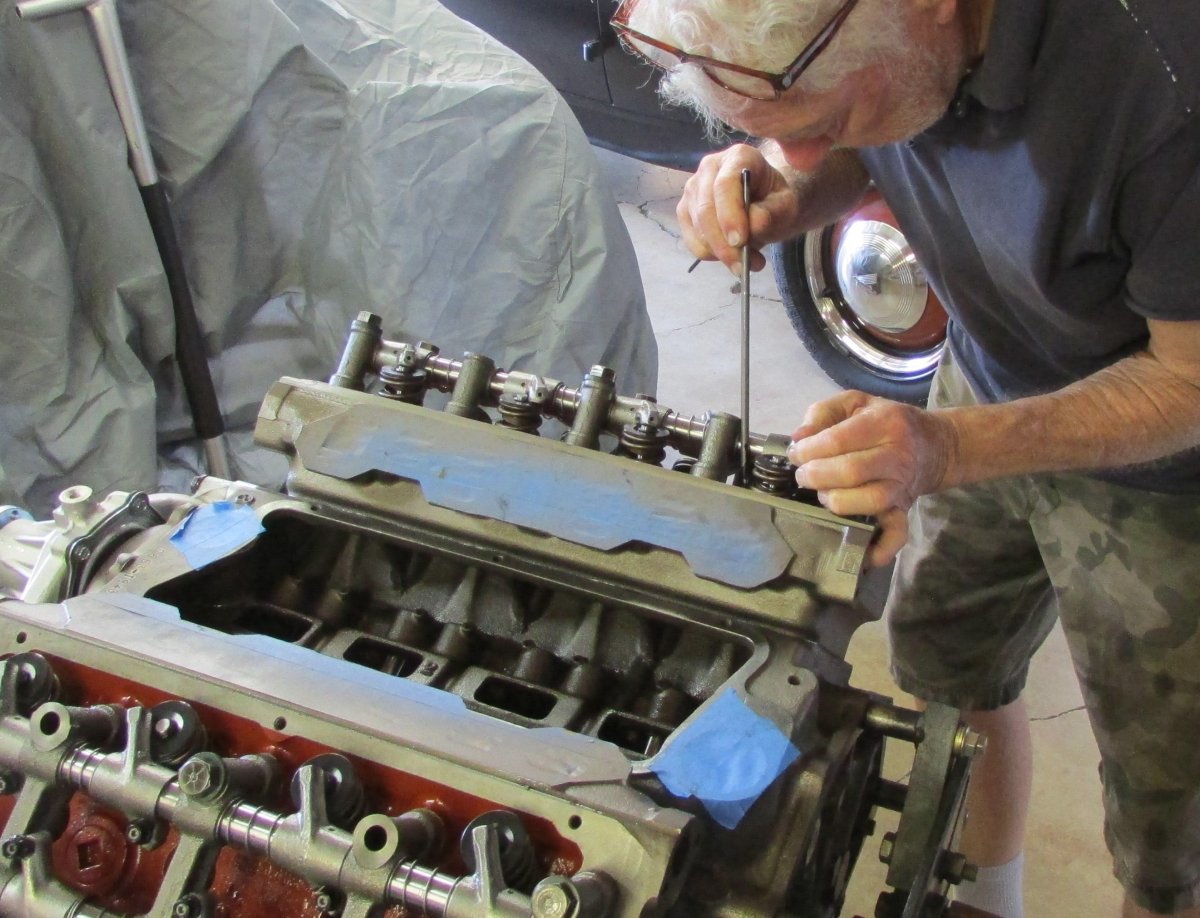

    More Christmas presents from our friend at QEC
    Man,...I dunno how anyone with big mitts could do this install and initial adjust.

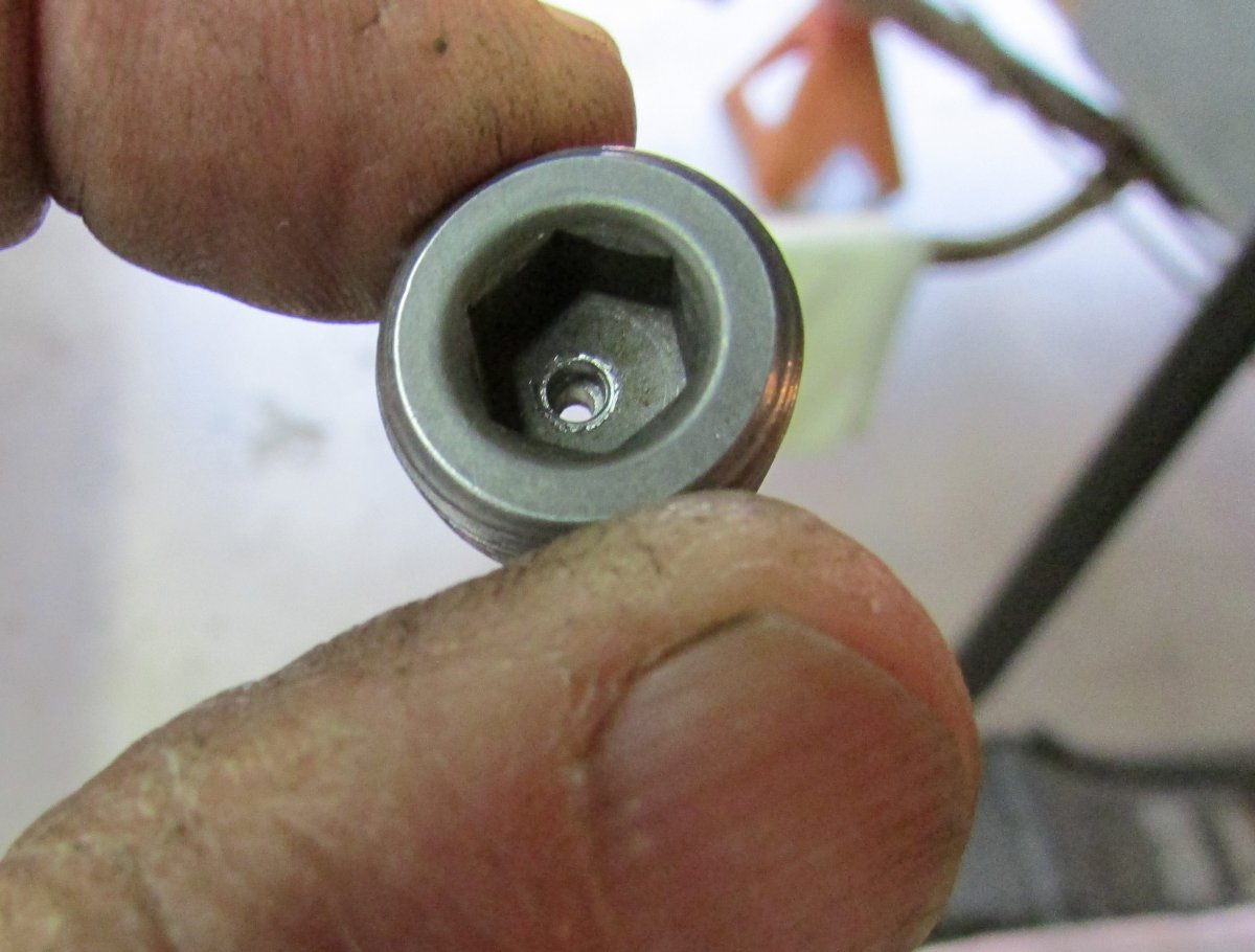

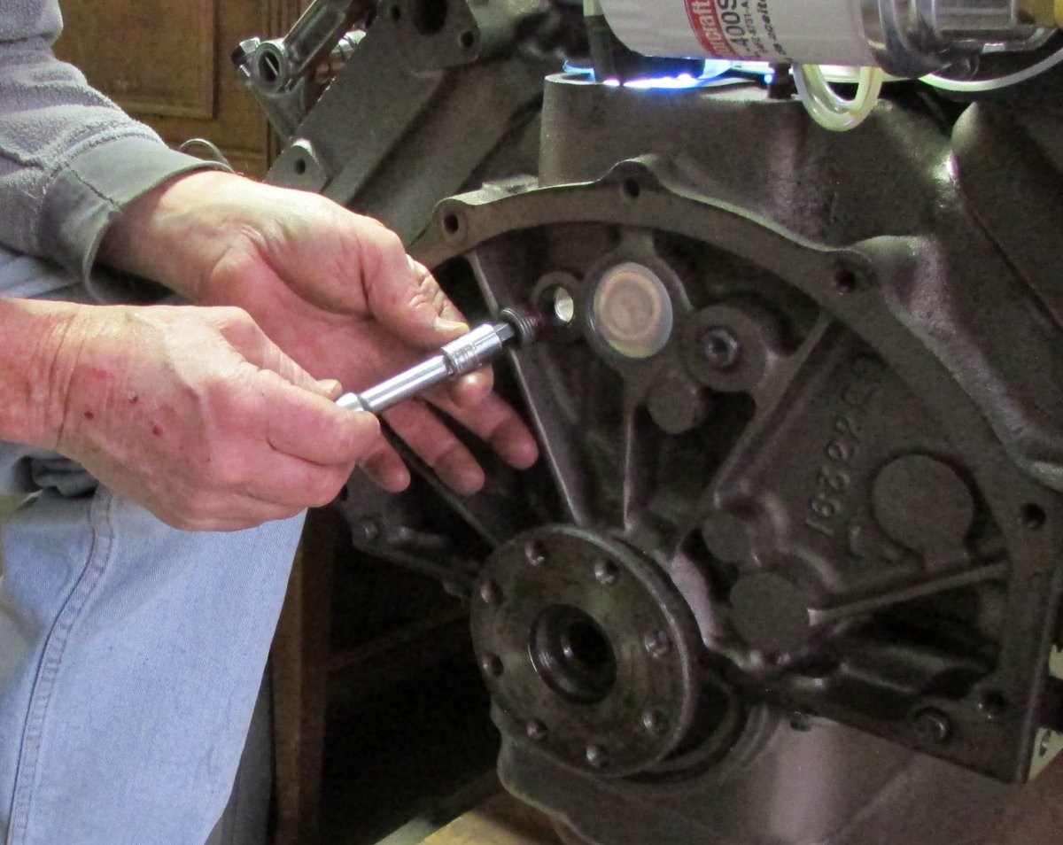

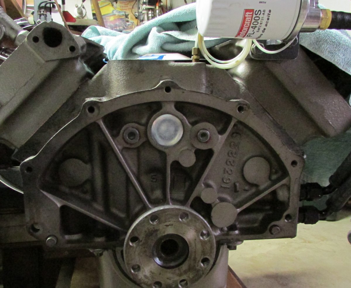

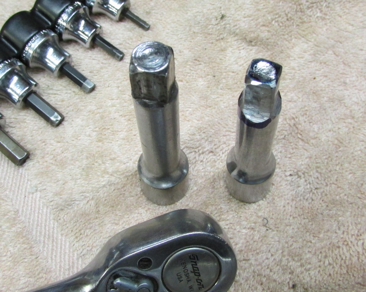

    Finally seeing a little daylight on this project. Got the engine off the stand so's I could access the bell housing surface. One task I was really worried I'd forget was drilling the galley plug that is buried behind another plug on the bellhousing surface.
    That plug, which was mentioned several pages back, defied my attempts to remove it, and due to the fact that it was a 5/16" female square and I was ignorantly trying to remove it with a 3/8" square extension. So today I molested a perfectly good 3/8 extension in order to get that SOB out so's I could drill it.
    Sooo,....after ****in around for several minutes trying to engage my custom plug wrench,.... unsuccessfully, I looked in the hole to discover the machine shop had replaced the original square drive plug that stumped me, with a hex. Well ****! Anyone need a 5/16 square drive extension? IMG_2955.JPG IMG_2966.JPG

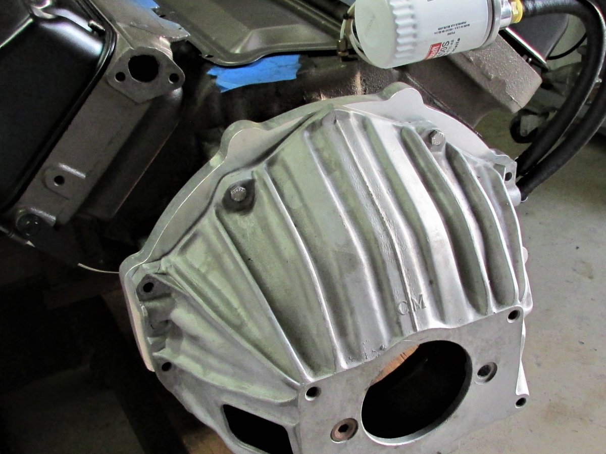

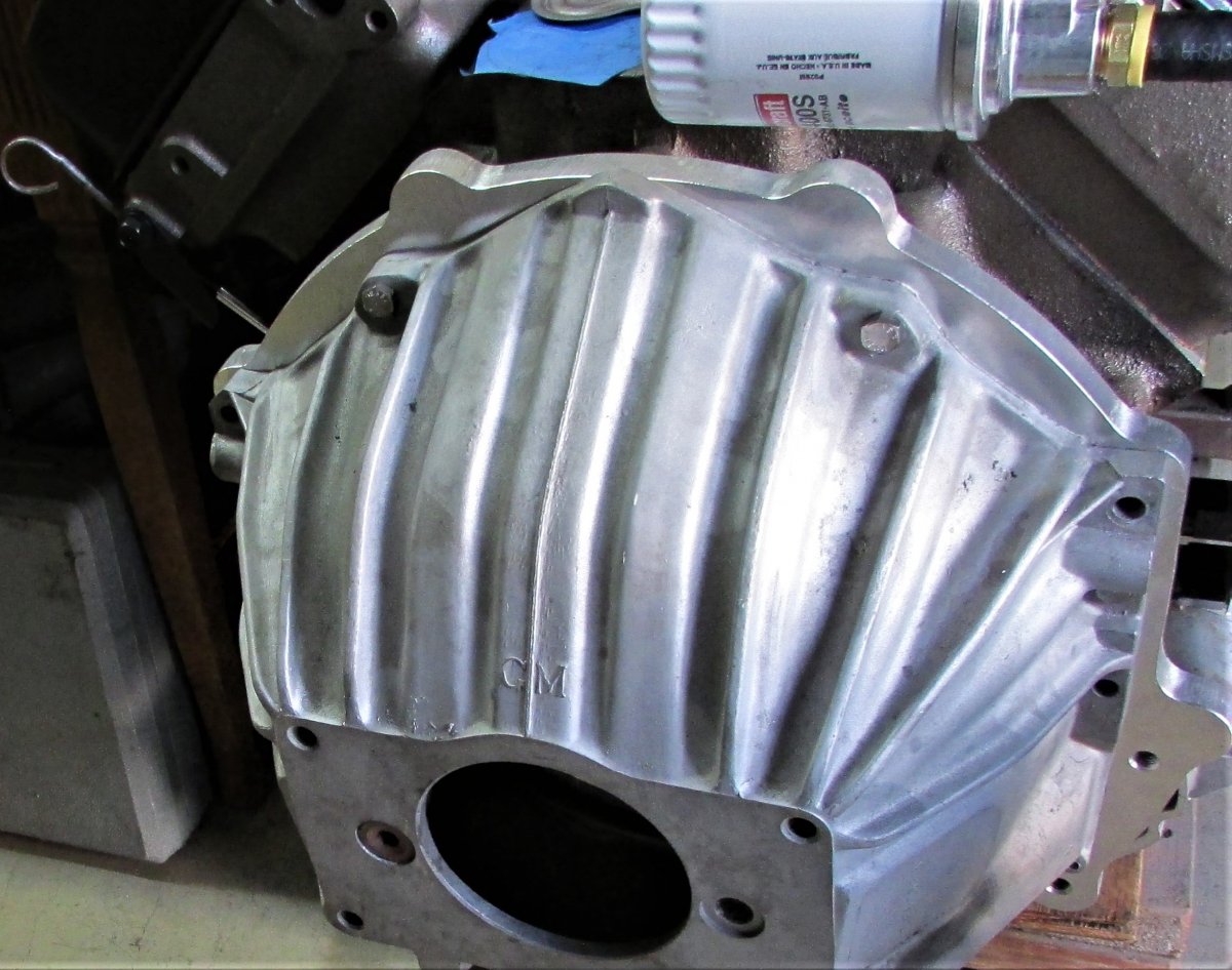

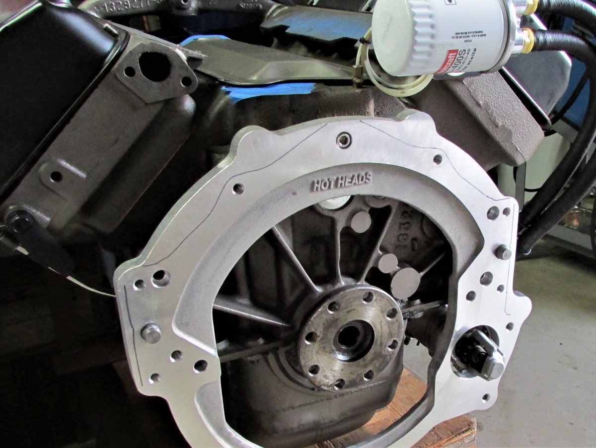

    Picked up my clutch and flywheel from the balance shop this mornin and was excited to start puttin stuff together. First hiccup was no one had any pressure plate bolts. Soooo,....dammit, I decided to trial fit the adapter and SBC bell housing.
    A bit of a miss-match I'd say. A lot of material that can be trimmed away, making the bell housing area more svelte and space efficient for installing in the Model A.
  20. swifty
    Joined: Dec 25, 2005
    Posts: 2,707
    swifty
    Looks like that adapter suits a few different models. Does the outside profile match the big Hemi?
  21. patsurf
    Joined: Jan 18, 2018
    Posts: 3,403
    patsurf
    pretty smart pattern maker!
  22. SEAAIRE354
    Joined: Sep 7, 2015
    Posts: 556
    SEAAIRE354
    Do you know if the Chevy bell line that you traced out is bigger than the hemi pattern? It would be shame to cut the adapter to find that some of the block had a bigger OD than the bell housing and wound up hanging in the breeze. I’ve definitely made that kind of mistake on different projects.

  24. 73RR
    Joined: Jan 29, 2007
    Posts: 7,347
    73RR
    What do you call 'big'?
    All of the EarlyHemi, Poly and pre-62 A series engines all have the same bellhousing bolt pattern.
    It is unfortunate that when the machine work was being done that the profile was not cut to match either the bell or the block. As it is, it just makes extra work for the conscientious builder, like Mr Bill.

  25. wstory
    Joined: Jul 4, 2008
    Posts: 1,988
    wstory
    My understanding as well. All the extra flange area has some purpose I expect, but not important for me to understand at this time in my life. ;)
    And yes, it would be a shame to trim the adapter to discover voids between the two parts. Not planning to do that.

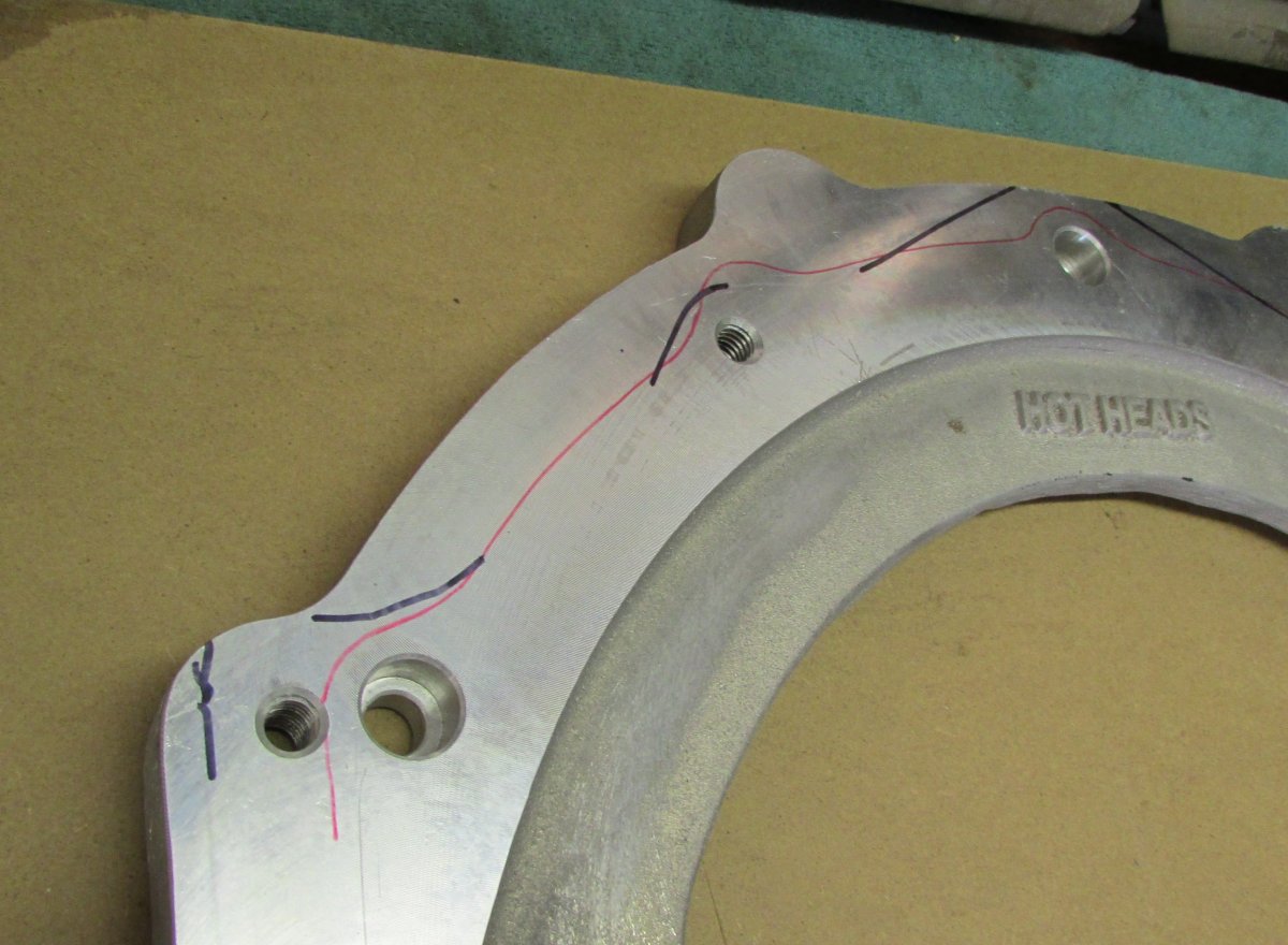

    Sooooo,....today, I'm making patterns of the two surfaces bolt patterns to guide in the molesting of my very expensive adapter plate. I'll do***ent.

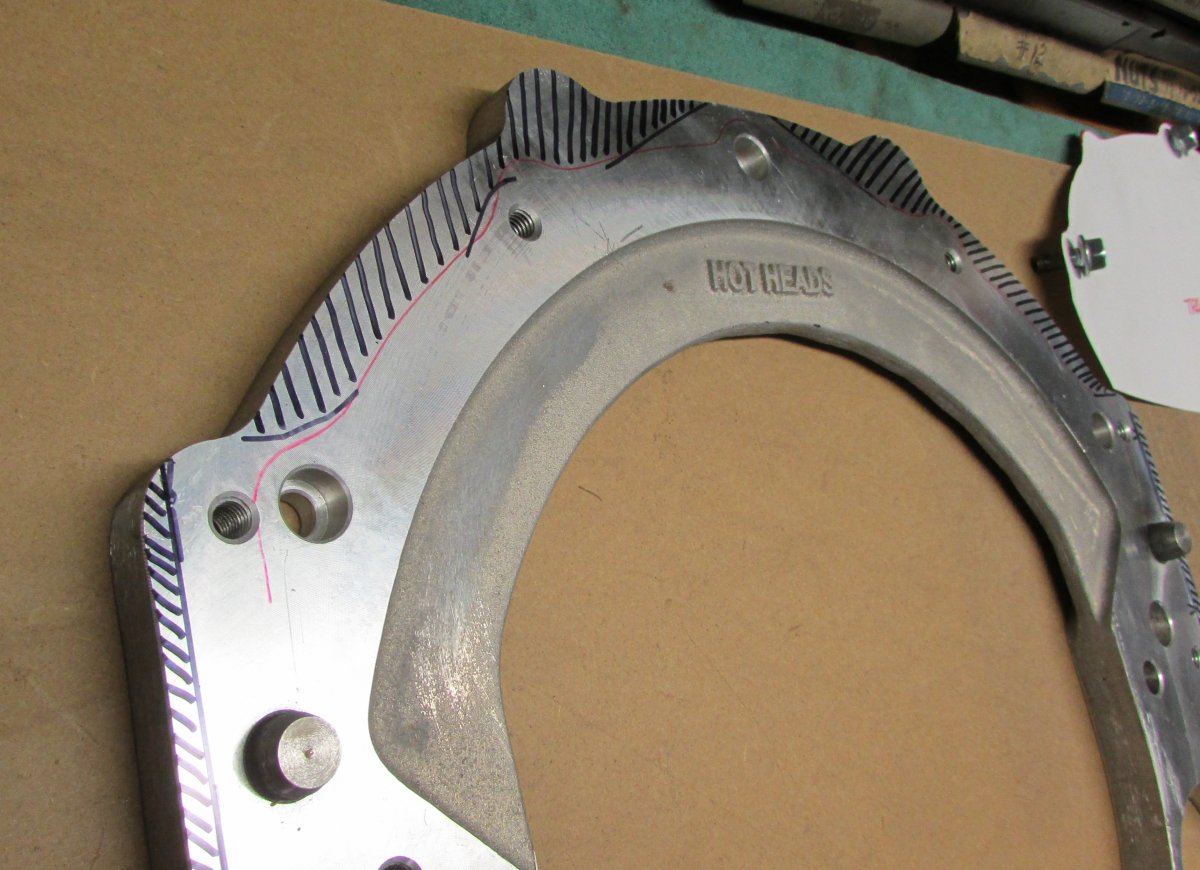

    The 3:00 am committee had trouble figuring out how to get the foot print of the Hemi bell housing transferred onto the backside of the adapter. Perseverance prevailed and today I attached some poster board to the bellhousing surface and traced the outline. Cut out that outline and transferred it to the adapter and then traced the trans outline over that.
    The red line denotes the engine outline. The black line denotes the transmission. Everything outside of those two boundaries gets whacked off.
    I'm a little nervous about making these dramatic cuts so I've decided to procrastinate until tomorrow and have a gl*** of wine,....or two :rolleyes:

    Bit the bullet and took the bandsaw to the adapter.
    The areas of the adapter that are "proud" of the bellhousing match the back of the block. Still gotta figger how to finish the edge. It's bandsaw "course" now.
    Trendz,....the adapter measures .745" thick.
