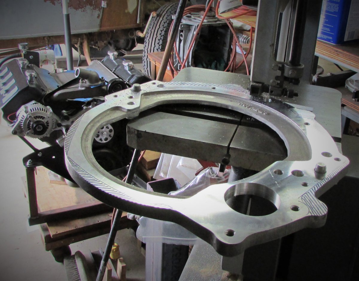

    I think I would start with 50 grit roloc sanding disc, some hand sanding and then finish up with scotch brite.

    Nice job Bill. When you look at it from the front of the car all you'll see is the outline of the block.

    A router around the edges?

    Awesome work. I have a little drum sander that would work great for something like that. Love the progress

    I use an oscillating spindle sander for similar work.
    A 36 or 50 roll would cut aluminum pretty fast.

    In retrospect, it's seems a more elegant attack on this aspect of the project would have been to make a pattern and let that guide a router. I'm good at that,.....i.e. 20/20 hindsight. I did however step up to a spindle sander. That was a just an okay solution. Power sanding aluminum just doesn't work very well but it got the job done along with other techniques, like draw filing, rotary files and scotch brite, for movin metal.
