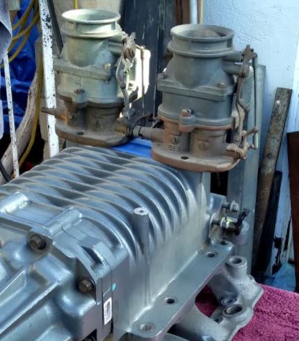

    With your fabrication skills why could you not come off the blower where you have the two carbs pictured? Replace.JPG
    Think of a Rams Horn sheet metal fabricated intake with the Webbers as originally intentioned. I can't even draw what I am envisioning but you Sir could build it. The Webbers could face either straight forward or off to either side while dropping them down to help with hood clearance.

    ^^^^^Right on... side draft Webers or DeLortos. Used both, very 'tunable'...and parts availability second to none. Manifolding only prob? Not for Mr. Bill... Oh, Nooooooo!!!

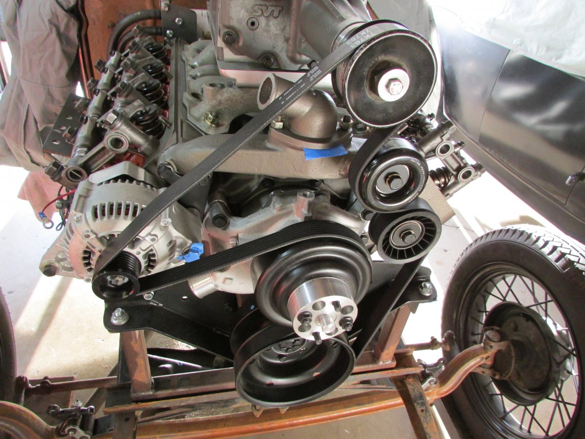

    And re the blower chapter,....first iteration of the modifications got me about 80% of where I want to be. First, I'm not happy with the appearance of the extension and second, that piece is about 3/16" too long. The body of the blower can also be slide to the rear another 3/16" to get the belts to align on the pulleys and a more balanced appearance.

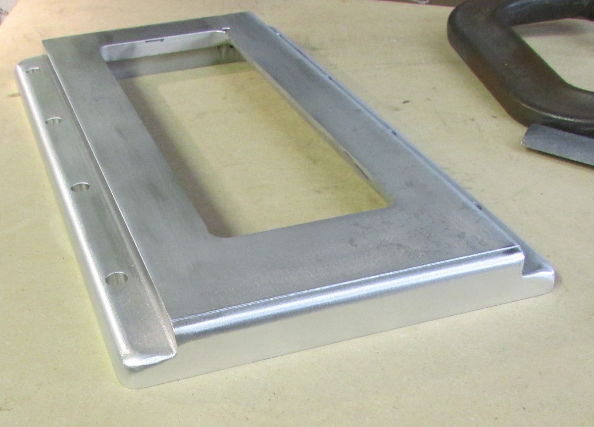

    Got the manifold adapter plate resolved. Knocked the corners off with a router and wire brushed it to get a "cast" appearance.
    Holding the adapter to the manifold after the pulleys were aligned was a challenge as there was no access to the interface for pinning or tacking, with the blower in place. Soooo,....."wicked in" SuperGlue from the outside to hold the plate and manifold together,....and then I could remove the blower to access the area to tack the two pieces together. IMG_3211.JPG IMG_3227.JPG

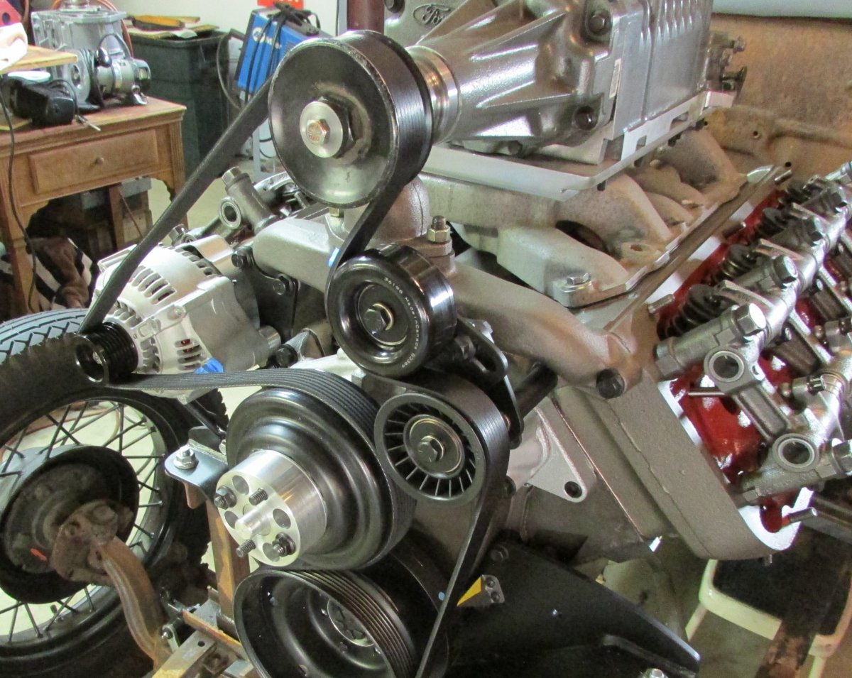

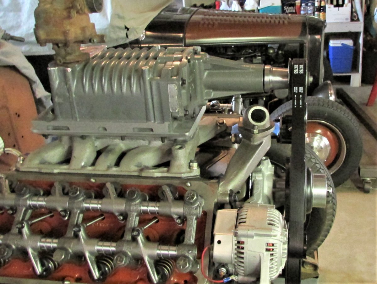

    Finally got the pulleys aligned and the appearance of the extension resolved. Taking some comfort in how the whole ***embly has come together.
    Hooked up the starter last night to spin the engine and visualize how the serpentine belt tracked. Cool!!!!!!,....except that the freakin blower pulley wobbled :(-:eek:-:mad: So today I start takin things apart to find the offending component.

    Everything. The blower adaptor, front extension, water crossover, serpentine belt system, all look as if the factory did it that way. You Sir have a definite eye for the aesthetics and the know how to accomplish them. Wobble in the blower pulley is just a minor hiccup that you will overcome.
