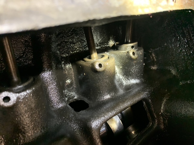

    Hi everyone. I am looking for a little help with the engine in my 55 Dodge truck. I have been searching the threads for some good info on my poly head, but can’t seem to find what I am looking for, and hopefully someone has had experience with the valve train. (Where I think the issue lies) I have had it for about 12 years, and bought it from the son of the original owner. According to him, the engine had never been out, and is original to the truck. I have been driving it during the summer, and it has been running great. All of the sudden, it developed a marked power loss, with some backfiring and noisy ticking in the top end. (I believe) I pulled it into the garage and pulled off the intake, valve covers, and valley pan, looking for a possible bent push rod. They all look ok, and spin freely on the lifters, except the drivers side very front of the engine lifter. It looks as if it is protruding from the block about 1/4 to a half inch further then all the others, and the push rod has pressure on it. Question being, as I am slightly unfamiliar with the poly, should the lifter be more into the block? I don’t see anything else that could point me in the direction. I believe it is a 241 poly engine, i have some pics of it. Thanks for any help with the ol fella.

    Sounds like the cams flat. look at the lobe under the lifter that's up...

    That PR also looks to be at quite an angle. Is it sitting in the rocker arm properly? Might be the angle of pic?

    what happens when you turn the crankshaft? Does the lifter eventually go down, and another one or two move up?
    like what happens in any engine when it's all working right?

    Hi, thanks to everyone who took a sec to give me some info. I don’t think the cam is flat, I had that thought myself, and although I just tore it down, I have not spun the motor over yet. I had a little time last night after work to get at it for a little bit, and hopefully can make some more time this weekend. The push rod seems to be seated correctly, but I will have to look again to see if the lifter drops and another comes up. But it is the only one in the whole valve train sticking up. The problem started out of the blue. In early December, a friend that is a photographer asked if she could borrow it for the day for a Christmas shoot, and I trailered it there because the roads were slick, and it started when I pulled it off the trailer. Otherwise, it leaks all over the place, smells like gas and oil, leaks from the diff and trans like a damn near 70 year old truck should! I will find some time this weekend after work, but should it need pushrods or possibly a lifter or two, anyone have a decent parts source? Or leftovers from making a hemi from a poly? Thanks again for your help!

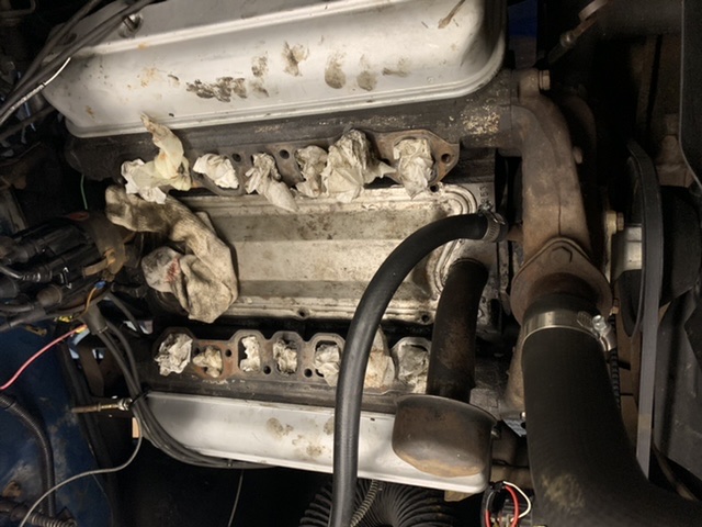

    Hey everyone. Got out to the garage today, and spent some time with the poly. Honestly can’t see anything at all wrong. Spun the motor over with the starter quite a few times, absolutely nothing looks amiss. As I spin it over I can see the lifters getting oil in the valley, but not so much up to the valve train, although it’s 15 degrees here and that oil is thick. Put the valley cover back in, gonna order some intake gaskets and run it again with the valve covers off and see what she does. The power loss stumps me, really thought I would find a valve issue. Keep ya posted….

    That pushrod area in the first pic looks dry as a bone.

    Hi. Update to a few questions…. Ba*****t.. the lifter I was concerned with, does move as normal, and they are hydraulic lifters I believe. Valve covers are off, and with the valve covers off and the valley pan off, I turned the engine over quite a bit to confirm everything looked ok in the valve train, and it seems to be ok. The engine has not been sitting for any real amount of time though, I drive it about 500-1000 miles a year, and the problem started right out of the blue. I wonder if possibly a lifter lost its hydraulics? I put the valley pan back on, I plan on ordering some intake gaskets, but as far as the valley, I really can’t see anything amiss. It’s definitely a mechanical ticking, it’s not fuel or ignition, and with lost power, I certainly would have expected a collapsed lifter, or bent push rod, but didn’t see either. The engine numbers I was wondering about also. I thought the p also denoted a Plymouth, but I find conflicting info on it, but the original owner swore that it had never been out, or rebuilt. It has 101,000 miles on it. I appreciate the help, and apologize if I don’t get right back on the thread, I work two jobs, and time to wrench on ol blue gets limited ✌️✌️
