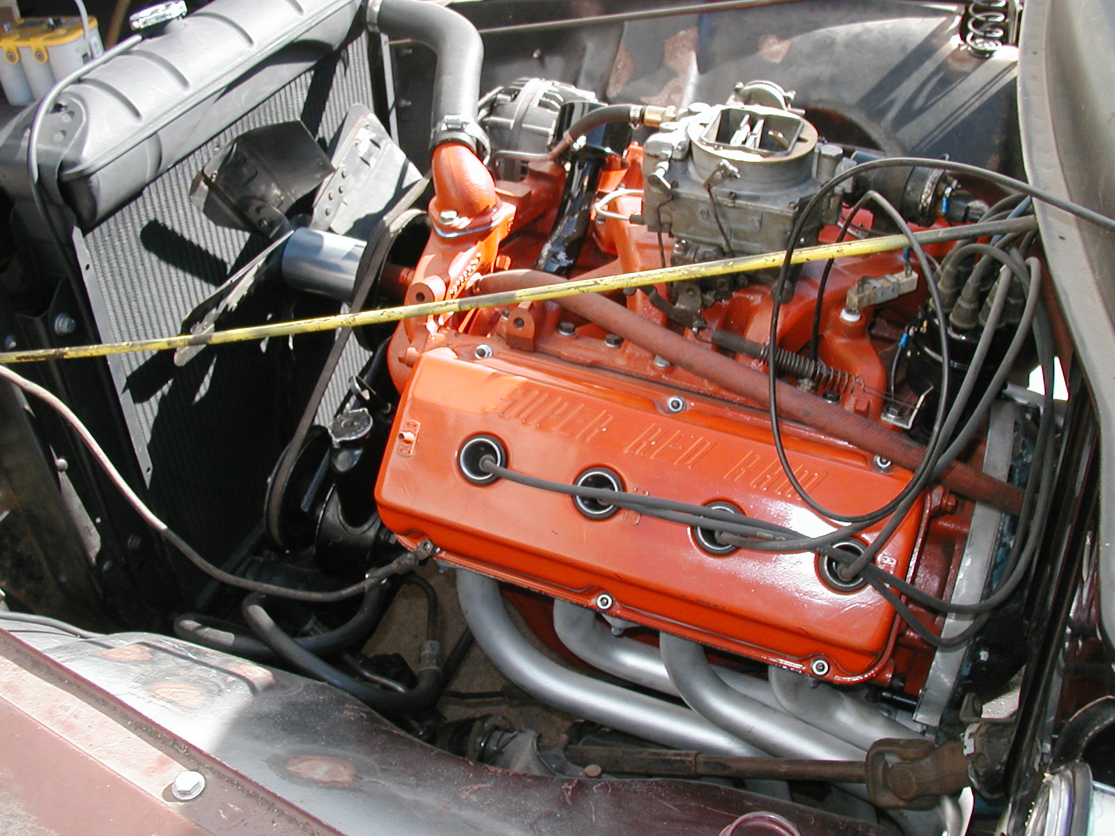

  3. I don't know a lot about Mix-n-Match of Hemi parts, but I do know when things don't work to figure out why. I believe this started life as a 55 Hemi and was built by a well-known Hemi/Flathead racer and builder machinist. In this photo it's all new insides and ready to light up and run in (or so I thought).

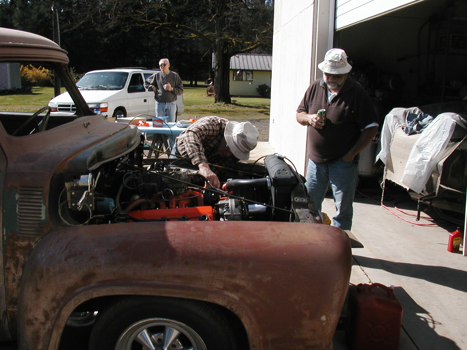

    Here's my builder and Friend trying to get things working together so we can run in the Camshaft and do a final tune. That's him messing with the Carb along with 2 other friends.
    That day was 100% non-successful. It was decided there was a Carb issue that couldn't be overcome that day. Well fast forward a few years and after having a Qualified Carb friend doing his thing I decided to once again try to light it up and run it in. After a couple days of W.T.F. is going on and talking with my different local machinist as well as the guy that ground the camshaft to start with it seemed it was time to do a teardown to get to the bottom of things. Flat Top pistons with Valve reliefs and .125 below deck, more commonly known as Poly Pistons and a head gasket that is .065 thick under a Hemi Head combustion Chamber just doesn't make enough squeeze to make a good Fart. It also only makes around 7 inches of cranking manifold Vacc and that won't **** fuel in the cyl's without manually closing the Choke to even wet the plugs. I had had enough, and My decision was to buy a different motor. My advice is this, if you're going to start mixing parts together that aren't designed to work together, you better know what you're doing. I thought I "had" the right Guy that "had" all the right information. Turnes out I only got Had!

    So, the combination resulted in 4.5:1 compression?

  13. [QUOTE="Hnstray, post: In all cases, to the best of my knowledge, pistons must match the head design being used.
    [/QUOTE]
    There's a lot more to the Hemi game than using parts that fit together. In my case all my pal Earl had to do was a simple C.C. job if he had any doubt. I know he wasn't doing his first Min-n-Match build and had blind faith in his ability to do tis right. I didn't set a budget or tell him what to use or not to us. Yes, HEATHEN I believe it's down there around 4.5 to 5 to one compression. Even is top shape this little C.I. motor won't do the job I want done. That's the main reason I moved on. The little 270 motor will be just fine in a Roadster or a T but not in my Highway driving Truck. I felt the new 57 355ci will be a much better final unit.

  21. My friend Earl was a well-seasoned Mopar guy all the way around. He knew this, and/or new where to find the info as well as knew how to check the c.r. before bolting the heads on. I never had any reason to question any of that. The sad ending for him is that he's in a full care facility with deep seated C.R.S. It's been terrible to watch.
