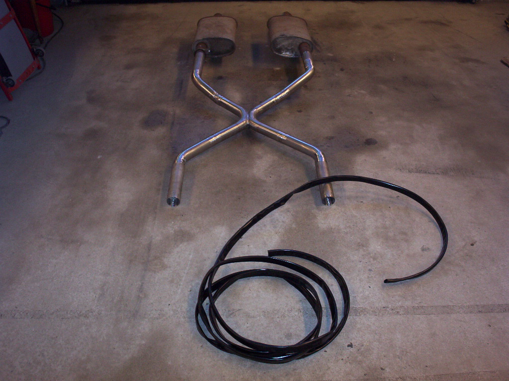

    rear trans mount fabricated and moved park brake wire mount .xpipe fabricated
