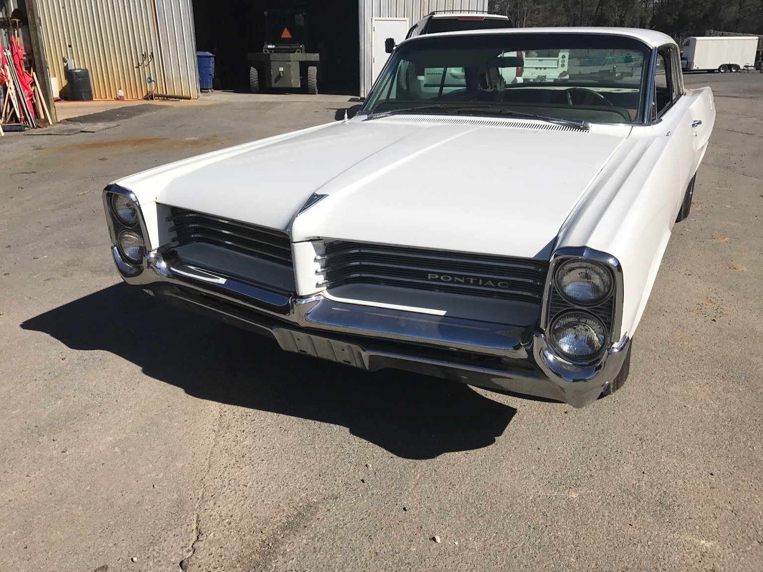

    My Catalina runs and drives right now. Planning on going to Poci event in Ga. on May 5&6.
    It needs body work and rust is bleeding through the paint but in time it'll be right.
    [​IMG][​IMG]

    Jeffrey, received, and responded to your PM. And that is a pretty Pontiac!!!

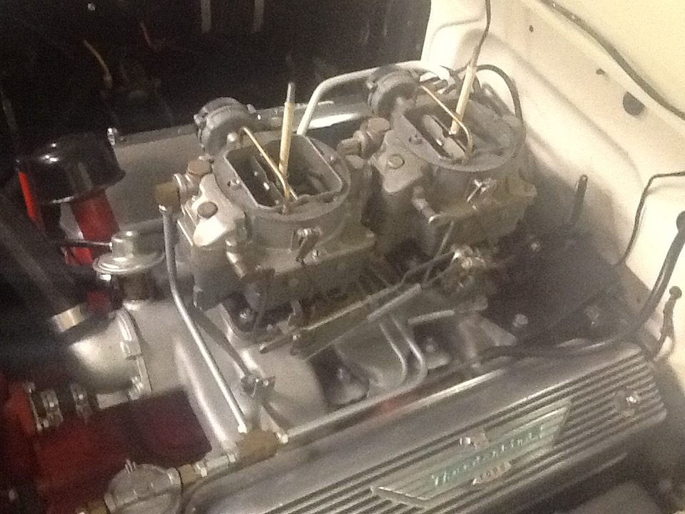

    image.jpeg Dual quads look better than anything else on the market... If you like um .... run um.
    jeffs64cat likes this.
