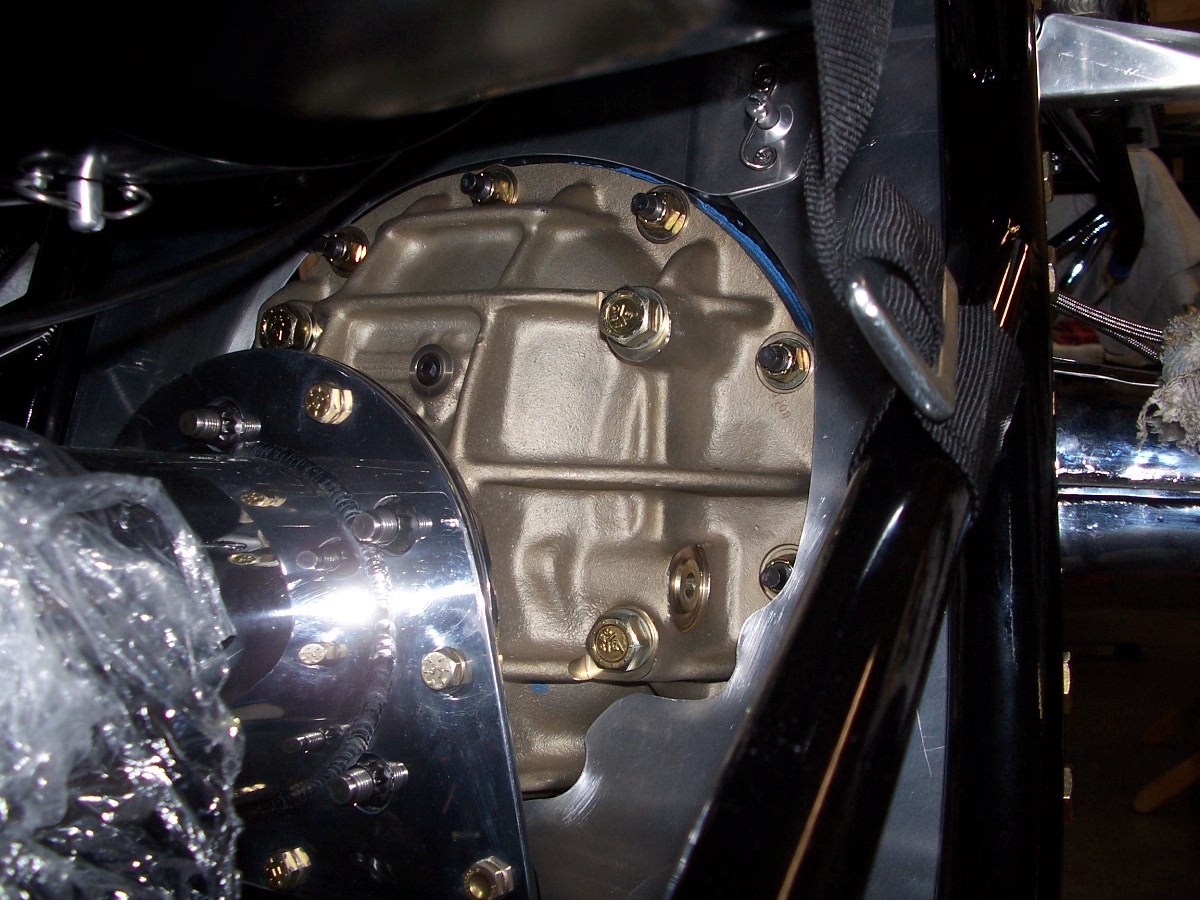

  24. dreracecar
    Joined: Aug 27, 2009
    Posts: 3,476
    dreracecar
    from so-cal
    Glenn Ways "GROUNDSHAKER" restoration has a Ford 9" fitted in a big Olds housing. 100_1668.JPG 100_1637.JPG

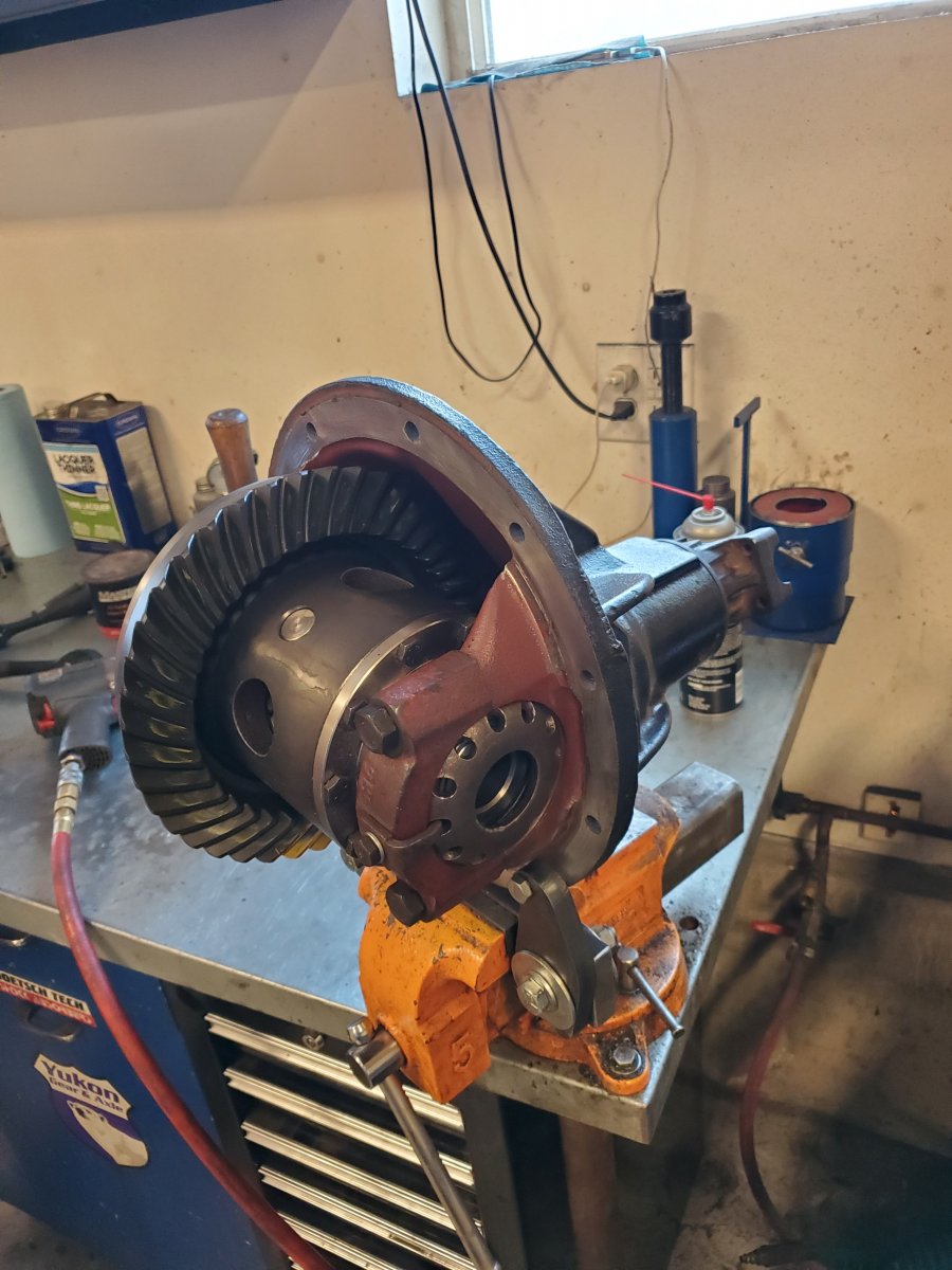

  25. -Brent-
    Joined: Nov 20, 2006
    Posts: 7,850
    -Brent-
    Here's that posi. Not all that much to see. I haven't run it, yet.
