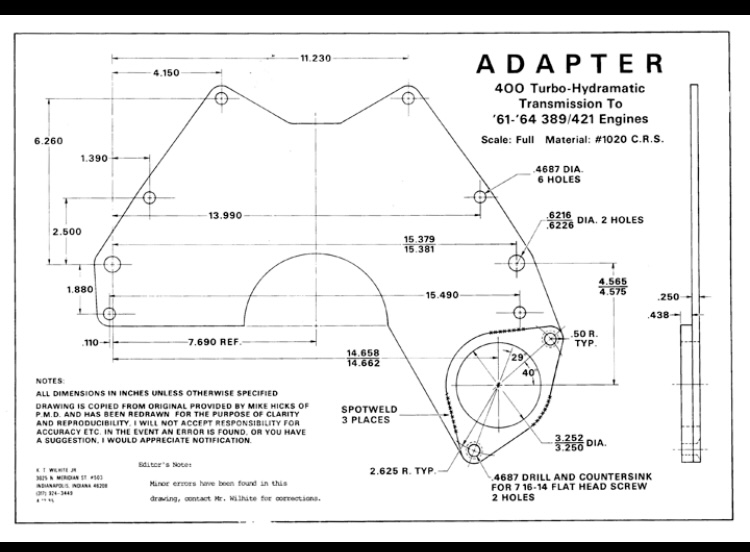

    I’m looking for a picture, pdf, or drawing with the dimensions for the 1959-1960 Pontiac bellhousing bolt pattern. I have an adapter that fits the 1965 and later Pontiac engines to a Chevy TH400 but I’m wanting to add a couple holes to install the TH400 on a 1960 389. I’m aware of the starter issues, this adapter already has a provision for the trans mount starter. I just need the dimensions for the 1959-1960 block dowel pins and bolt holes, I intend to add those holes to this adapter with a milling machine. I already have the drawing that’s attached, it’s for the later engines, need one for the earlier 59-60 engines.

    You may want to use a BOP version of the TH400 with the adapter shown. The two top bolt holes match the 55-60 Pontiac V8's bell pattern. Use those with the early bell housing to derive the other holes needed.

    Follow up. I took the transmission adapter that bolted to the back of the earlier 59-60 engines and set it up on a milling machine this weekend. This is the adapter that Pontiac installed to mount the early transmissions, it’s about 3” wide. Using the digital readout I recorded the XY coordinates for the block dowel pin holes and the transmission bolt holes. As d2 Willy’s stated above (and thanks), the top two holes are in the same location as the later engines, so I’ll only need to transfer the two dowel pin holes, (which measure .500”, compared to the later engines .625” dowel pins) and the four lower transmission bolt holes. Interestingly, the lower transmission bolt hole that sits above the starter mount is closer to the center of the crankshaft than the other one. Not sure why Pontiac did that but I suppose they had a reason. I plan to install the adapter on the bed of the milling machine this next weekend and drill these holes if I have time. I’ll also need to counterbore the adapter plate and install two stepped dowel pins to locate those in the TH400 transmission holes. I know I could have purchased an adapter that would do this but I would rather have the satisfaction of building my own, even if there are a few headaches along the way. One other item I’ll need to address is machining the end of the early crankshaft to a larger ID so the torque converter nose will fit. I’m in the beginning stages of rebuilding the 1960 389 so the engine and trans should be in the 63 GP by Spring of 2025. The car had not run for 35-40 years so I was surprised the old Roto-hydramatic still worked but it’s held up in the few hundred miles I’ve driven it. It’ll be off to the storage shed at some point this winter, probably never to be used again.

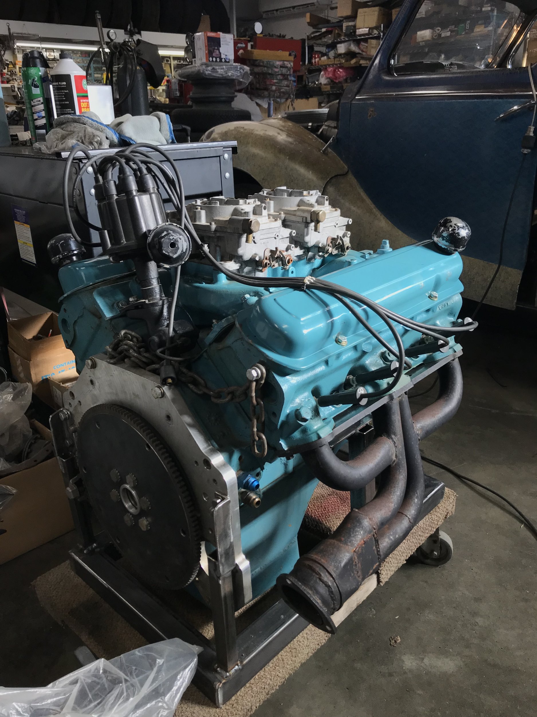

    Ohhh, your adapter is different from the ones I have. Mine are approximately 5/8” thick aluminum. Good thing is, these days you can lay out another one with the changes you need and have it cut by laser or water jet. You could even make it from thicker material if you want. I hadn’t seen one like yours until now. Here’s mine on a ‘59 389.

    That’s a pretty mean looking 389, are the intake and carbs from an engine of that era?

    The Edelbrock intake, AFB carbs and fuel injection distributor are the ones installed back in the ‘63-64 time frame when the engine was originally built. It supposedly has a M/T stroker crank and a roller cam. I’ll need to open it up to verify that. It was “freshened up” a few years ago. No major parts were replaced, just resealed and a valve job I was told.
    This engine was built and installed in a “sister truck” to mine. Carman Pisano, owner of Wedge Engineering (****tershields) built three similar Studebaker pickups at the same time. Two were Pontiac powered and one had a 413 Mopar. They were seen regularly around my hometown when I was young. Two of them survive today, the two Pontiac powered ones. Unfortunately one was updated with a more modern drivetrain.
