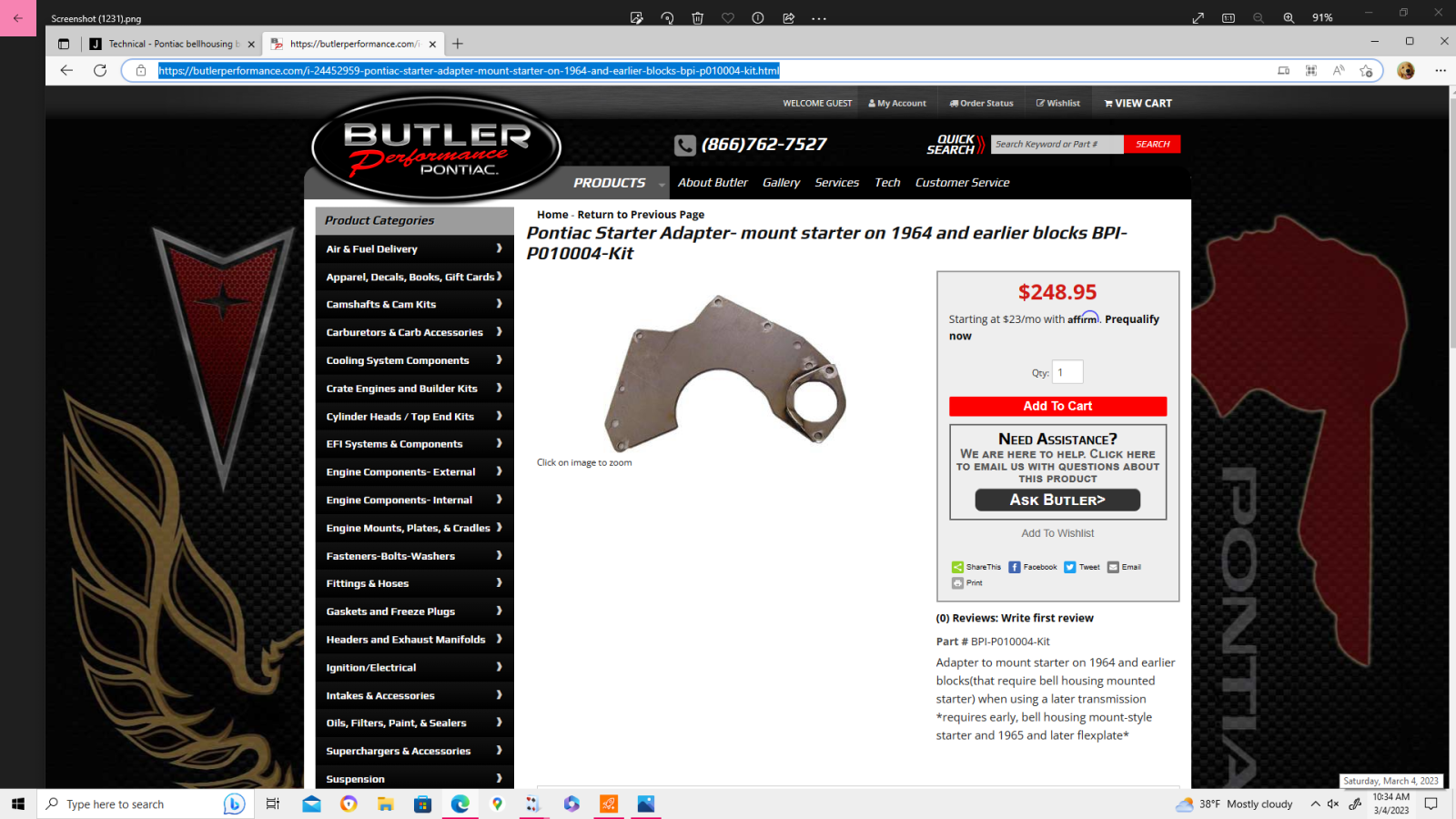

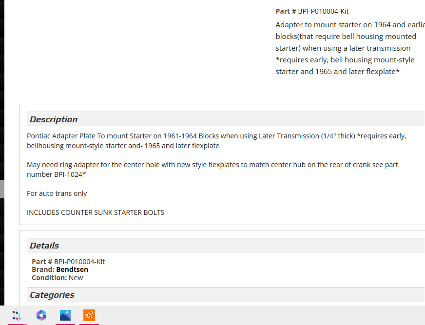

  14. Mr48chev
    Joined: Dec 28, 2007
    Posts: 36,079
    Mr48chev
    Dang, I finally read that enough times and drank enough coffee to figure out exactly what you were asking.
    This might cause you to drink Cheap adult beverages for a couple of months but isn't a bank breaker.
    I'd contact them and make sure though. https://butlerperformance.com/i-244...-1964-and-earlier-blocks-bpi-p010004-kit.html
    It won't work with a Chevy transmission case though you would need a B-O-P case that has the starter bulge on both sides.
    bchctybob likes this.

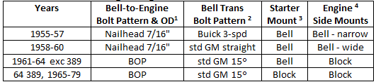

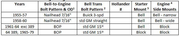

  19. gtofever
    Joined: Jul 4, 2024
    Posts: 1
    gtofever
    Pontiac V8 Bellhousing Designs
    1 Buick Nailheads used a half-circle bolt pattern. BOP used a "twin-peaks" bolt pattern.
    2 Buick 3-spd trans pattern (wider at top) fit M11 Light-Duty, M13 Heavy-Duty, etc.
    Std GM bolt trans pattern (wider at bottom) fit Saginaw/Muncie. Pontiac tilted trans 15° to
    driver.
    3 All 1955-63 starters mounted on the bellhousing. All 1965-79 engines had block-mounted starters.
    In 1964, all 326/389 blocks got a drilled & tapped starter pad, but ONLY the A-bodies
    (Tempest/Lemans/GTO) used a block-mounted starter and an aluminum bell; full-size Pontiacs used a
    cast iron bell that mounted the starter.
    4 Engine mounting tripod changed from "tricycle" to "taildragger" arrangement:
    1955-1960 a mount on each side of bellhousing, and one on block nose.
    1961-1979 a mount on each side of block, and one on transmission tailhousing.
    GMC offered the Pontiac V8 as an option in its 1955-59 1/2-3/4 ton pickups.
    Pontiac bellhousings fit 10.5" & 11" clutches, while GMC V8 bellhousings' bigger contour accommodates a 12" truck clutch. The GMC fork is a HD piece, and the fork opening is very different than Pontiac.
    Pontiac bells have a top inspection hole; GMC bells don't. Top & bottom covers are scarce.
