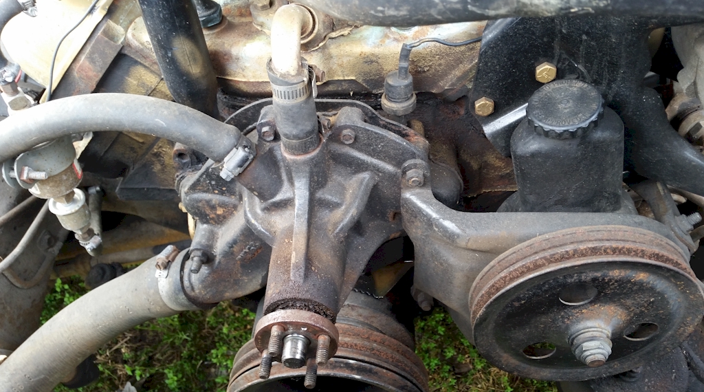

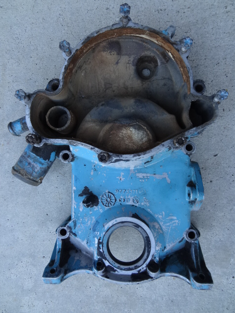

    Pontiac went to this style pump housing/timing cover in 1964. And stayed with it thru end of production of the genuine Poncho V8.
    By sheer numbers, there ought to be more manifolds/choices around for this one.
    You could, I suppose pick up an earlier cover & ***ociated cover to use the early style intake.
    In 1960, Pontiac went from reverse flow/gusher cooling to conventional. So from 1960 thru 1964, the intake/pump setup looked like this.
    The recirculating circuit went from the front of the pump to the thermostat housing via a U-shaped tube and short coupling hose.
    (I think I've got my years right)
