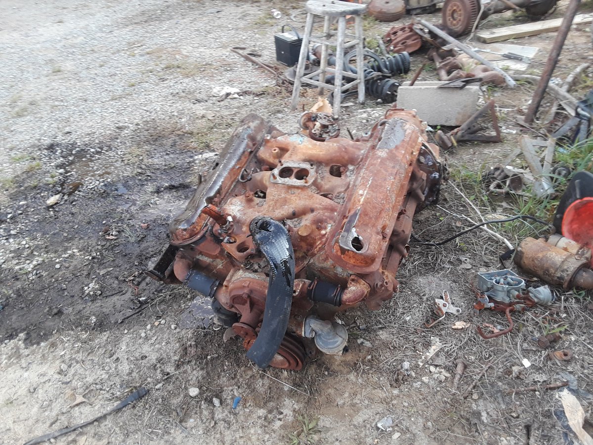

    This came out of a 58 Pontiac wagon. Its locked up. I don't know what it is or if it's anything more than s****. 20201002_165856.jpg 20201002_165904.jpg 20201002_165824.jpg 20201002_165916.jpg

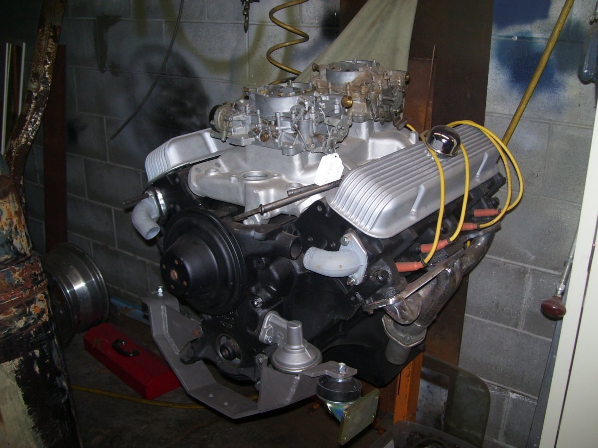

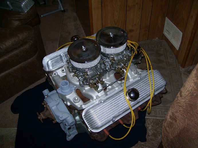

    Welp, it certainly looks like a 58 Pontiac [370] engine to me. I run one in my 34 ford and love it!
    If yours has been sitting in the weather for awhile it might never come un-stuck but I'd have to give it a try by soaking it in a transmission fluid/acetone mix after removing the heads. Who knows? Maybe it's a low mileage engine. You'll know as soon as you yank the heads and feel for a ridge at the top of the cylinders. 370ready.JPG 370inlivingroom.JPG

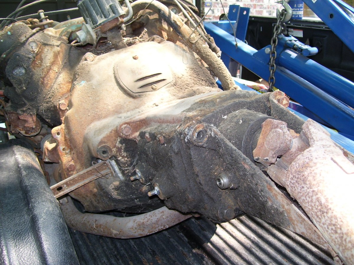

    That's just my opinion. Pretty much s****. If you can find a '58-60 Pontiac with manual trans you can use the clutch/flywheel/starter/bellhousing to put a modern manual trans behind the engine. Sometimes hard to find but anything from a T-5, 5 speed to an old 58-up original 3 speed. The photo shows a 389/Borg Warner T-85 3 speed from a 1959 Ambulance. I used the entire stick setup in my 34 behind a 370 Pontiac engine. I subs***uted a Muncie 4 speed in place of the 3 speed.... 389with3speed7_13.JPG

    You have a couple of hundred bucks there in the oil pan, gusher tubes, exhaust manifolds, oil pump core & Vibration dampener.
    Crank will fit a '57, so will heads.
