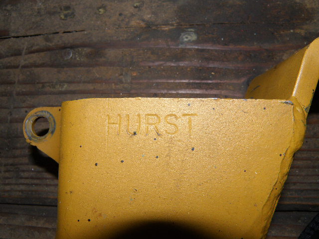

    Here is my frt mount that fits you ponti. Gary:)

    Whoa! Look at that...
    What is the application, exactly? Do you have pics of it installed??

    The Hurst mount is for the 55-60 covers, that's what I used on my 55 on my 66 389, i'm using a 60 cover . Which also needs the middle factory bracket.

    I think he means the factory Pontiac piece that is the front motor mount bracket. Goes from the bottom of the timing cover to the rubber mount bolted to the center of the Pontiac front crossmember. It's also supposed to be used [according to the Hurst instructions] when using the Hurst mount bracket..helps take the strain off the timing cover bolts when using the hurst mount bracket..
    I need one too. For a 55-58 Pontiac.

    YES! Was more interested in the factory piece.
    But now that everyone is posting Hurst stuff, the gears are turning upstairs. HAHA!
