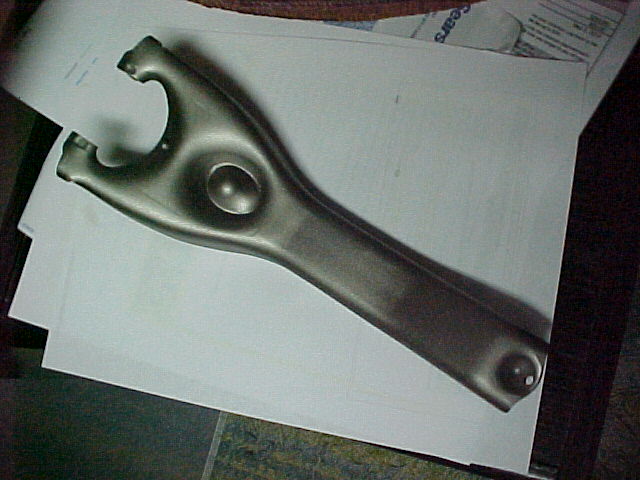

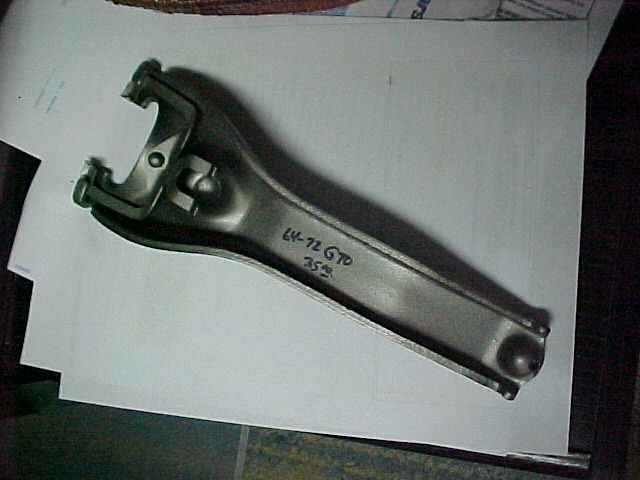

  18. miller
    Joined: Aug 5, 2006
    Posts: 526
    miller
    from New Jersey
    ....Take a look at www.bopengineering.com you will see the pan gasket and the rear main seal,...these are not cheap but I have them on the motor for 2 years now and no leaks...I will try to post a pic of the clutch fork...Miller[/QUOTE]
    ....pontiac clutch fork pics...
