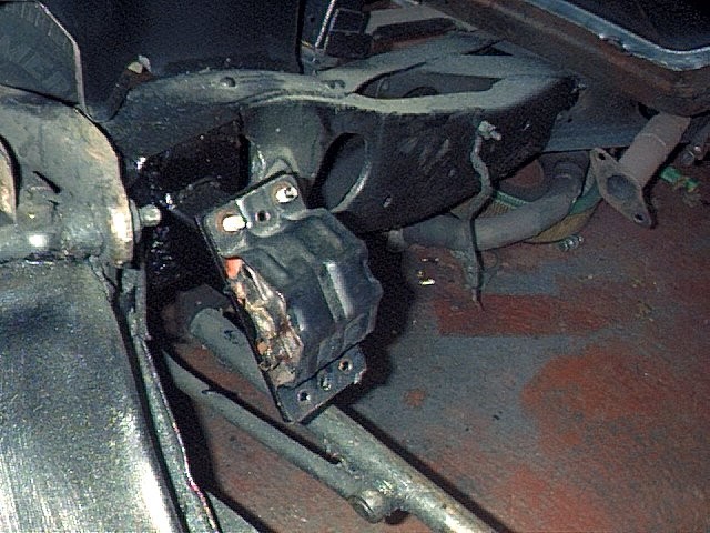

    My 49 Pontiac is set up for a Pontiac 400, I have been told all pontiac blocks are the same by some people. If this is correct and I get the motor and trans from a 1976 bonneville 455 will all the mounts line up? It is suppose to have the front clip from a camaro or trans am. This was done before i got it.
    What do you think?

    Should fit, if it was done right. Clip looks like an early 70s camaro.

  5. Well..... there is a little more to it than that.
    There are different mount patterns depending on the year, not the size.
    However, after looking over your picture, I see large pieces of steel welded to your crossmember. That is not stock, that is something someone did.
    I can only see the right side...I see a shadow where there was a 3 bolt mount bolted to it.... correct?
    Answer me and i will help you further.
    also a front shot showing both mounts would be helpful

    I will get some better pics for you.
    I also found new mounts in a box in the trunk.

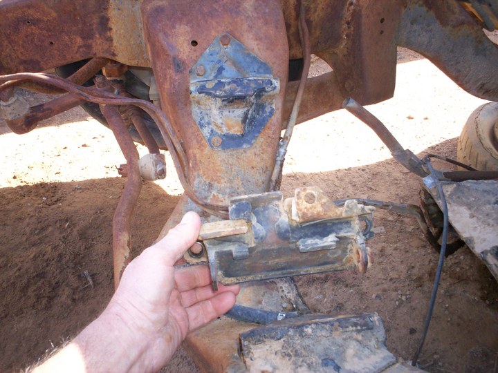

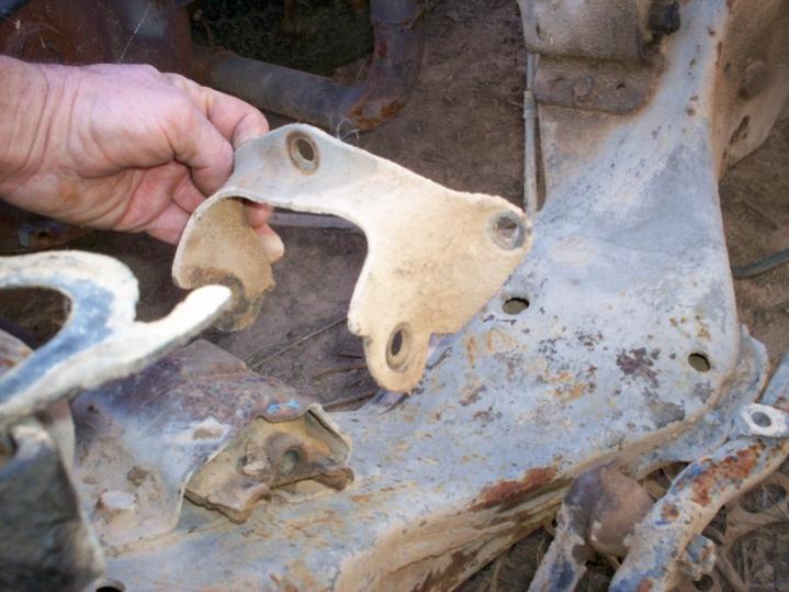

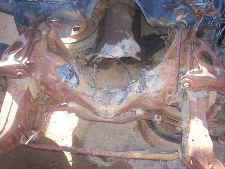

  25. Guys, please don't misinterpet me. I am not trying to be a 'know it all'. I am sure everyone here wants to help solve the issue and is sharing what they know is right...or think they know is right.
    I have about 450 old Pontiacs here including just about every model from 1955-1981 so I have this 'reference library' of real cars to look at.
    I took the time today to walk my yard, take pics, resize them and share them here for all of you.
    This thread is not about Pontiac motor mount interchange but, how to solve this problem so I will stick to that.
    As you said, you have a Firebird sub frame.
    What someone did was build steel mounts, or plates on your chasiss. Whether they knew what they were doing or not is up to question and we to not need to judge that.
    Firebird motor mounts and chassis brackets are the same from 701/2 though 1974. that includes 350, 400 and 455.
    Then the mounts were redesigned for 1975 and stayed that way through 1981 including- 301, 350, 400, 455.
    First, here are pics of a 70 1/2 through 74 Firebird chassis and their proper mounts............ Look at them closely..
    Note- they use a stamped steel bracket that bolts to the frame. then a rubber mount bolts to the engine with 3 bolts....

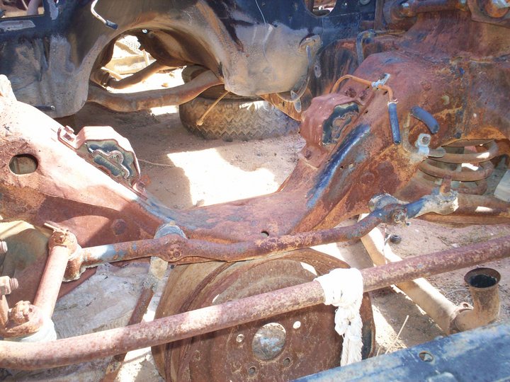

  26. Here is the style mounts for 1975-1981 Firebirds with Pontiac V-8 engines.
    Starting in 1975, the mount style was changed to what is known as a 'corporate' style mount. This made it easier for those on the assembly line to fit engines from different divisions into different chassis.
    The rubber portion was moved to the chassis and the engine itself used a simple stamped steel bracket.
