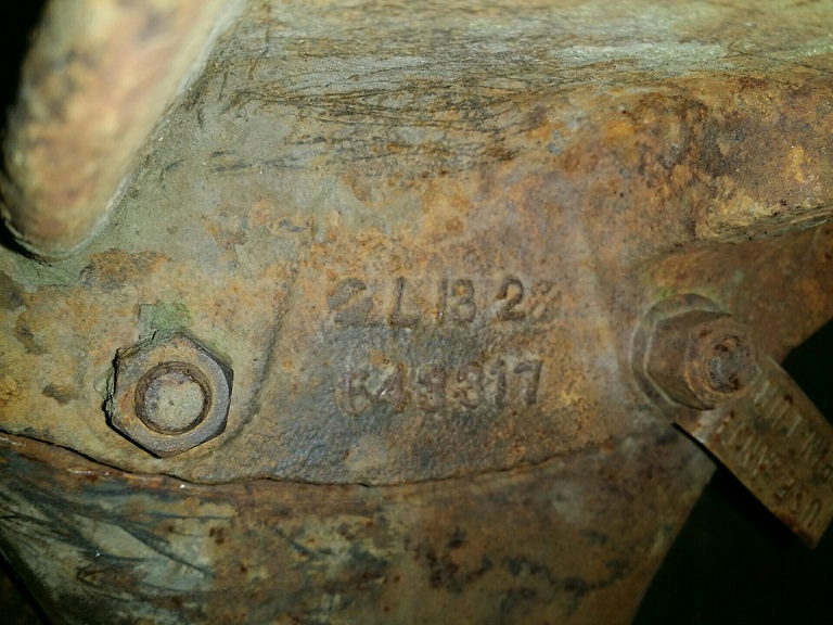

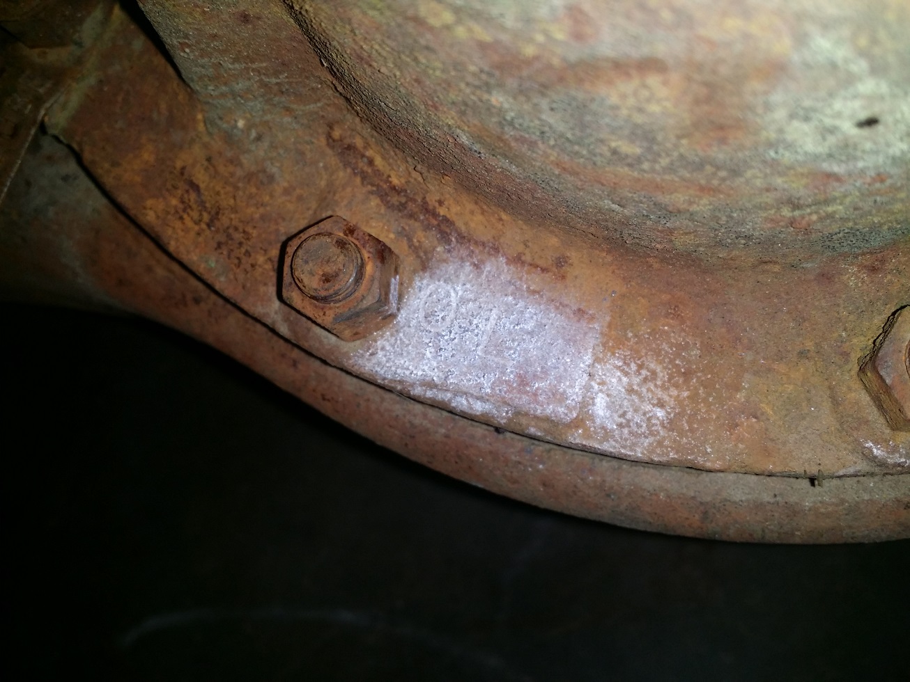

    picked this one up locally the other day
    haven't opened it up yet but the story was it came out of a '63 Pontiac Station Wagon
    (low mile wreck)
    seems good from the outside..
    '62 date code, 3.08 limited slip..
    if it's a good one it'll go in my '58 housing and I'll likely order a pair of 31 spline Dutchman axles
    to go in an A Coupe

    Paul
    Story might be wrong.... If this was from a Pontiac why does it have a OLDS tag ANTI SPIN is Oldsmobile term for LSD
    Pontiac tag will say Safety track.
    Just pointing out clues for the rest to ponder... A LSD find ifs a good find NO MATTER what the story is. :)

    hmm, interesting, so you think it's a '62 Olds rear not a '63 Pontiac?..
    as long as it's in decent shape I'm happy, I haven't opened it up yet..

    Date code sez it's '63 model year and casting number is '63-'64. Maybe someone cudn't tell the difference between a '63 Pontiac SW and a '63 Olds SW. Pull the drums off and look at the drive dogs in the center of the axle flange. If it has two drive dogs shaped like mushroom heads, it's an Olds. If it has four drive dogs shaped like a saw blade, it's a Pontiac. Both are 31 spline. Don't know for sure about the width, but if it is a Pontiac, it might be a little wider.

    I thought the L 13 2 was the date code making it a December 13th 1962 vintage?
    No?

    It gets a little crazy when you're trying to figure these dates. This was cast in Dec '62 and the new car models, i.e., '63, hit the showrooms in Sep '62 making it from a '63 vehicle.

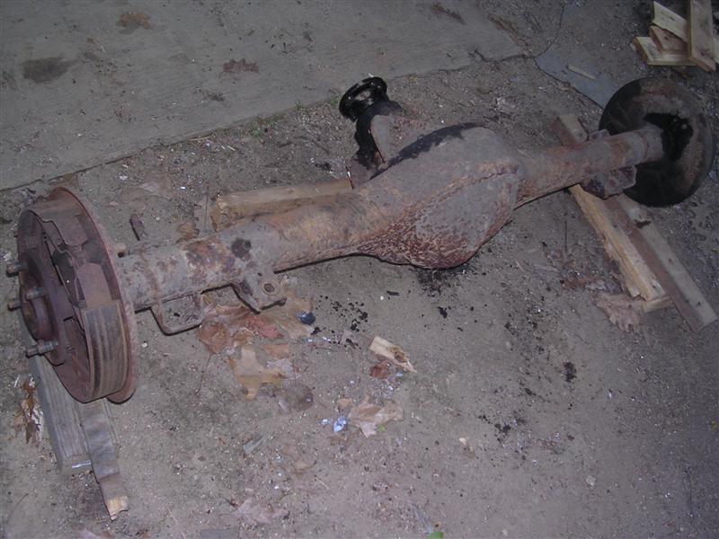

    DSCN0294 (Large) (Medium).JPG DSCN0293 (Large) (Medium).JPG DSCN0295 (Large) (Medium).JPG I find it interesting to see where some GM parts were first designed..
    I am working for an estate to get cars fixed for resale, and this 34 LaS coupe had wrong wheels, and the correct wheels were 5.5" bolt circle. The car was converted in the 1960s to 5" bolt pattern.
    Found a 34-36 LaS rear end in the barns, to see if they maybe just changed drums. Nope, the car looks like it has a mid 50s Olds rear in it now.
    Looking at the 34-36 LaS rear end on the chain, it really is very close to an early Olds rear. Even the driveshaft yoke looks the same. The big difference is the LaS has removable hubs with a center nut, and pinion shaft support bolts.

    I took the "Olds" rear end out of the 34 LaS, and going by the casting number and date codes on this thread, it is July 22 1954. I think it must be Olds, not Pontiac, as all the brackets match the 55 and a 56 Olds rears I have here. (note, it has a homemade driveshaft adapter on the yoke)
    Question: I've double checked the ratio to be 3.08. I thought the stock Hydramatic was 3.23 and standard shift was 3.42? Is the 3.08 an uncommon ratio for mid 50s Olds? It seems a very low number for the mid 50s?

    It is not common. I think it was only available in the later years (54-55-56) I searched for about 2 and a half years until I finally found that ratio via another HAMBer. I bought the whole drop out from him and put it in the car. I love it for driving on the highway around here. The car will run 70 mph all day and the big torque of the Olds loves the tall ratio. I have the original 3.42 drop out if anyone needs one. Good shape. Just not needed. PM me if interested.
