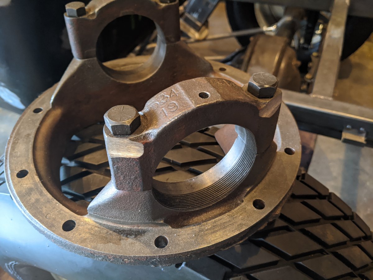

    I know this is an old thread, but need a little information. Was fitting a 62 third member with posi into an unknown year axel housing. Bolt pattern is correct but will not let me set the third member flush PA180156.JPG PA180157.JPG PA180158.JPG to the housing. Earlier in this thread it was posted a 58 housing needed some modification to fit the later year third member. Does any one know exactly what need to be done? Seems the bearing caps hit locating flats in the rear of the housing. I don't think the third member needs any support back there. Any help will be appreciated.

    Not sure what the problem is, but the ring gear extends well beyond the bearing caps. Measure the depth of the bearing cap from the gasket surface ,then measure from the face of the housing to the back of the axle tube. These are pictures of the 57 housing I have in my 57 Corvette. Hope this helps. 2017-01-13 15.14.37.jpg 2017-01-13 15.14.28.jpg 20180427_121032.jpg

    Yup, need to grind a bit off the cap.
    Also may need a bit off at the housing flange

    You can see here where I ground the caps in my spare carrier.
    This one I cut for use in housing straightening.
    This may be more than you need to grind yours, I wouldn't take any more off than absolutely necessary.

    Thanks Paul, grinding those four little tabs about .120 cleared the third member. But your way will do the trick also...Thanks to all these great Hamb boarder.....

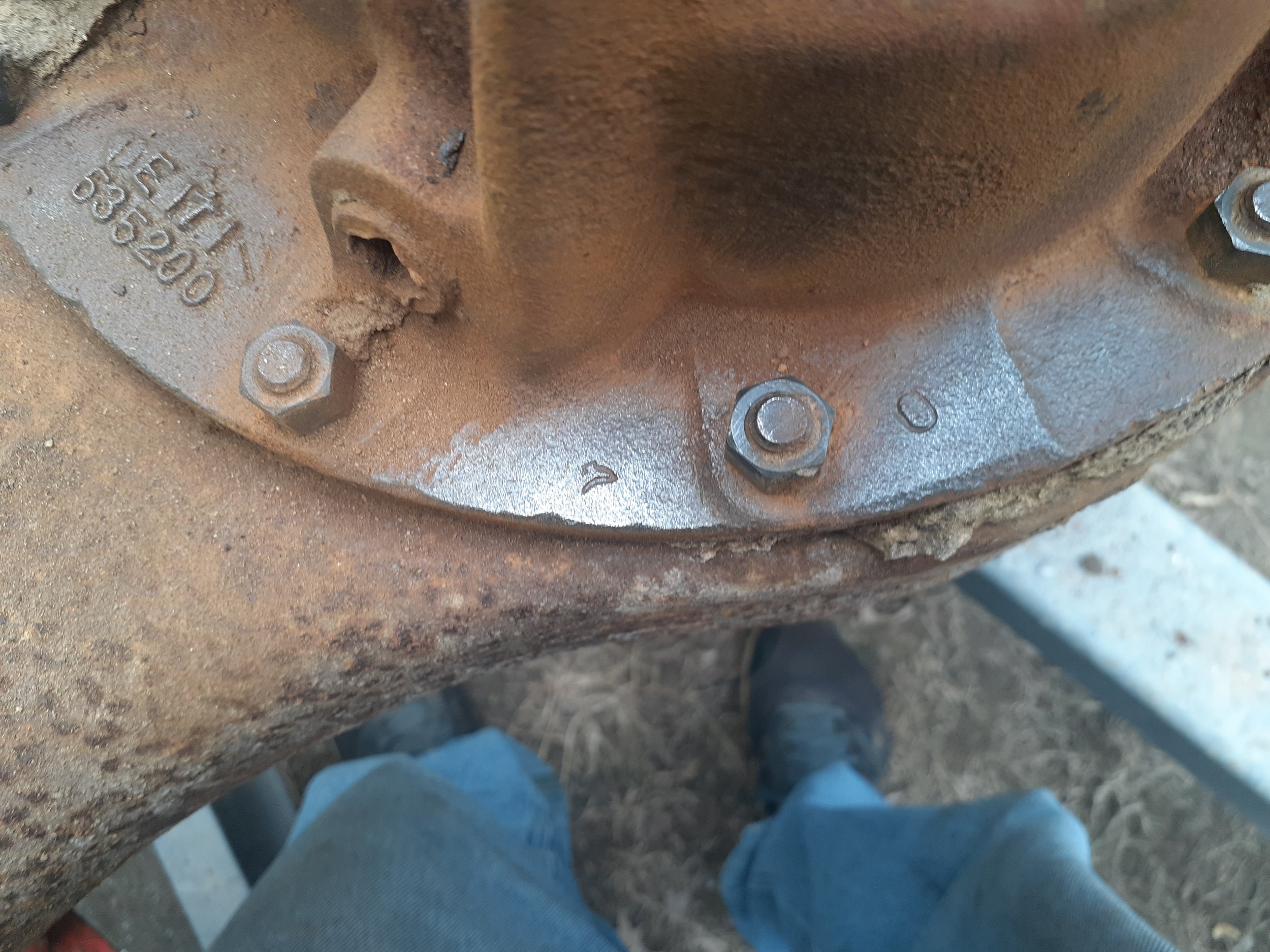

  21. Here is a picture of my 61 Oldsmobile rear end I understand the casting and build date and the 0 means 3.08 ratio what is the other marking between them looks like a 3 or a 7 or who knows what. Thank you Jim
