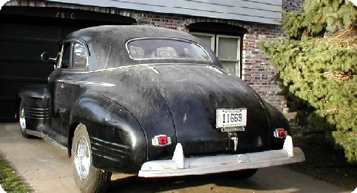

    I found a way around buying the expensive aftermarket axles when using a 31 spline carrier in a 57-58 housing. Bought a pair of '61 Pontiac axle shafts [61-62s were the shortest 31 spline shafts] and had a buddy run the splines further up the axles...cut the ends off and viola!
    My buddy said he never wanted to do that job again. Cutting splines in the tapered shafts was a chore and as such he had to turn them down a little to cut the splines.
    Now, in all fairness, I never ***embled the rear end as the entire project was sold off before ***embly to finance a house project. Can think of no reason why it wouldn't work ok.
    Also, 56 and earlier third members will fit any 37-56 Pontiac housing. I put a 56 thirdmember in my original 41 pontiac coupe to get the road-friendly 3.23 gears. Also used a 56 thrid member in my 48 Pontiac for the same reason.worked just fine. The only change was to use one longer mounting bolt as the earlier carrier housings were a little different thickness at the one mounting bolt..a nuthin deal.
    I always use loc-***e on the Pontiac pinion nuts as they are known to work loose..happenned to me, a buddy and I see it's happened to several people here too.
    The 56 ONLY pinion flange will work on the earlier third members to give a common U-bolt-style universal joint. The 55 and earlier all used the farm-implement style "mechanics" u-joint which surprisingly is super easy and cheap to buy at an implement dealer...I found out while driving through Sprigfield Ohio...
