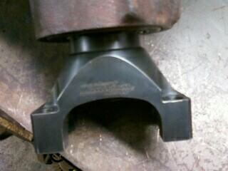

    Hey So I have a 50 olds 88 i put a sbc with a turbo 400 ****** and I have been running the stock rear end. Recently i blew through 2 u joints and now the rear end has flared where the u joint mounts up, and I am wondering if there is a place to buy the part new? i think my original dummy neutral drop slightly flared it and now its giving me trouble. Another option is a chevy rear end. thoughts or ideas welcome! thanks guys.
    Teufelhund

    call Brad at fabcraft he has all the stuff you need for olds rears, he sells new yokes also. heres mine all new parts and yoke from Brad:

    Yeah, Pretty much a bullet proof combo!
