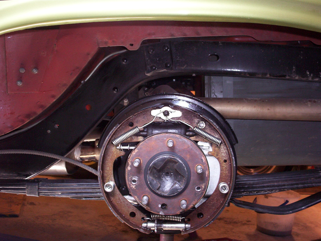

    1957 is last year for leaf springs and the are bolt on chevy 55-57.it is the most disired rearend .french lake in minesota have several and the ship .
    here in sweden i cant find any.i did buy one of a hamb member in texas.i payed 600dollar and shipped with my cars to sweden.
    picture is from my safari 1957
  17. You're half right.... I wasn't asking about a Pontiac rear end. OLDS had leaf spring rear ends up until 1960. The 1957-1958 non posi rear ends is what I'm asking about. 57-58 Olds were the same widths as each other and I believe they bolt under 55-57 Chevys as well. 59-60 the Olds rear ends got wider. Someone can correct me if I'm wrong.

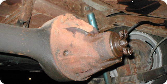

    The rear end in my '56 Olds seems to leak.
    First I thought it was oil from the rear main (engine) leak, but now that I've looked closer it looks to be the rear.
    Is there a common issue on these rears?
    Can I just change the gasket of the third member and that should take care or it?
    Sorry if those seem like stupid questions, I've never really messed with rears...
  24. KoolKat-57
    Joined: Feb 22, 2010
    Posts: 3,092
    KoolKat-57
    from Dublin, OH
    I would tend to think it is the pinion seal.
    If you have never replaced one, I would pay someone who knows how to do it properly.
