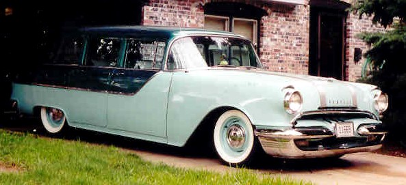

  7. All springs will get surface rust..it won't hurt them. I've had a slug of old Pontiacs and never had spring issues except for a broken center bolt or 2. When I was a kid we broke a main leaf in our 46 Pontiac coupe.
    I'd disassemble the rear springs and clean and inspect them. If the 2nd leaf has worn a deep groove into the main leaf, a new main leaf can be made by a competent spring shop. Paint, lube and reassemble with new center bolts and shackle bushings.
    Unless the fronts are broken, collapsed, they should be reusable. Clean, paint and lop off a loop to get it lower.
    These are a few of mine with cut coils [55 wagon needed 3 full loops removed...had a light 301 Pontiac motor] All others had cut coils [1-2 coils] and lowering blocks. 55WAGON.jpg rockys48pontiacatsleds.jpg 41atsaltaccessroad.jpg
