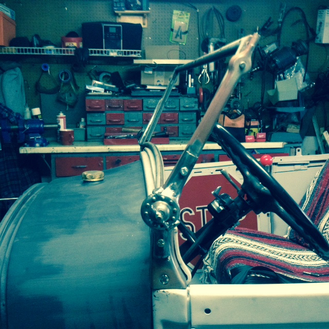

    Got any detail shots of how you did those windshield stanchions?

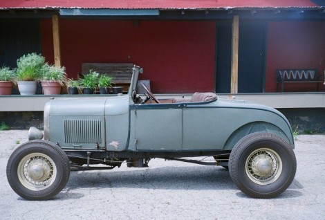

    And here is a color.

    heren are pics of the w/s stanchions----used Model T windshield pivots---cut orginal stanchions at the pivot lines had to weld limit stops for up and down position
