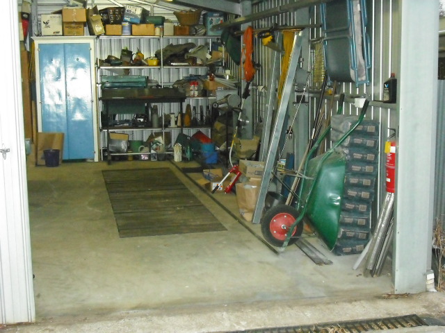

  9. This is mine...I built it in 20 years ago + when I built the shed. Only thing now is I very rarely use it and I think now down under here in Australia we are really not allowed to have/use them anymore but I still do from time to time. Not allowed to have any electrical permanently wired as well so I run cables etc from existing power points. The reason being is any fumes from fuel/exhaust can form a layer in there and hang around causing major problems in case of sparks etc.
    Mtw fdu.
