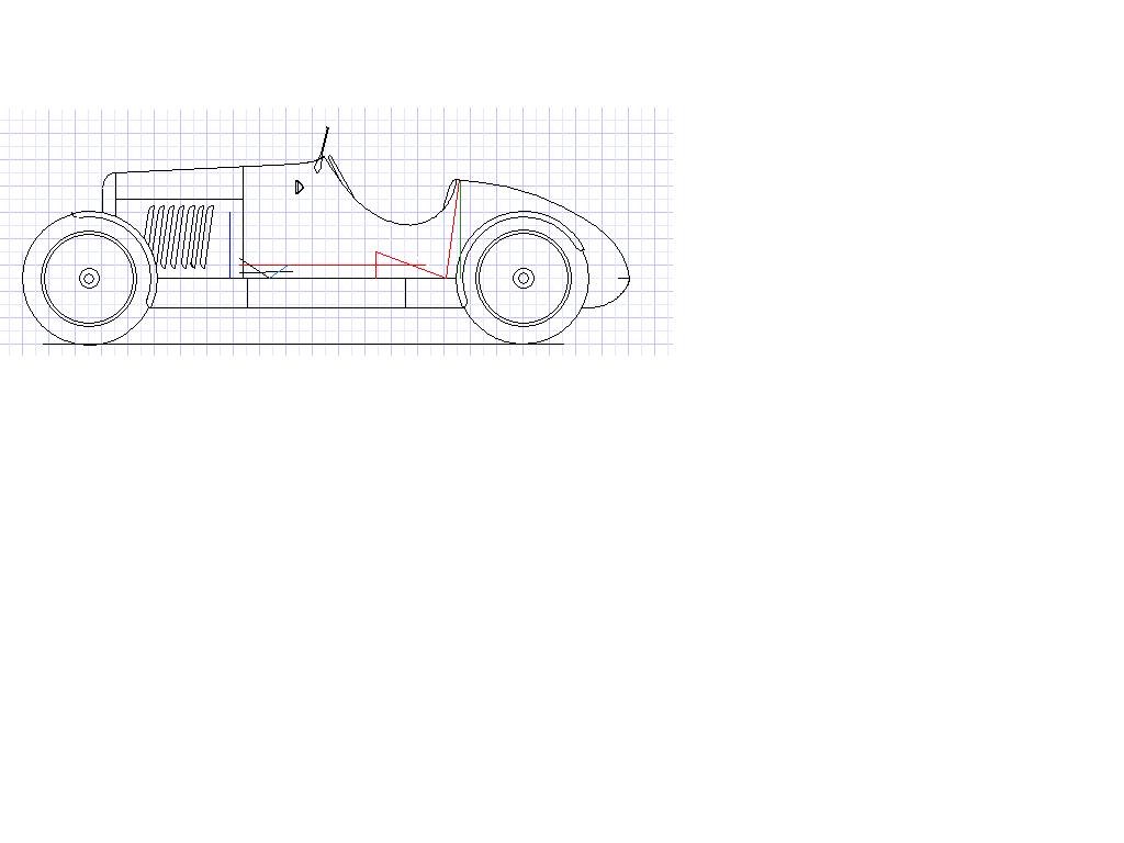

  1. says the bmp is WAY too big... still learning:rolleyes:
  2. Alright- one more time...

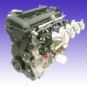

    hi guys ,hi Dave thank you for resizing pics,hi Mac it's alitle different but I like the engeneering that went into it,2 blocks cut and welded ,cam boxes are basicly layered milled aluminum,I could have built a nice car for the $ that was invested.... BC

    Why dont you use the Cosworth engine out of the Sierra or ****** Cosworth?
    These are twin overhead cam can be mated to a T5 box (the Sierra is RWD the ****** four wheel drive) can be easily tuned to 500hp+ or a more reliable 350hp and are as tough as old boots.
    That would then give you your FrontyFord look (twin cam) you are after. Only down side is a turbo with EFI so if you want to go carbs you would have to sort out the compression ratio.
    I ran one in a Mk1 ****** and it was completely mental!
