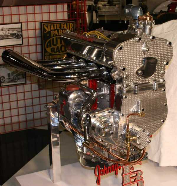

    Mac, I will try to get this thread back where it belongs (sorry to the Falcon afficianados). 1920 Frontenacs (or Monroes as some were named to bring in the $) were really somewhat unique racing cars. They also were the first American purposefully built racing cars to win at Indy. Louis Chevrolet was quite an innovator although many give much of the credit to Planche and Van Ranst. Here is a recent photo from the Indy Museum with a 1920 Frontenac engine (Monroe), the one that allegedly won at Indy in 1920 (Gaston Chevrolet). The bodywork on the 1920 and 1921 cars were almost identical. The #8 car is the 1921 Frontenac that Mulford drove at Indy in 1921. This car had an eight cylinder OHC that was identical to the winning 8 cylinder Frontenac. Louis Chevrolet was the first to win back to back at Indianapolis. Great cars that have not survived save for a few 1920 4 cylinder engines (I believe and hope that I am wrong).-Jim

    Gerald, Years ago I corresponded with Ed Roy who restored the Frontenac motor for Indy, the one pictured in the above post. He sent me some stuff on Frontenac but I have not run across it in years. I will have to do some digging to see what I can find. Admittedly though I am in the middle of a thrash to get my car back on the road so I can enjoy the cruise-in season. I may have a photograph/drawing of the actual Frontenac engines but I am not sure of the Ford based engines. He may have copied some of the valve gear off of his 3 liter 4cyl DOHC (1920) or the eight 1921 version, both Indy winners, but that would be a guess. Right after that he started on his Ford based conversions and I know he had been relying on Planche. His 1920 and 1921 valve gear worked pretty well so he may tried to adapt. I will take a look-Jim

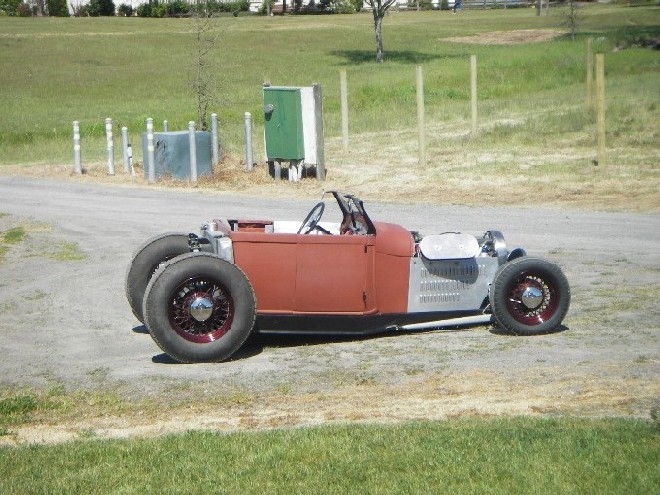

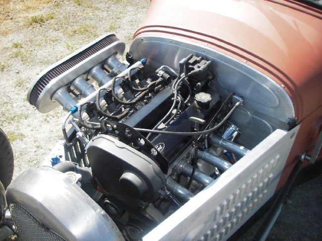

    I have just put my 28 RPU on the road. It has a 2 liter Zetec from a 2000 Ford ****** ZX2. It was standard trans so I got the clutch and flywheel, Quad4 Rods out of Denver has a bellhousing that I used to adapt a T5 ******. I made my headers to go under the engine and run out the p***engers side. I used Hilborn electronic injection. I have attached a couple of pics.

  13. Rex,
    Looks great! And like I said in the other thread- had I known that the newer Zetecs have the exhaust on the p***enger side, I probably would have held out for one.
    However, this is not the case (and finding a complete '97 Achieva on Espay for $180 didn't hurt, either:D).

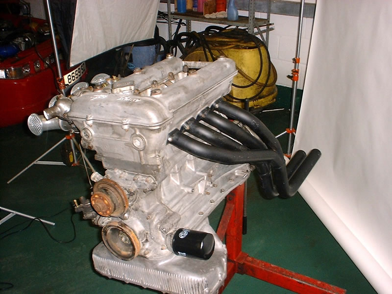

    found an older Alfa Romeo
    this would make a sweet hot rod motor
  15. Paul,
    If I understand it correctly, that Alfa engine is acutally two 4 cylinder blocks bolted together- check out the seam that runs square around the middle of the engine (wish I could remember the name of that Alfa, but it's the end of the school year and my brain is fried from doing grades, inventory, etc:D)

    Speaking of Alfa how about the all aluminum twin cam four? Sure the exhaust is on the driver side, but they imported lots of these into the U.S. the 1970s/80s in the Alfa Spider. Pre 1987 is best for the cl***ic Alfa DOHC - after that they kinda got too modern looking. ****a Injection is junk but Euro DCOE Weber manifolds are readily available and there are Weber DCOE type EFI throttle bodies available. 5 speed trans is typical Italian - crunchy when cold and week second gear ratios. Rear live axle is *****in looking with aluminum diff and discs - looks kinda like a Bennett or Turco from a 1930s midget. You can pick up a whole car for cheap as they rust like all Italian cars of that era. Engine weighs 280 lbs fully dressed.

    While rumaging thru my "future build book" last night - a 4-banger / lowboy eco closed cab pickup, , I found that article I saved on the Alfa DOHC powered track roadster. If you have the October 99 Street Rodder lying about, look for the article on the black buggy owned (then) by James Stroupe of San Anselmo, CA. The car was build by Brizio. This car had a great frame and was a very nice build
    That is the article I mentioned elsewhere on the HAMB, because NOWHERE in those pages does it tell you the motor is an Alfa. As you might have figured out, I'm an old Alfa owner / fan, so I knew what the motor was. When I emailed SR about it back then, they didn't want anyone to know it was one of them "furrin" motors. The Offy looks a LOT like an Alfa - which preceeded it.
    While I don't know if an Alfa will be in my eco rod or not, if I can pull it off it just might. These little babbies will run 8K all day long, sound just wonderful and are all aluminum. I had a 1300cc GT junior back in 1970. It had perfect hemi-heads, valves at 45 degrees, a center plug (two on the GTA), sodium cooled valves, cross-flow heads as slick as a whistle and two side draft DCOEs. That big fined aluminum sump holds 7 quarats of oil, too!!! The matching clutch and 5-speed is a wonder to work. The diffs are pretty cool, too. Reportedly one of the best handling live axle cars ever built, with GM style trailing arms and coil springs. And you haven't lived until you have seen an Alfa sliding block rear end (works like a Watts link). If you are a REAL Alfa fan, you will get yourself a 1600 or larger GTA or GTAM spec motor... about 225+ hp in factory. Perhaps someone knows of a SCCA production racer with a spare? Or who builds them for the road racers?

    Weasel, are those Alfa rears posi? Are there parts available to make them positraction? What's the height, width and length of the engine and how much power/mileage can be expected from a mild tune up?

    8k all day long - I don't think so. I have had nine twin cam Alfas. Red line is 5700 rpm for the 1750 and 2 litre and 6200 for the 1600, but other than that you're pretty much spot on except as I said earlier - weak 2nd gear synchros and do not attempt shifting into second until trans fluid is completely warm.
    Limited Slip Diff was an option on 1750 and 2000 models - about 25% slip factor as I recall - which I don't do too well nowadays. GTAM and GTA 8 plug heads mucho $$$$$$. Later twin spark version of the DOHC is a cheaper option but I personally don't like the look of it as much. Plenty of books on tuning these lil darlin's - search Amazon or evilBay. 1300cc engine was rated at 83 hp!!! A real firecracker that one. 1600 were around 103-105 hp, 1750 113-115 and 2 litre 131 hp. 1750s are generally rated as the best of the breed by Alfisti. Personally I think these engines are glorious, as are several other Italian engines. They make great hot rod engines.
    I'll go measure one and post dimensions in a few minutes.
