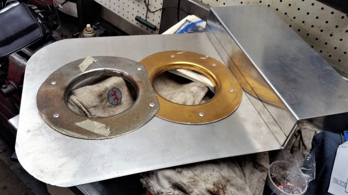

    I got a chance to get started on my cowl induction for my 62 Bel Air.
    One good thing there is one less gold Moroso air breather one the road.
    I have one question.Was wondering if it makes any difference on the shape of the pan as in being square corner or would round be better? 20150907_150027.jpg 20150907_150243.jpg 20150907_154340.jpg

    That'll work. looks good! Do you have enough distributor/plug wire clearance?

    Is this going with a cowl hood or flat?
    Plan for low areas in your bottom pan to allow water a path, instead of into your carbs.
    You can also cut open the firewall on the passenger side and duct air from the cowl into your "plenum" if using a flat hood. 57 vette used this on an off road package.

    Yes nothing is touching there.
    I have been trying to figure out how to make adjustable height for adding carb spacers for more to play so to speak.

    That's a pretty tall order. Considering that the pans are relatively easy to make, I think I would just make two pans. get what you are saying though, you may want to experiment with spacer combinations of differing heights, and for any a-b-a track testing to be meaningful, all combos would have to be run with trays. I just cant see a simple way to make an adjustable tray with your set-up.
    How much space do you have between the front carb and the hood with the hood jacked up? If you only have space for a 1" spacer, then I would just make a second pan with a 1" shorter step at the back.

    can you figure out a way to make a tray where you could make up the difference with different height foam seals, rather than the tray itself?

    That was the way I was leaning. Maybe make the rear part attach to the car then the pan can move up or down with less Hill Billy engineering.

    You could put a sheet metal/cardboard/whatever china wall around the perimeter of the tray. Maybe 2-4 inches tall. Then sticky some tall foam on the underside of the hood. Give them a good over lap so that the foam is on the inside of the tray walls no matter how high you adjust the rear of the hood. Once you've tested and found the height that works, finalize to your liking.-rick

    There's an idea didn't think about putting the foam on the hood.
