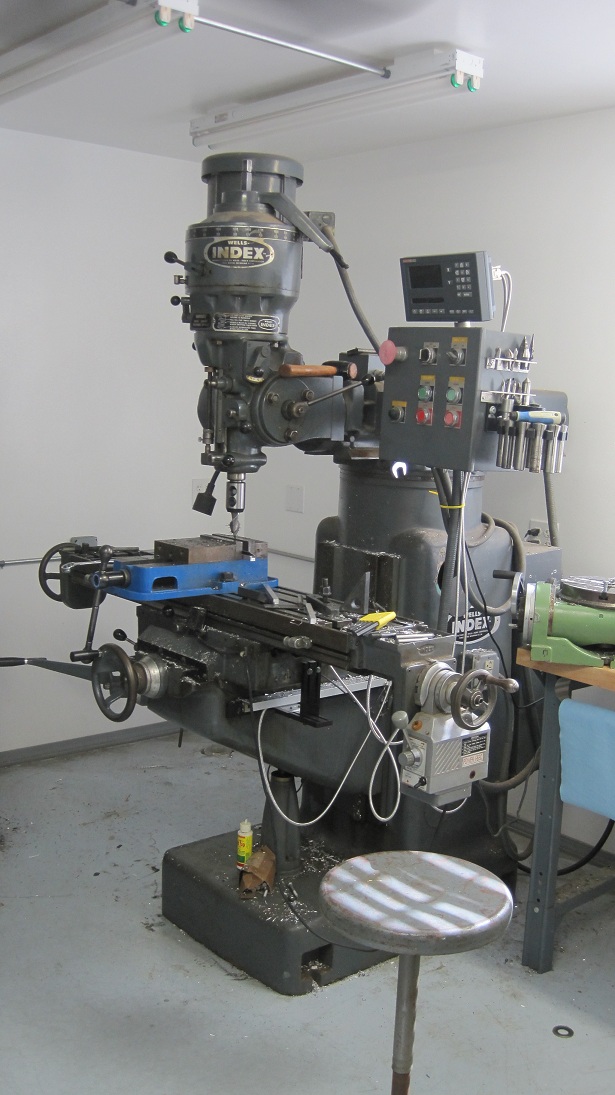

    The best 'secret' is to buy a Wells Index mill. Stronger than a Bridgeport, better built, and usually less money. Made in someplace that apparently (?) used to be a manufacturing powerhouse - the USA.
